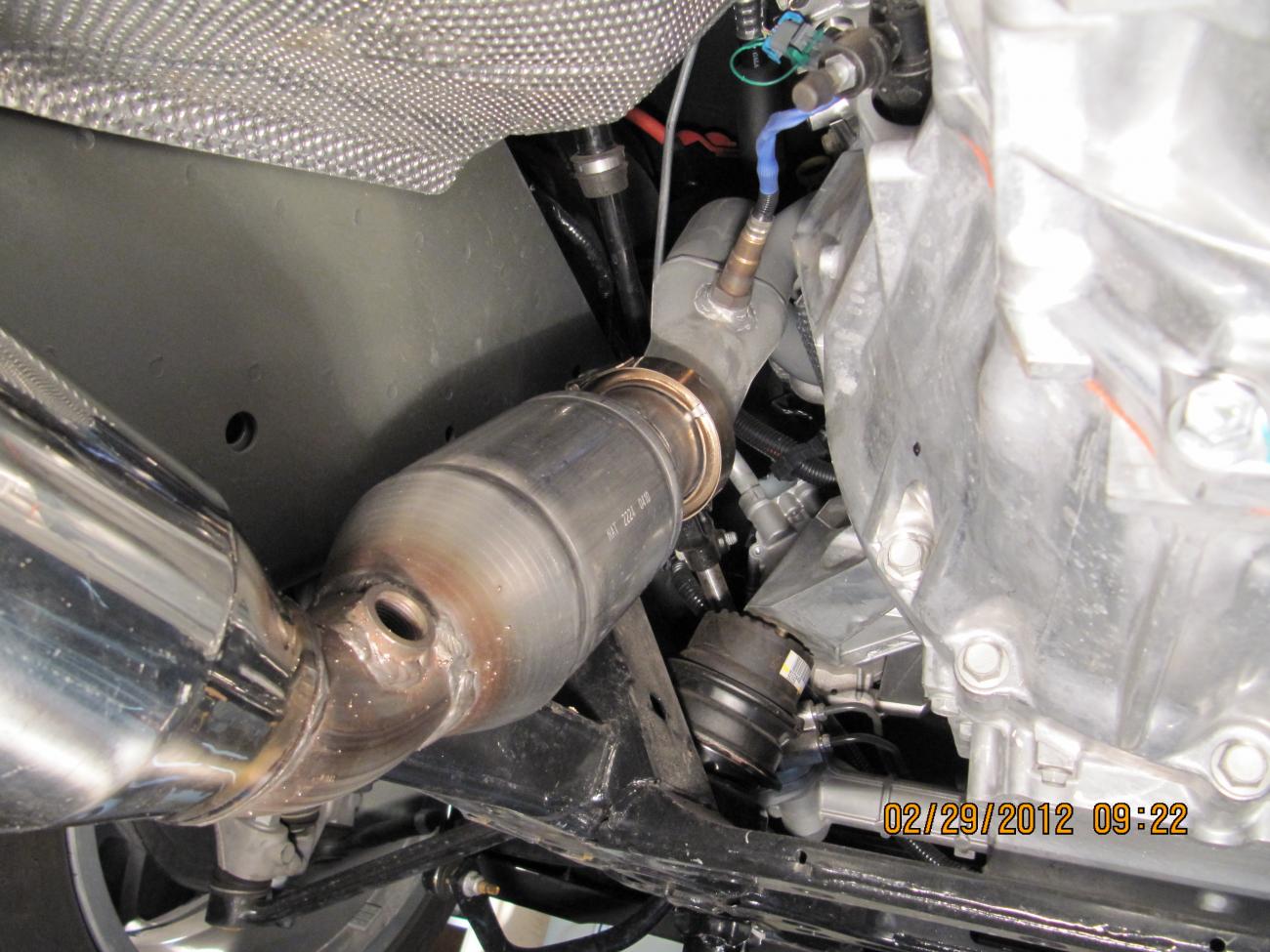

Lookin good. I would like to see a pic of where they connect to the JBA's.

The mid-pipes w/cats connect here in the first pic. Jba's "Firecone" is where the 1st O2 sensor sits in the second pic:

Just wanted to post one more time to show the JBA/Solo combo in (near) finished condition- these are tack welded in place, so I still have to take'em down one time for finished welding, but this is how they'll look.
I need to get a couple more washers for a little more clearance at the chasis brace...
