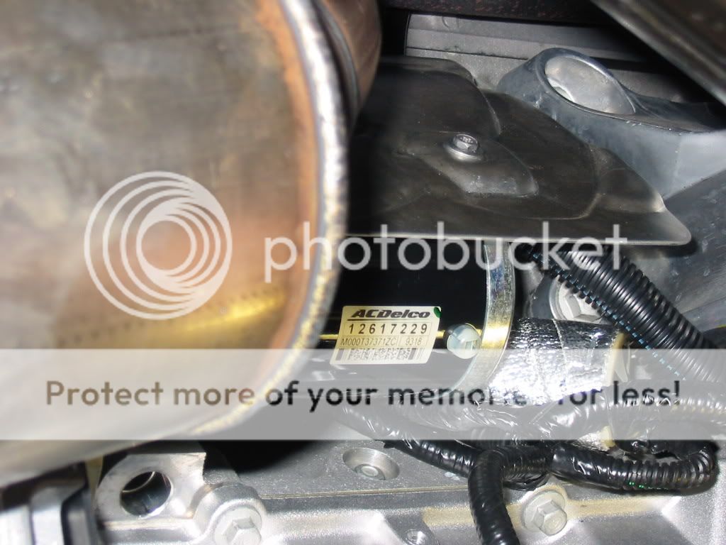

I can see a long black wire coming from the back of the car that disappears behind the starter but then reappears beside the starter in what seems like a very small passage between the starter and the engine block. This would seem a logical site since routing it on the other side of the starter would put it closer to the exhaust. It will be interesting to see where the dealer places the new cable (presumably if in the same place then it can be assumed that it was the cable at fault and not an improper location). It would be nice to get a pic of the damaged cable to see if the damage was compatible with an inherent cable/insulation defect or an external pinch or crush that corresponds to the tight spot. A car that unexpectedly stops suddenly is very dangerous...wonder if the V6 cable would be routed similarly...

Originally Posted by Caliman93230 View Post
Nonetheless it seams the wires where touching the started got burnt and thus caused the car to shut down.
Wires touching a starter will not get burnt, there's no current flow through the wire's insulation. Wore through the insulation because of touching? No, at the length of that run, it should be a minimum of 4 gauge cable, and that heavy insulation would not wear through that quickly, even considering the train/truck ride. This was an already damaged cable, a pinched cable, or heat damage. Hopefully we find out.

Sure
wow a camaro in Hanford, to bad my first time seeing it was in the shop, however I had the opportunity to meet Bumleb and her family, awesome people.
I will post some pictures as soon as Bumleb sees this post and gives me permission to do so.
for example in this pic.
Caliman, please post. The pic's I have are all fuzzy. But the example you put it exactly it....

Posts: 41
Shielding got hot and melted
They repaired the cable for vehicle moving purposes, of course waiting for a new cable, but yes, that cable. The friction between the cable shielding and the starter, mixed with heat, did it.

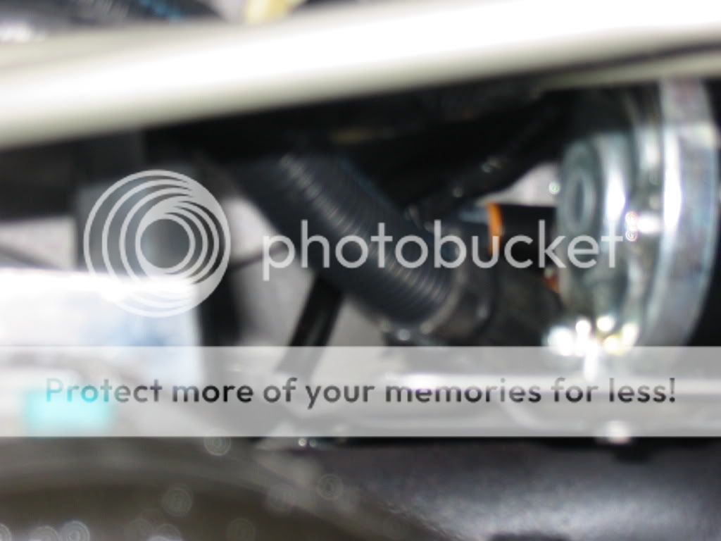

OK some of the pictures are kinda blurry nonetheless one can tell that the wires where taped so there must have been some damage to them.

Posts: 169
I'm sure someone will correct me if I'm wrong, but if the wire was taped before the damamage, is it possible someone spliced the wire then taped it? I've done simular on our 77 CJ5. But that's a hunting Jeep!

Posts: 41
Here is a pic I have
The material is over the burnt part. The service dept repaired it so that they could move the vehicle. A new cable is on order and I hope for reinforcement even after the cable is replaced.

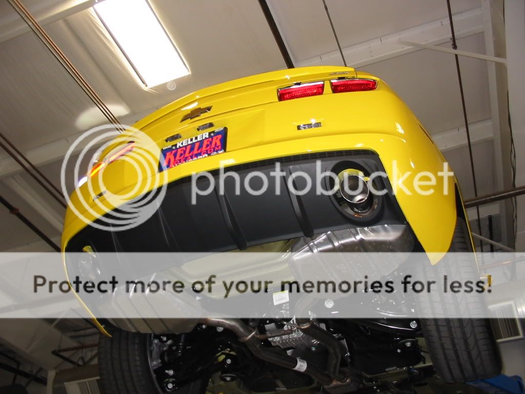

Bumleb's backend
Not a view I hope to see very ofter. But sure is pretty.....!
Owner: 2010 Chevrolet Camaro 2SS Rally Yellow with Custom Black Racing Stripes
Bumleb is offline   Reply With Quote
Old 04-28-2009, 11:02 PM   #98
BackinBlackSS/RS
Go Blue!!!!!
BackinBlackSS/RS's Avatar
Drives: 2012 Cruze LT
Location: Indiana
Posts: 23,290
You got that right. I tell ya though. I was under mine today checking it out and those mufflers almost look like dual gas tanks. They are huge.
