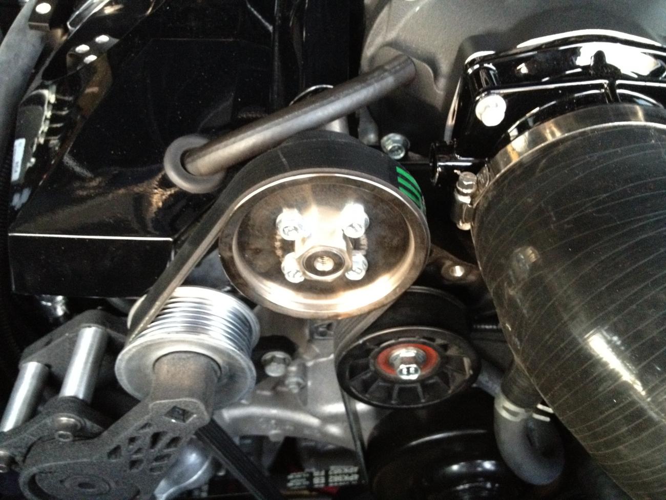

When I put mine on I pulled the idler pulley hard, just not with a pry bar. My belt is smaller so might not allow for the idler to come that close to the tensioner. A smaller belt is going to be tighter and not allow the two pulleys to be pulled that close together.
You're correct. I'm not sure what size belts you boys need. The OD balancer makes mine bigger.. But I use the same belt on a 3.4 and the 3.2.

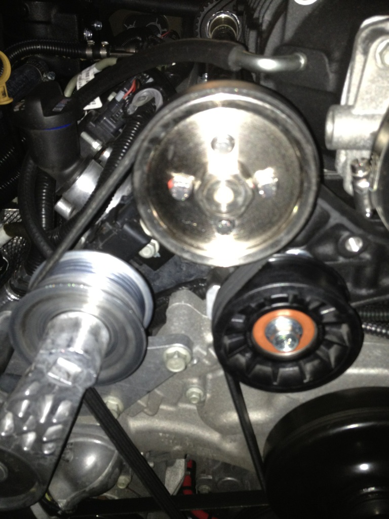

Posts: 1,961
SS, I'm having no luck moving this pulley over. Tried a skinny screwdriver, not budging...How much do I need to loosen the idler bolt?
Here's what I'm suck with until Thursday then it going to get this problem fixed if I can't and a tune. Can I drive it like this? Should I expect anything? I can't believe I can't get the pulley over, figures I have a painted & ported TB so trying no to scratch that as well.
Dude.
If your belt is too small you won't be able to get it over any more. If you're prying and tightening then that's it. Leave it there or get a size bigger belt.
Ok. Loosen the idler bolt until the pulley pops to the right. Then it's loose enough. I would call Ted tomorrow, between 8-12, and check the bent size. Like PQ said, if the bent is short that may be it. You can drive like that. Worse case it would slip but on the street it'll be fine.

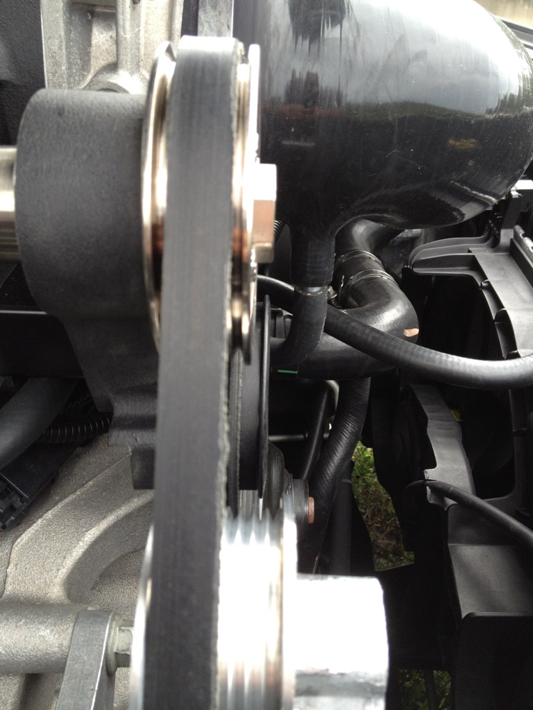

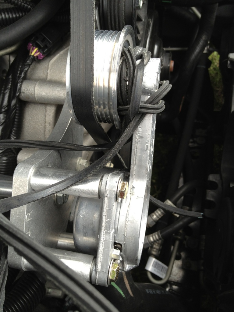

Posts: 1,415
Now that I'm seeing the pulley location, it looks miles apart. Nothing like yours. That could also be influenced by the belt now being half it's intended size due to shredding.
One of the photos shows how it looked when I pulled over to check that funny sound coming from the hood. Another shows what's left of the belt.
Nice job on that belt!! Damn!! I'd call Ted and double check that belt number. If is indeed correct then the pulleys need to be closer. If the belts to small you may be maxed. If that's the case move up a belt size and tighten up that gap.
