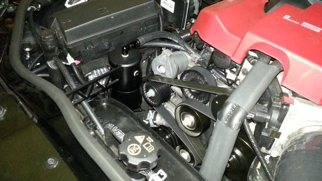

jeffrop
jeffrop's Avatar
Drives: 2020 ZL-1 M6
Join Date: May 2013
Location: Northeast Ohio
Posts: 48
Installed
jeffrop is offline   Reply With Quote

Installed mine yesterday on my SS and have a question. The routing shows the PCV line going straight across the top of the engine to the catch can. The picture in the online instructions show the engine cover off, so my assumption is that the hose will run under the engine cover rather than over it. Is that correct? If so, will the hose hold up OK to the engine temps?

That is correct. Under the cover and just over the throttle body on the L99. The hose is high temp fuel line. It will be fine.
