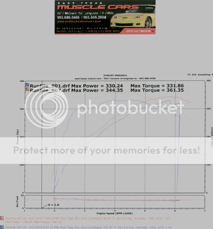

Here is a Roto-fab customer post from another thread. This is tuned, but check out the torque!
