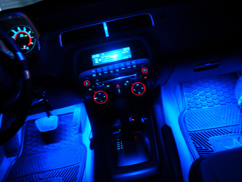

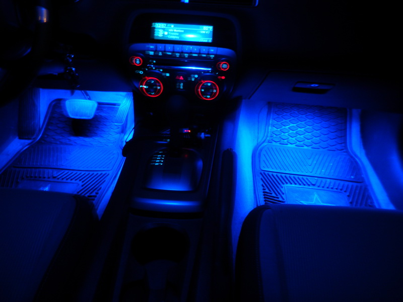

Screw it just went out at 1am and took some pics lol. Pics were taking with no flash. Not great pics but you all will get the idea. I am more then happy with it. Will post parts installed in a few.
P.S. being I was posting pics I had to slap in my new tattoo HAHA. Only 1day old so not healled up yet. As you can tell by the redness in it.

Here are the parts I used for my install and a little info.
I used two 10" Piranha Bars
http://www.oznium.com/piranha-bar
I also bought two Linear Light 3 foot extension cables.
https://www.oznium.com/linear-light-extension-cable
Also one t-tap.
I used the 3 foot extension cable to tie the two lights together. They plug into the ends. This was I would only have to use one hot and one ground. I took the other cable and plugged it into the end where I would be running to the dome wire. I didn't need 3 foot so I cut it in half. Ran the positive to the dome wire and grounded the other to the bolt to the right side of the gas peddle. I spliced in a Spade terminal connection. This way it would slide right behind the bolt and washer. The only think I would point out is the extension cable wire is on the thin side. Almost like a thinner speaker wire. It is to big if you fold it to put in t-tap. So what I did was stripped then end first. The I was able to fold the fire to make it about the same gauge as the dome wire. Hold this helps. If I can help others in anyway just ask.
2010 IBM 1LT out. 2013 BRM 1LS in. It's like having a blank canvas once again. Modding has started! Now on to a 2014......
