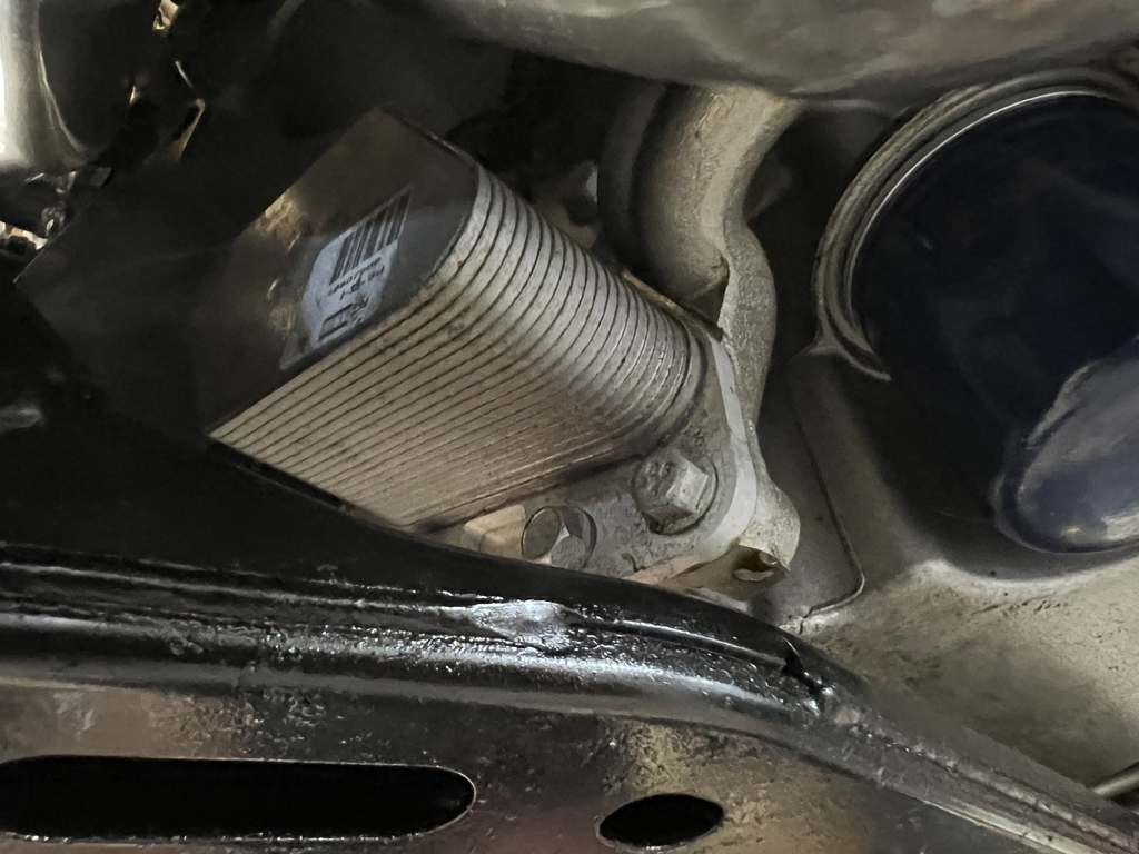

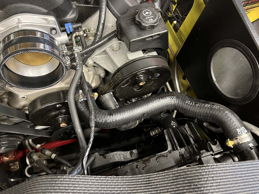

For probably the past 13 years of the 14+ owning the car, I have had the infamous oil cooler leak. It was never too bad…just a few drops on the garage floor here and there. Since I don’t drive a ton of miles each season, I only change the oil once a year and when I do, I’m always reminded by all the oil that is blown across the bottom of the block. Here's a picture of the mess I usually had to clean up with each oil change.

Last year, I set out to resolve the issue once and for all (thanks to the advice from other Camaro5 members), I opted to get the oil cooler delete kit from Improved Racing. The kit included the upper radiator hose from a 2012 Camaro, a 17mm allen plug for the block, and a bypass plate. So with this year's oil change, it was finally time to get rid of it.
Overall, it was pretty straightforward. But if I had to do it again, I would highly recommend draining the radiator first. I only drained the oil and the antifreeze made quite a mess. When I was finished, I had to put over 1.5 gallons of antifreeze back in.
I tried to remember to snap a few pictures along the way, or at least until my hands were too slimy with oil and antifreeze to want to grab my phone. Anyway, I started by removing the air intake to swap the upper radiator hoses. The 2010-11 hoses (first pic below) have a T in the line that goes down to the oil cooler, but the 2012's used a single hose (second pic below).

I would also recommend disconnecting the cooler lines before unbolting the oil cooler. I didn’t do that first, but ultimately had to in order to get the oil cooler out. The black covers will slide back to reveal a retaining clip. I didn’t get a picture of it, but there is another large line that goes up to the block. It also has a black cover/retaining clip to remove the line. Once that line is removed, you’ll be able to get a 35mm socket on it to remove the nut in the block. This will be plugged with the brass 17mm Allen plug from the kit.

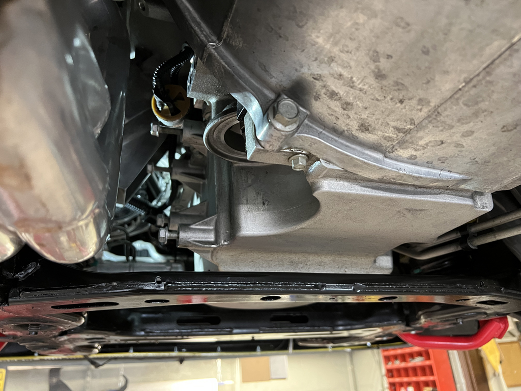

With the lines out of the way, its time to unbolt the oil cooler itself. I started with the two 10mm bolts above the oil filter where the bypass plate will go. Next, there are only four 13mm bolts around the oil cooler have to be removed (the ones that thread into the studs on the oil pan. Three of them were easy to get to, the one at the top took the right combination of swivels and extensions to get to it, thanks to the headers.
Name:  Oil Cooler Delete_6.jpg
With the oil cooler removed, I installed the bypass plate and the new oil filter..wiping down and oil and antifreeze I could see. And here's the final result:

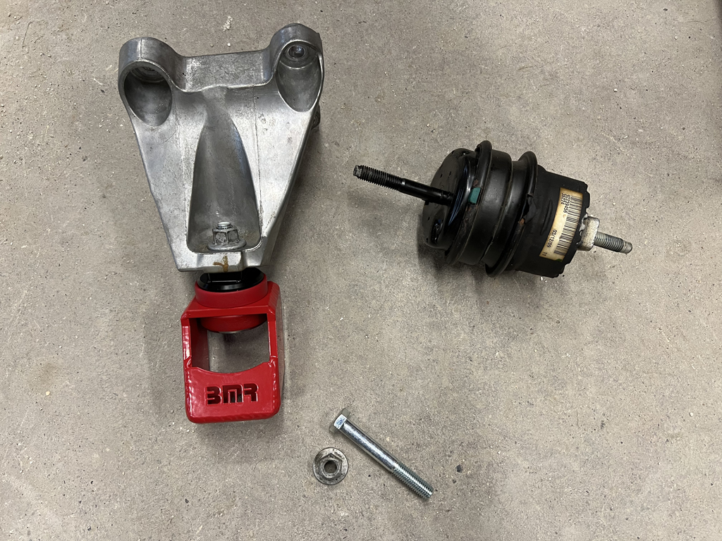

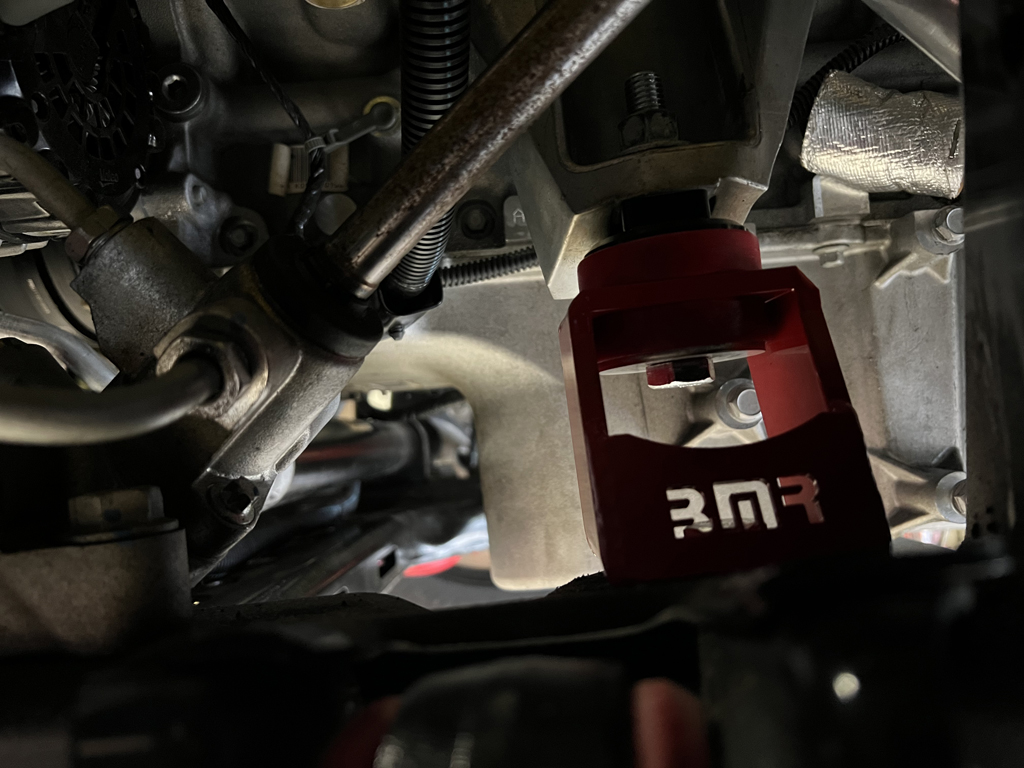

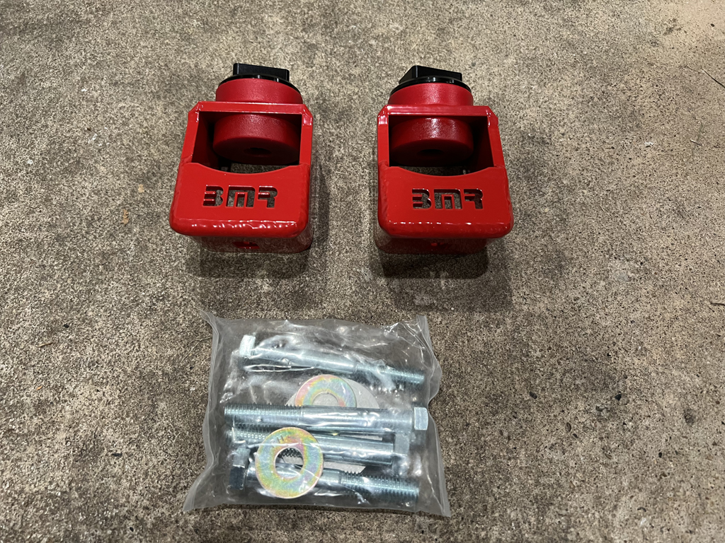

This job took me way longer than it should have, but I finished installing a new set of BMR motor mounts today. The reason it took so long is because the headers were blocking one of the bolts so I wasted a lot of time trying to find a short cut instead of just removing them. Where everything went completely downhill is when I was being stupid and unbolted the headers before disconnecting them from the rest of the exhaust system. The weight of the exhaust made it impossible to bolt the headers back on, and without the headers connected it was next to impossible to take apart the rest of the exhaust. I ended repositioning the headers enough to get one bolt in each one, and then with some heat, a large hammer, and a block of wood, got the exhaust from the cats back removed.
Of everything I have done to my car so far, I think this one is probably the most extreme. Granted, I need to get a couple hundred miles on them before they settle in, but that initial start-up and drive home felt like I was driving a completely different car. I could obviously always hear the car running, but now I can literally feel the rumble through the floorboards. It kind of reminds me of the old school big block muscle cars with no insulation under the carpet. Unfortunately, it was raining on and off and I got stuck behind way too many people driving like it was snowing. But I did get a short section of open road to wind out the gears a bit and everything felt very solid and incredibly responsive.
I’ll provide some additional feedback after they break in some more. Here are a couple pictures I took a long the way.

I understand the purpose of the solid mounts, but is the vibration you feel worth the change? NVH on a mostly street car drives me nuts especially in a modern car, my old school rides it's more tolerable and expected.

That's the million dollar question that the jury is still out on. I think the initial startup and drive was just more than what I was expecting. The exhaust drone - never bothered me, the NVH from all the new bushings - never really noticed it...this is the first mod that is right on that line of going a little too far. The mounts have polyurethane bushings so they will absorb some of the vibrations, I couldn't imagine going to a full solid (or even Delrin bushings) mount.
From what I can gather, people either love em or hate em, but I want to give them a little time before I make a decision. If its too much, I kept my original mounts, or I could even try to find a set of Z28 motor mounts.

Just a quick update on the motor mounts. I took the car out to a local show last night, and it already felt tamer after one day of sitting. I can still feel the car running, but the steering wheel isn’t vibrating any more and even though the rumble in the floor boards is still there, it isn’t as pronounced. I can hear/feel a slight vibration while pushing the clutch to come to stop and the R’s briefly drop below 1000. The same vibration also appears slightly louder right at 2500 RPM’s but it immediately goes away when the R’s go either up or down from there. If I had to describe it, I would say it feels like I’m driving over a rumble strip (but the smoother ones). I still have to get it up on the highway to see how it feels at higher/constant speeds, but the likely hood of me going back to the stock motor mounts is already starting to significantly drop.

So I have over 200 miles on the car since installing the motor mounts. I no longer feel the rumble in floor boards, nor the feel the “rumble strip” vibration when the R’s drop below 1000. The one around 2500 is still there, but I don’t think it is as pronounced.
However, one thing that is getting more apparent is the vibration of the car itself. What I initially thought was just a heat shield rattle appears to be more than that. I would describe it like I have my trunk packed with subwoofers and the bass cranked. I’m pretty sure it is probably a combination of my cam and exhaust being amplified by the motor mounts as it only happens while idling at a stop and immediately goes away once I begin to accelerate.
I started looking through old posts in the audio subforum, and think the loudest culprit is the rear deck. At one point, I found a video that someone posted on YouTube capturing the rear deck rattle…the only difference is he was blaring his music where I have my radio turned off. I think my winter project this year will be to rip out the rear interior and strategically lay some Dynamat.
Overall, I would say the motor mounts are in the + category, perhaps noted with an asterisk. The car certainly feels tighter and the throttle is more responsive than before…plus I love how the cam lope is more noticeable. The slight increase in NVH doesn’t really bother me, I just want to tamp down the rattles from the vibration.
