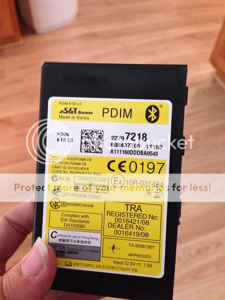

Okay I guess my car is just one of a kind!? I got the PDMI in today part #22797218
Brand new one too

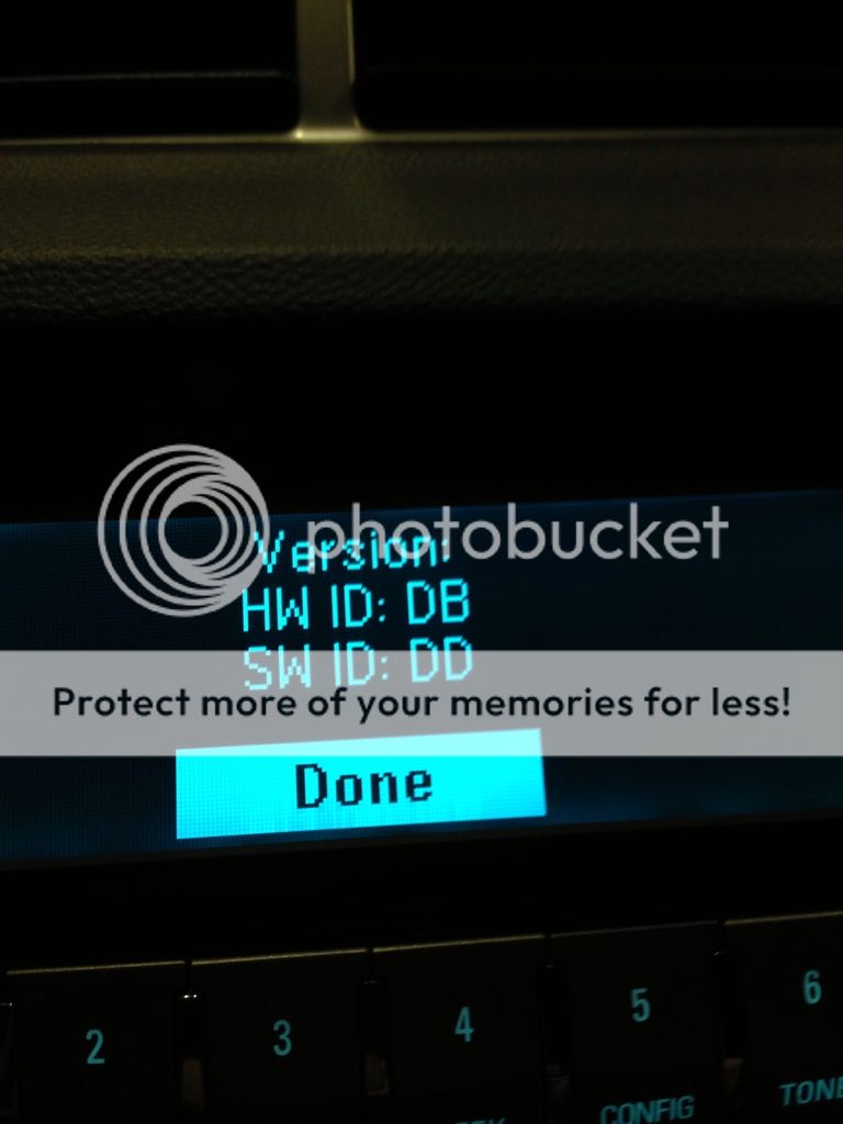

Got it installed and now have DB/DD version butttttt
Here's my issue it's still NOT working right! This is what it does notice the songs sound real garbled when I switch the songs and to make it stop I can unplug it and plug it back in.
http://i432.photobucket.com/albums/q...41D748A0A5.mp4
Now I guess I just wasted $85 for nothing? <sigh> :(

Originally Posted by terry_b View Post
I read through a ton of these but I really can't do 43 pages...
Dumb question - How do I make it display which version?
Terry, its easy......start your car or at least turn on the radio. You must have something plugged into the USB port, and have it selected.....then push in on the Select or Menu button and HOLD IT DOWN, for about 8 to 10 seconds and the display will change to display the Hardware and Software versions of your PDIM.
