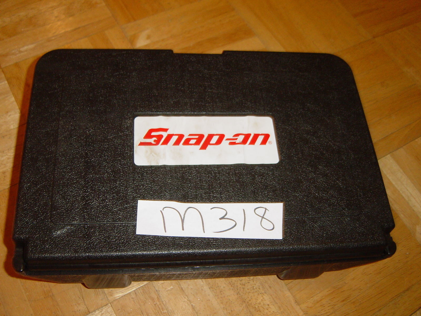

OK, today I pulled the bumper back off and resealed the fittings on the dual heat exchanges. In order to make certain this did the trick, I used this to vacuum test the system:
SnapOn RadKitPlusA
Found the right rubber fitting for the reservoir, plugged it in, setup the unit and pulled the system into a vacuum.
Left it for 10 minutes and when I saw no remission in vacuum, filled it up using the same tool!
AWESOME tool

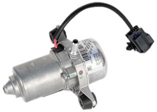

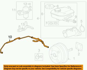

1) Using the LLT Vacuum Pump to assist the brake booster (for my cammed engine). Vacuum won't get high, so this will likely run all the time. This is what I picked up:
https://www.amazon.com/gp/product/B0...?ie=UTF8&psc=1
I also pickup the vacuum line for this same unit here:
http://www.ebay.com/itm/232187664916...%3AMEBIDX%3AIT
This will give me the vacuum line connector for the pump AND allow me to 'branch into' the brake booster vacuum line. I'll probably mount this near the passengers firewall where the cabin air filter is (with my ever decreasing room ;o).
2) Supercharger update (ported snout/blower and 2.5 pulley).
3) Within the next 5k miles, new valve springs/retainers/seals. That may be the end of this year based on I put about 6k miles a year on the car. That would put me @ 20k since I did the last set of springs.
I have everything for the vacuum pump so I'll probably start that this week. Need to fab up a bracket for the pump to install to and run a fused circuit to protect the pump. I'll scan the manuals to see what amp fuse it needs. The pump will 'assist' the existing vacuum (10 to 12 inHg) and should get me closer to 17-20 inHg with the pump. I do have a vacuum switch if I see its actually making 17-20 and I'll be able to have the pump cycle, but more than likely, it will need to run full-time -- which I believe the pump is designed to do.
Still, looking to see if I can find the male connector for the pump. If not, I do have a backup plan...

Also, got the connector for my vacuum pump so I'll be scoping that next. I'll post pics of the rebuilt blower and the vacuum setup I'm doing for the brake booster...

Here is a pic of the connector needed for the Vacuum pump:
You can get this from amazon here:
These tend to be unavailable so ebay or the dealer can get them.

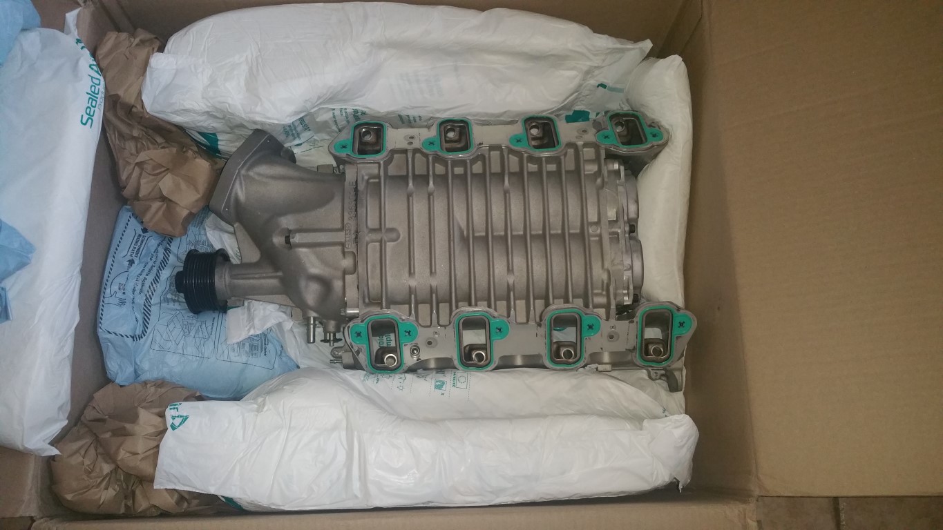

Now the supercharger. Packing was excellent and the condition was awesome. I spoke to Brett @ Jokerz and he knows who rebuilds these and said he is great. Here are the pics:
Nice! On it's way to Brett for porting!
Here is where you can get these rebuilds:
http://www.ebay.com/itm/222380415877...%3AMEBIDX%3AIT
These include the Eaton rebuild kit (parts replaced as needed) and a solid coupler. Mine turned super easy and the rotors look fantastic. I'll know more once Brett has started porting, but, these look awfully nice for the price.
The shipping is insured based on the price from what I see.
Overall, with the ADM kit and this, a GREAT way to get into a supercharged LS3/L99..

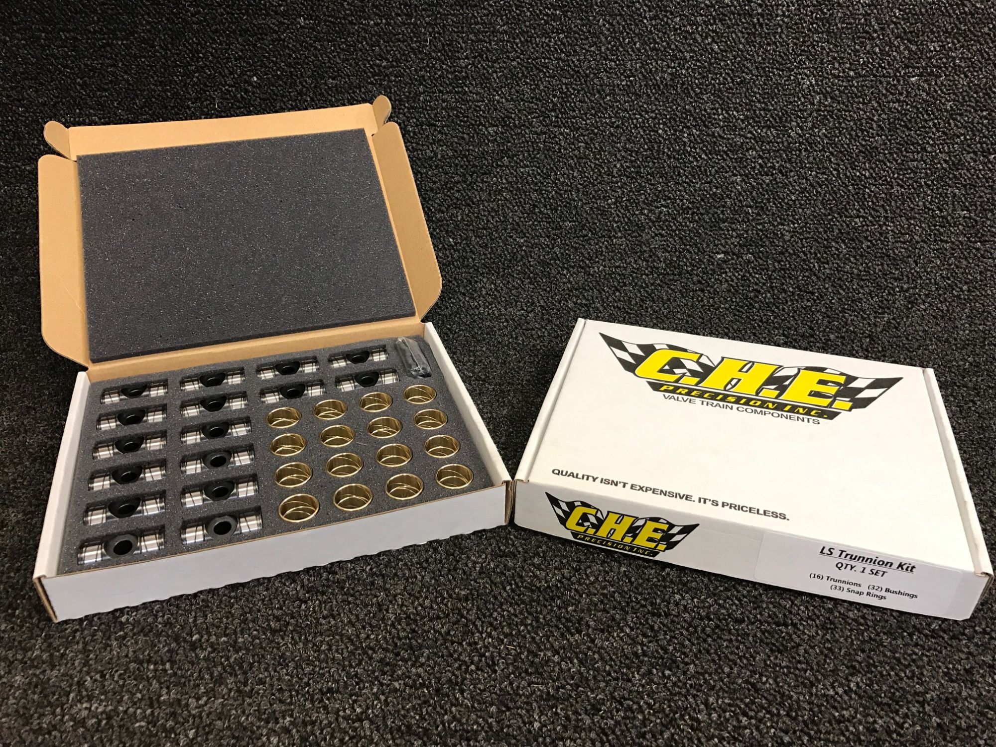

Getting ready to order my valve springs. While I'm in there, going to upgrade the trunnions to the C.H.E Trunnion Kit:
I've seen others out there, but these have a stellar rep. Can't go wrong with these...
Talking to Matt @ CHE to get pricing and timeframe. This is their new DIY kit and looks very easy to install...
