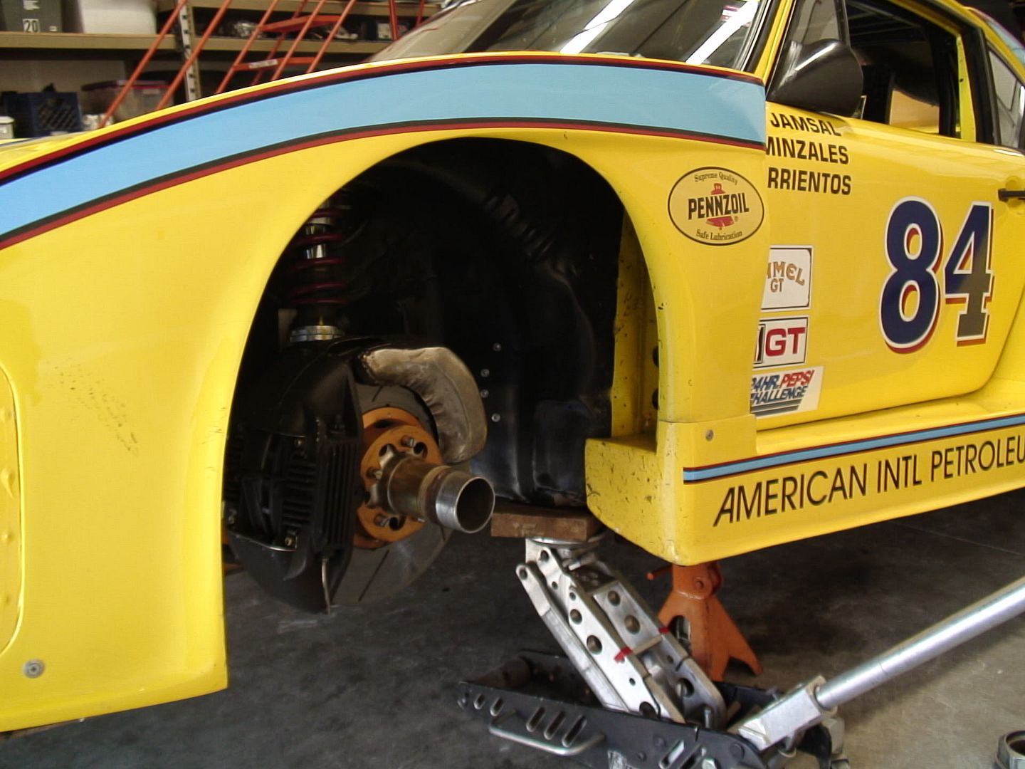

This thread is funny to read... first off your Camaro RS SS is not a race car it is a nice performance street car and the brakes on it are sufficient for some occasional spirited driving. You are also talking about a car that fully loaded costs 40k and for that amount of money it is a pretty damn nice car all the way around.
Two piece calipers have a tendency to flex under continual extreme use and if you do not have cooling run to your brakes no matter how large they are you can still boil the fluid and get fade ... For those with stock Brembos that are tracking your cars and getting fad look to trying some quality fluid and if there is anyway to get some direct cooling to the rotors ... different pads and even take a look at getting your rotors cryo treated . May be a simpler solution to spending 7k on new brakes .
I have huge Brembos and Lockheed's on my race cars and yet they are all cooled
These are the Lockheed's on my 935 .. that clam shell on top is fed fresh air by a 5" hose . 2200 lbs 850 hp fully dialed.... still need to cool the brakes.
This is my newer GT1 car 2000 lbs and 750hp with 15" rotors and Brembo endurance calipers and I still need to cool them too ...
All my rotors are cryo treated as are the backs of my pads
The upgraded Brembo's look bitchen and if you have the dough and want them go for it cool ... if you have the dough and don't feel the need so be it .. If you would rather spend the money else where then right on.. it's America
But for a few guys who think ... "wow I thought I got Brembo's and now I found out there are better Brembo's yadda yadda"... if you really thought you were getting the same Brembo's they put on a 150k Porsche Twin Turbo or Ferrari F50 or a 200,000 CL 65 AMG then I really don't know what to say ... I do not know any business in the world that makes one product... Burger King has a bunch of different brugers.... Chevrolet makes a Camaro and they make a ZO6 Corvette , Apple makes a few different iPhones and iPods.... different price levels to increase your customer base.
The brakes look great , congratulations.
ChevyThunder is offline   Reply With Quote
