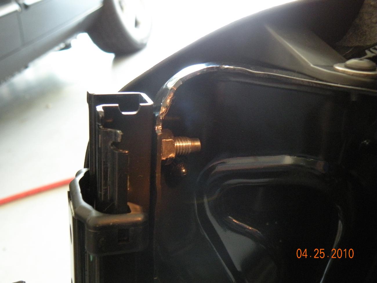

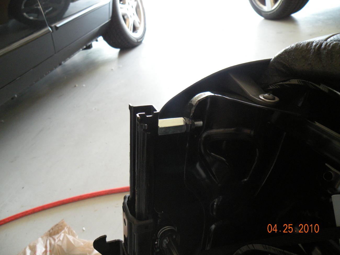

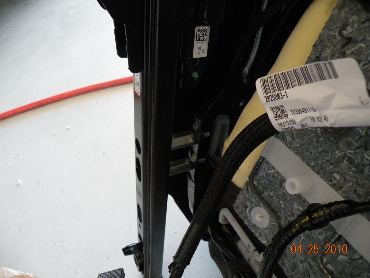

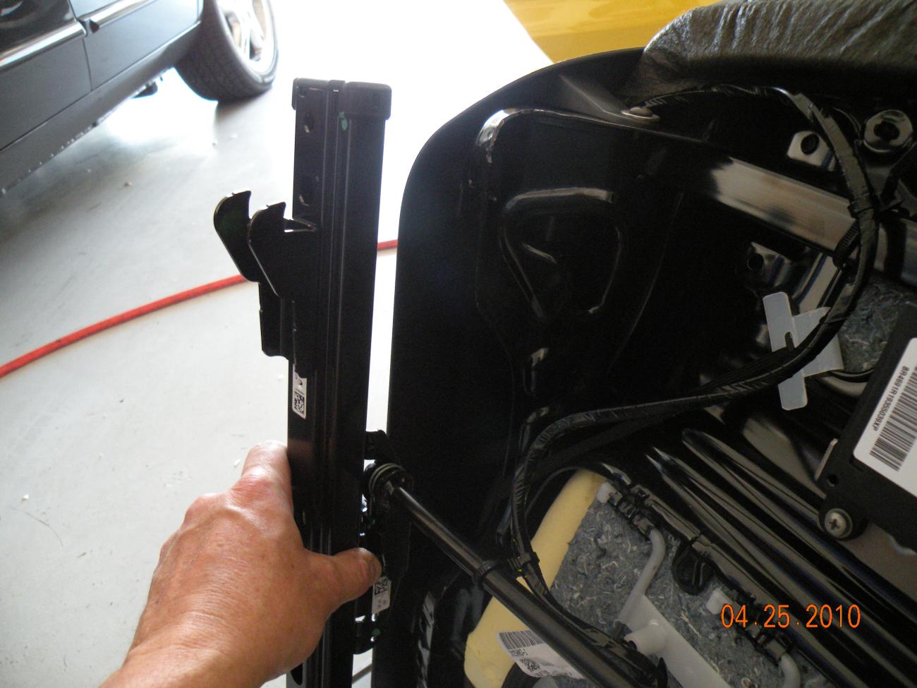

Raising the passenger seat 2010 Camaro

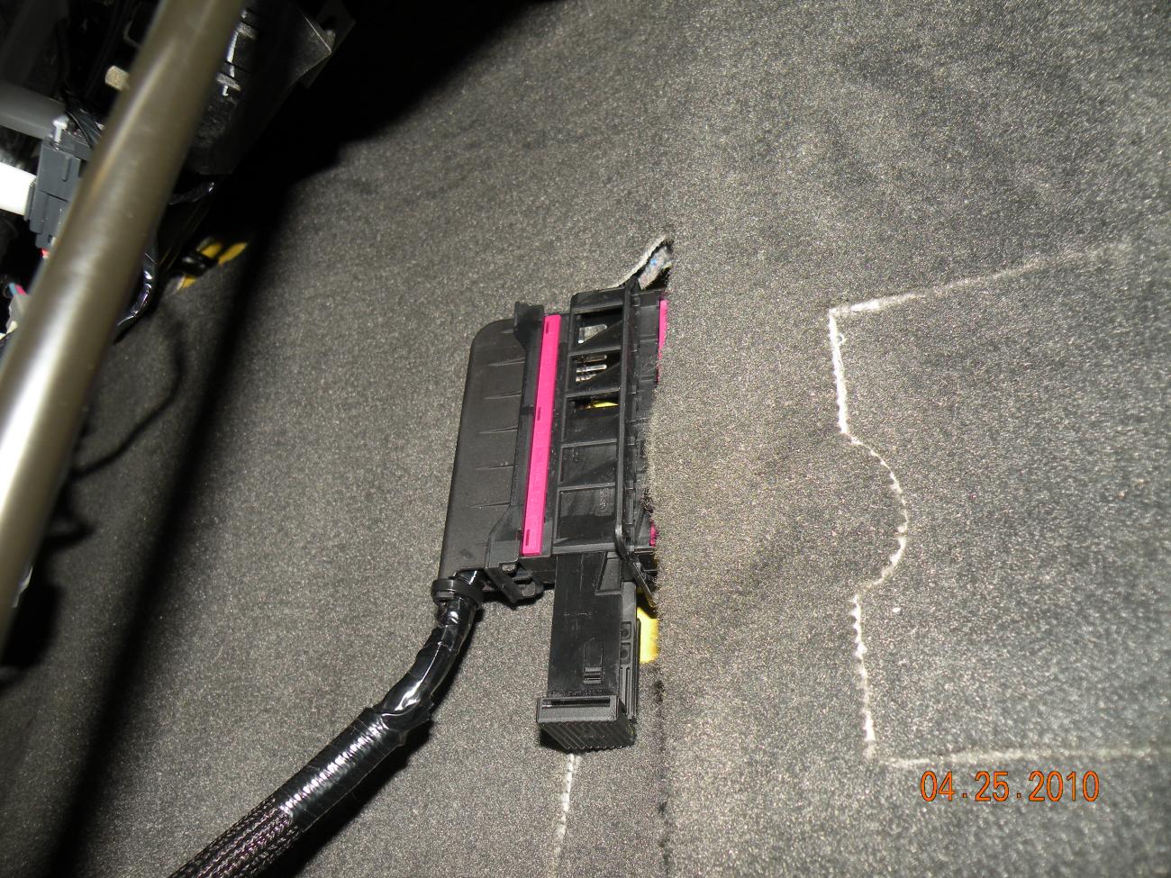

Ok, to raise the passenger seat, this is what I did. I took the seat all the way out. There is one electric connector to undo, this is kind of tricky, but there is a Plastic part that slides towards the door opening to unlock the connector, you slide this back in to re-lock the connector. The seat is held on to the seat rails by six torx bolts and nuts, I took these off, replaced them with six 50mm long bolts (8mm diameter) and reused the original nuts. For spacers I used six 3/8”-16x1-1/8 rod coupling nuts, the 8mm bolt fits right through these perfectly. This raised the entire seat by 11/8 inch. My wife is 5 feet 2 inches tall, she said this makes a big difference, and she is happy now !!!

... that is an awesome idea, thanks for the info and pics.... HOWEVER I am afraid for your wife riding in a seat modified like that. The torsionial forces on those 6 bolts is going to be EXTREME in the case of an accident. I know it would be a bit more work, but you will be safer in the long run if you can get two pieces of solid square stock (aluminum or iron) and drill the holes for the bolts through that (one piece per rail), which will tie the sides together better. Still may not be quite as strong as stock, but moreso than how you have it now. I will look to do something similar, I think, but with a slight taper, raising the front edge of the seat more than the rear, which should help with leg support.
Toasty
This is a very good idea, I think that I will do this and also try to use bigger bolts.

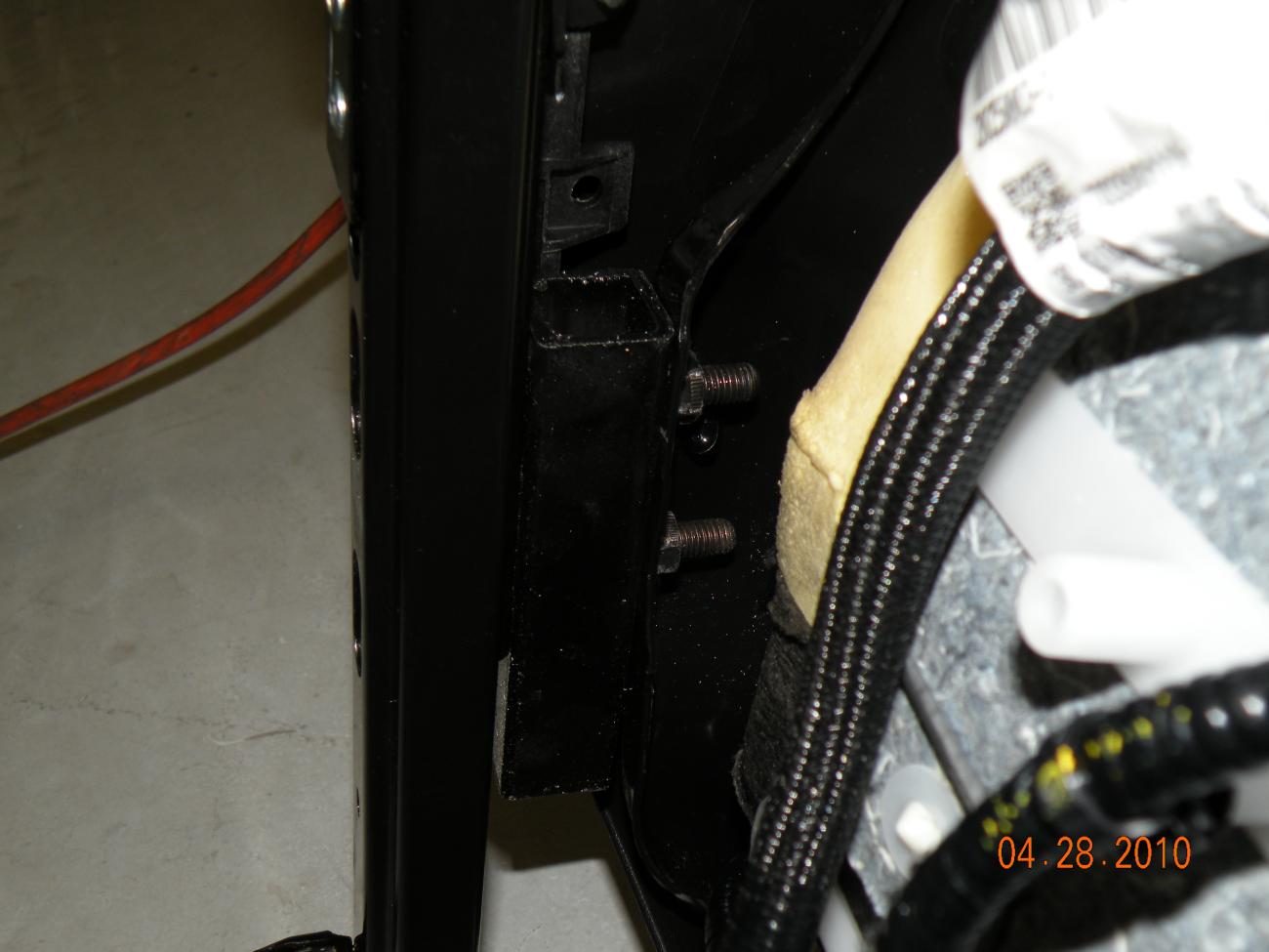

Passenger seat modification version 2
So I took the advice of Toasty (thank you) and installed 1inch, .090 thick square metal tubing, using grade 8 bolts and nuts. I tried to use size 10mm bolts, but they would not fit in the grove of the seat railings, so I stayed with the 8mm bolts. The only thing is you can’t use one long piece of square tubing because the seat forward and aft adjustment gets in the way, so you have to use two pieces per side. The forward part of the seat rail is held together by 1 bolt and nut, so I decided to drill another hole through the seat frame and using an existing hole that was in the rail. Looks and feels very solid.

looks better, but i think SOLID stock would be better (not tubing)

Yea, the guy at Patton's metal supply place where I bought the metal said that using this grade of tubing is the equivalent of using solid aluminum.
