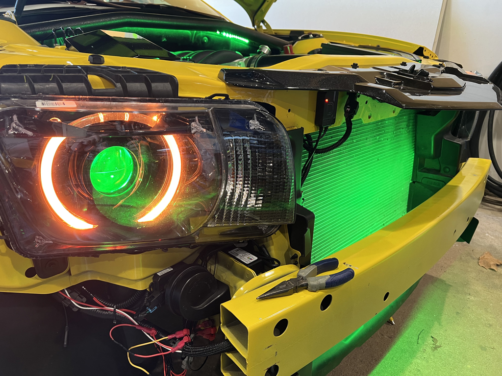

In other news, I was at a Halloween car show last weekend. I went to turn on my exterior LED’s when I noticed only my underglow lights were working. After I got home, I tested the lights again and found only the driver side demon eye was coming on. The rest of the lights would come on only in red, and very faint in green. Anyway, I pulled the front bumper off the other day and found the ground I used on the passenger side horn wasn’t making a good connection. Even though the horn bolt was tight, when I would jiggle the horn itself the LED’s would begin to flicker. I ended up placing the ground behind the horn bracket and really tugged at the horn to make sure the lights stayed on.
Name:  2023-10-21 13.13.03.jpg

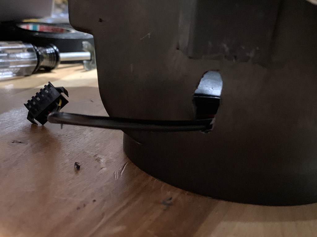

But since the front end is off, I also wanted to address couple other things I’ve been meaning to get to. First up, the harness I made to run the wires for the halo’s and demon eyes and dropped down, so each time I had my grill lights on I could see it dangling in the breeze. I had a couple mag-daddy’s left over from the underglow lights, so I used one to secure this harness to the crashbar.

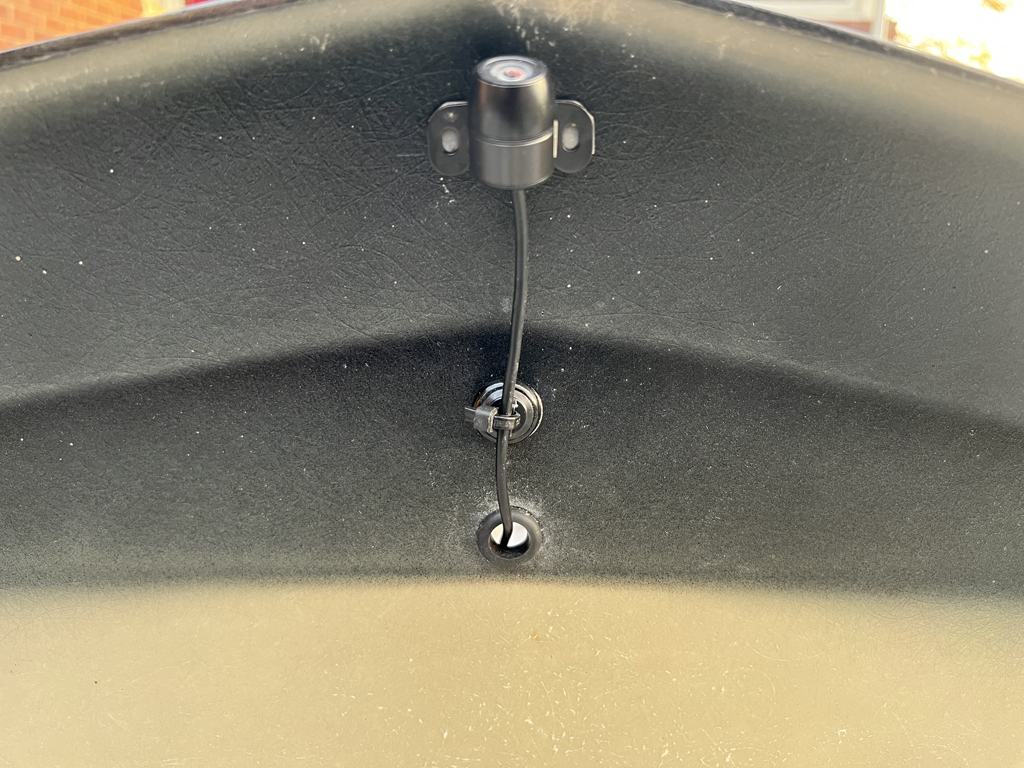

Next up on the list was to route the wire to my front camera better. When I installed it earlier this year, I just ran the wire along the bottom of the splitter and secured it using mag-daddy’s by sticking them on bolts. Although they have held up so far, I didn’t like having the wire ran like that. Instead, I drilled a small hole through the splitter so I can run the wires on the inside of the bumper. This should keep them protected while still giving me access to unplug them when needed.

Nice clean install on that front camera. Looks good! Such a clean car.

Thank you!! I struggled with deciding where to place the front camera. My initial thought was to have mounted it in a spot that it could stay on the car when the front bumper was removed, but I also didn't want to be able to see it while standing in front of the car. However, since its main function is to protect the splitter from hitting anything, I think the spot I have it works the best. As a bonus, I also put a piece of painters tape right near the garage door, so now I can simply line one of the grid lines on the tape and get it in the perfect spot each time.

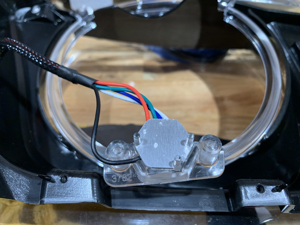

Just curious, what's the process of getting the RGBW halos installed? Is the headlamp difficult to take apart without damaging it?

LOL...yeah, pulling the front bumper off is a process, but it does get easier each time.
Installing the RGBW halos themselves were very easy...it's just swapping out the board with the new one and running the new wires out of the head light.
Name:  2021-04-11 18.39.39.jpg
Name:  2021-04-12 21.40.19.jpg
However, getting to them was a pain. I watched several YouTube videos before attempting to open up the headlights. What worked for me was to bake the headlight at 250 degrees (F) for about 15 minutes and then used a wide assortment of flat tip screwdrivers to separate the lens from the housing. Once I got one of the corners started, I found using a long, thin screw driver worked best, as I could slide it between the lens and housing while it gave me just enough leverage to pry it apart. Also, don't hesitate to stick it back into the oven. I had to put the first headlight back in 2 or 3 times before I could get it apart.
As long as you are careful with the screwdriver, and make sure you have a soft towel down on your workbench, you can open them without any damage to the headlights. I did have one slip, but fortunately it was along the top of the lens and is completely covered by the bumper.

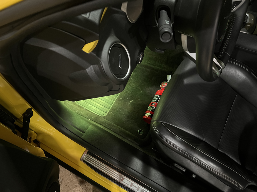

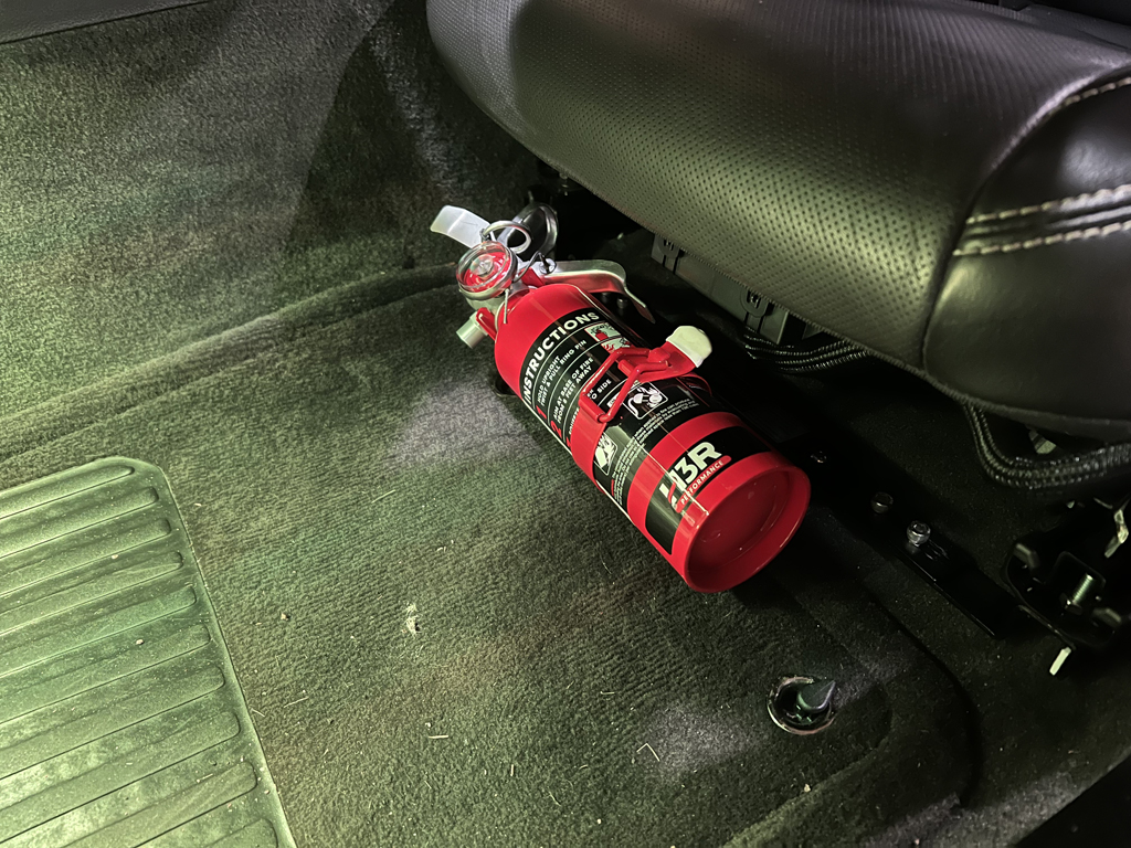

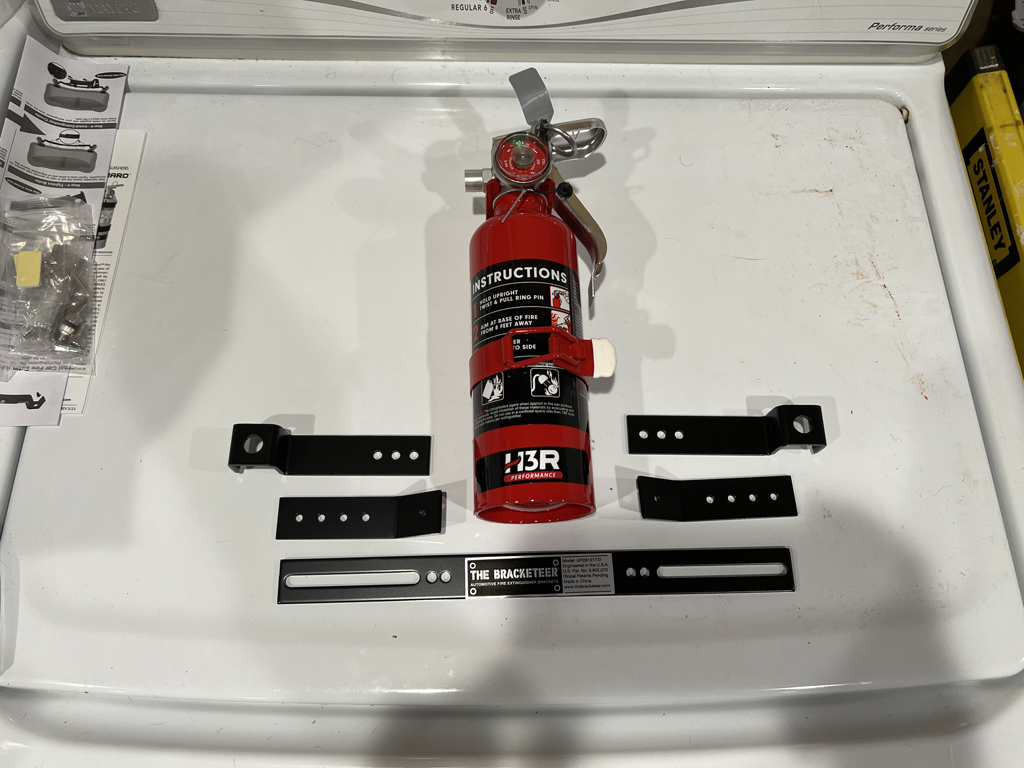

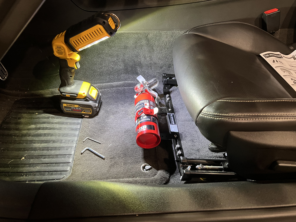

I installed an H3R HalGuard 1.4 lb extinguisher that I have been meaning to get for a long time now. However, I was struggling with finding a good mounting solution as I wanted to keep it close to the driver’s seat while not getting in the way. So I ended up going with a product called ‘The Bracketeer’ which has a wide range of mounting options.
I first attempted to install the clamping arms into the rail, but unfortunately, once I moved the seat forward, it would push the mount right off. Luckily, I had a couple nuts and bolts laying around so I flipped the clamping arms along the bottom of the seat rails and was able to get everything secured. The last two pictures are where I keep the seat.

That is a good mod to have, and hope you never have to use it. This is something I will be doing also before my car goes back on the road.

Yeah, definitely the one mod I have no problem with ever having to use!

That bracket looks pretty sweet, I know that i need to add a fire extinguisher to my list... This bracket and the pricing might just get me to pull the trigger.
