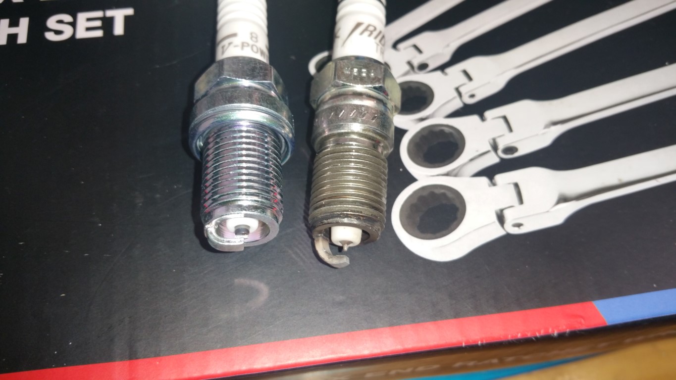

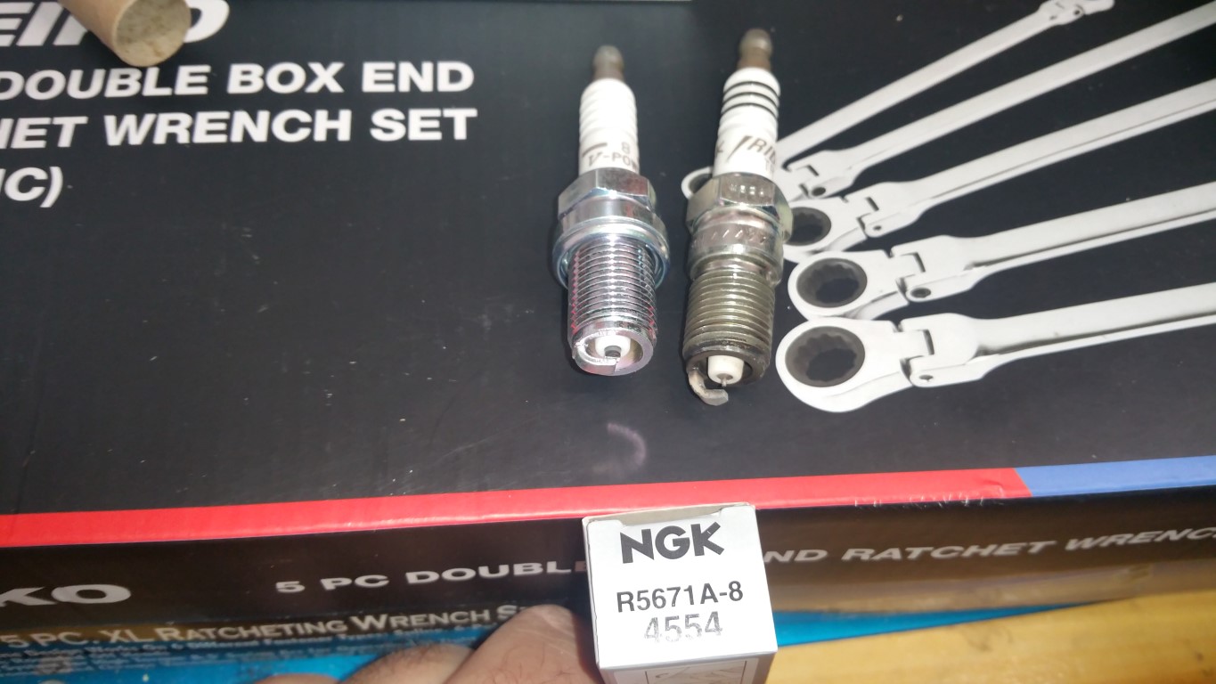

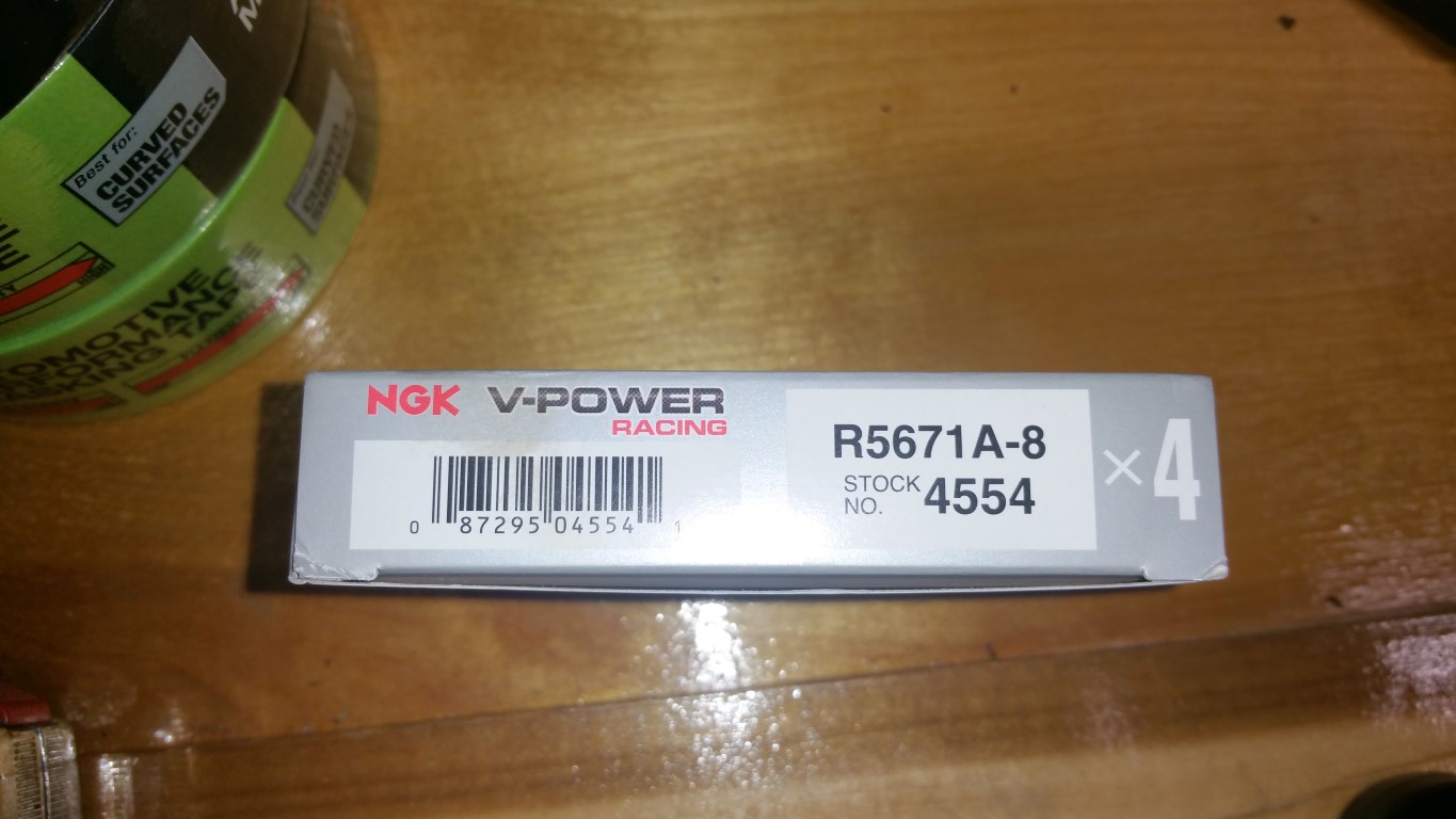

GPI Prep Day!
Alright! One more day!
Before I leave, I checked in with Ryan about my choice of plugs.
I was running TR7IX, and was looking to goto TR8IX (I have them), but after discussing with Ryan, I installed these:
Ryan suggested I go with these and, since I trust him, installed them. They are 1 step cooler (8) and are Gapped to .030 (that is what they were in the box) and did them in about 45 minutes. Note, the TR7IX is a iridium resistor/projected tip, and the R5671A-8 are not resistor/not projected tip, and copper...
Ready to see what she'll do!
-Don

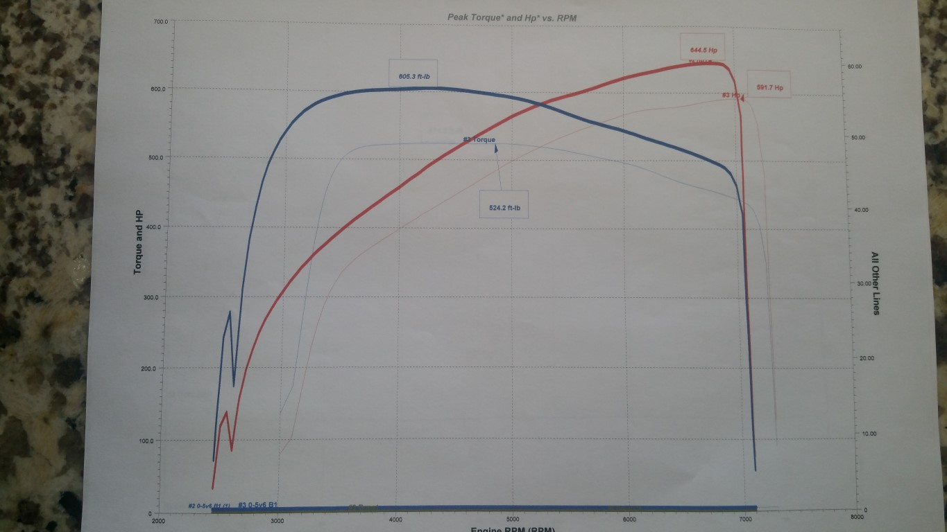

Numbers are in!
Let me setup what we did:
Ryan actually drove the car first, did an initial setup, then brought the car back into the bay to do 2 things:
Re-install my exhaust (the damn clamps didn't hold when he did WOT -- sounded like cut-outs)
And HEATSOAK the blower. We were going to do a cold start, then warm it up, but circumstance be, this is what was decided.
Why? Because road racing, its gonna heat-soak, and that is how Ryan did the dyno runs!
So here it is:
That is 55 RWHP and 80 RWTQ on a baby NA VVT SS1 cam and 10 PSI Boost! We did the runs 3 times and they all came out this way...
The torque increase in incredible -- we were smoking the tires on the dyno rollers -- funny -- until I realize I have to buy tires ;o)
VERY PLEASED with the numbers.
Brett @ Jokerz Performance did an outstanding job. Every step was detailed and now, with just the 90 MM snout port, blower port, and the 2.45 pulley, incredible setup.
Ryan and GPI always treat me awesome and did an outstanding job tuning! Ryan drove this several times and really dialed it in. How can you complain with that gain on blower only change -- wow...
-Don

Old 04-06-2017, 07:01 PM   #1186
Ashen 6.2
Ashen 6.2's Avatar
Drives: 2014 Camaro Z/SS
Location: NW Arkansas
Posts: 2,162
Originally Posted by hammdo View Post
Numbers are in!
So here it is:
The torque increase in incredible -- we were smoking the tires on the dyno rolls -- funny -- until I realize I have to buy tires ;o)
Brett @ Jokerz Performance did an outstanding job. Ever step was detailed and now, with just the 90 MM snout port, blower port, and the 2.45 pulley, incredible setup.
-Don
Awesome results Don!!
GPI 416 w/GPI S/C Cam, GPI Ported Heads & Tuned by Ben, Holley Dominator ECU, Mag Heartbeat, ZL1 Fuel Pump/DSX Aux Pump, NW 103 TB, FIC 1650's, Alky Meth, Rossler T400 w/t-brake, Circle D Converter, Kooks Headers, Viking Coil Overs & all the BMR Goodies in the rear, Zl1 3.23 Diff, DSS Axles, Wiles Racing Driveshaft, Hendrix Offset Diff Bushings, AFE Solid Subframe Bushings, 875HP/843TQ 5FDP
Ashen 6.2 is offline   Reply With Quote
Old 04-06-2017, 07:41 PM   #1187
hammdo
'It's an experiment'
hammdo's Avatar
Location: Dallas TX
Posts: 8,709
Thanks! I maxed out this setup... Forged and stroked is next!
Drove it 350 miles back today and the torque really showed up... Just Awesome.
Brett @ Jokerz Performance really set me up well. Beyond pleased with his work. Ryan just nails VVT. A blower specked cam and I'd kill these numbers. We guessed 660 RWHP -- so close -- but the torque, that was a total surprise. My numbers were for a heat-soaked blower too!
No glory run this time ;o) 3 straight pulls, consistent numbers. It's awesome...
-Don
747 RWHP 794 RWTQ
