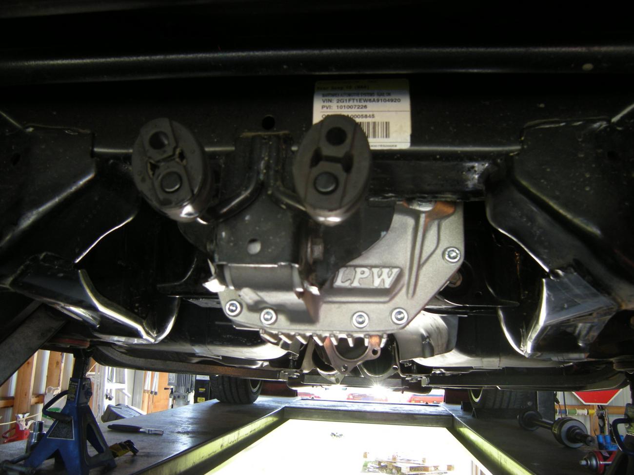

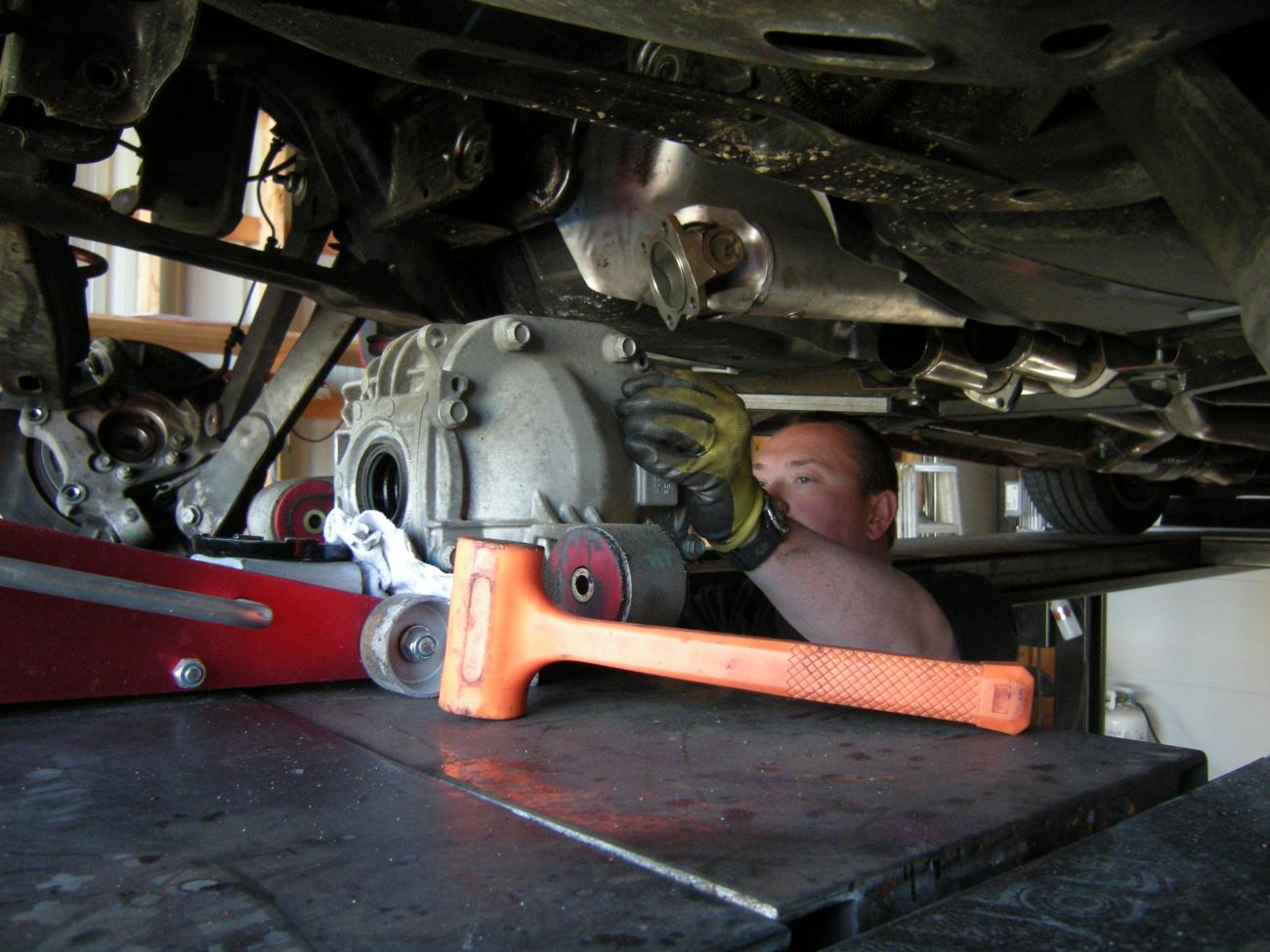

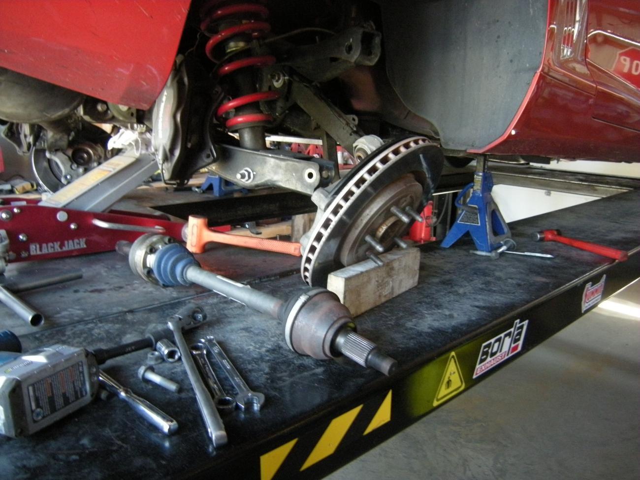

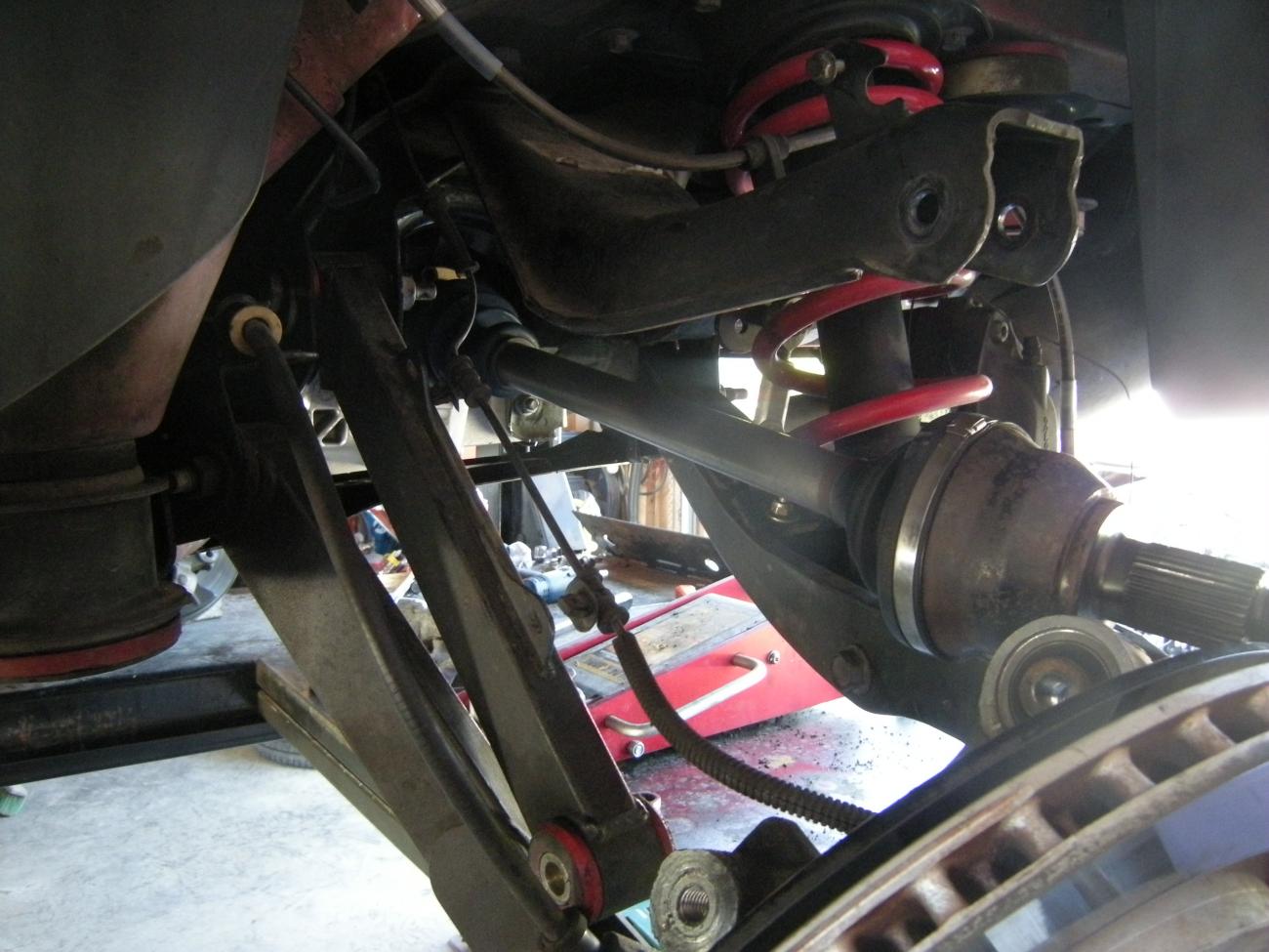

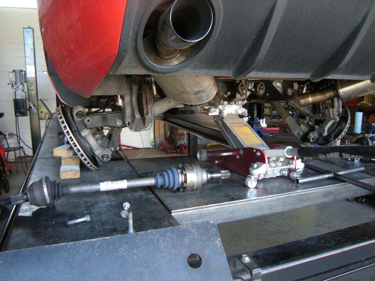

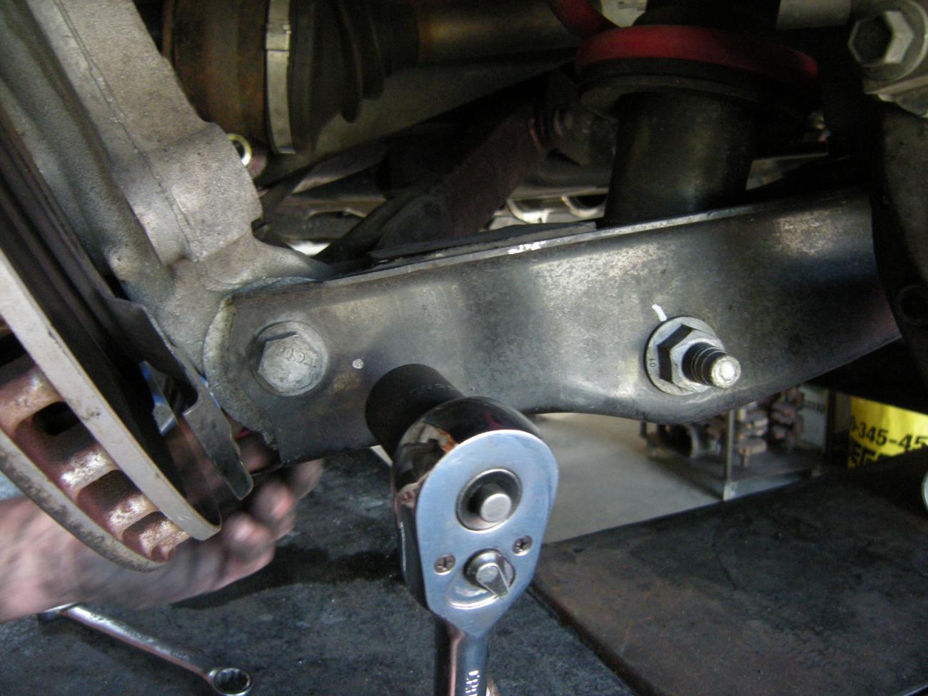

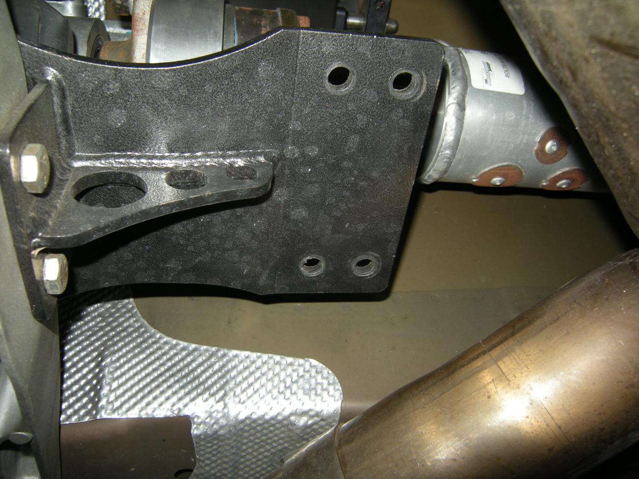

Here are the diff swap pic's as promised.

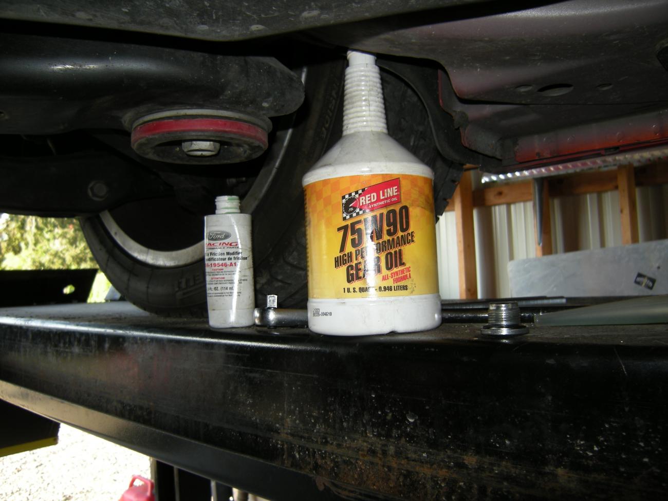

Driving impressions. Pull's way harder down low and 5th and 6th on the HWY are way more usable. The Jennety posi mod is tighter then a tic of the hop. We started by using Red Line 75/90 with friction modifier only. Look's like we will have to suck out a little diff fluid and add a bottle of friction modifier to the diff to loosen the posi up a bit. Have to talk to my builder later today.

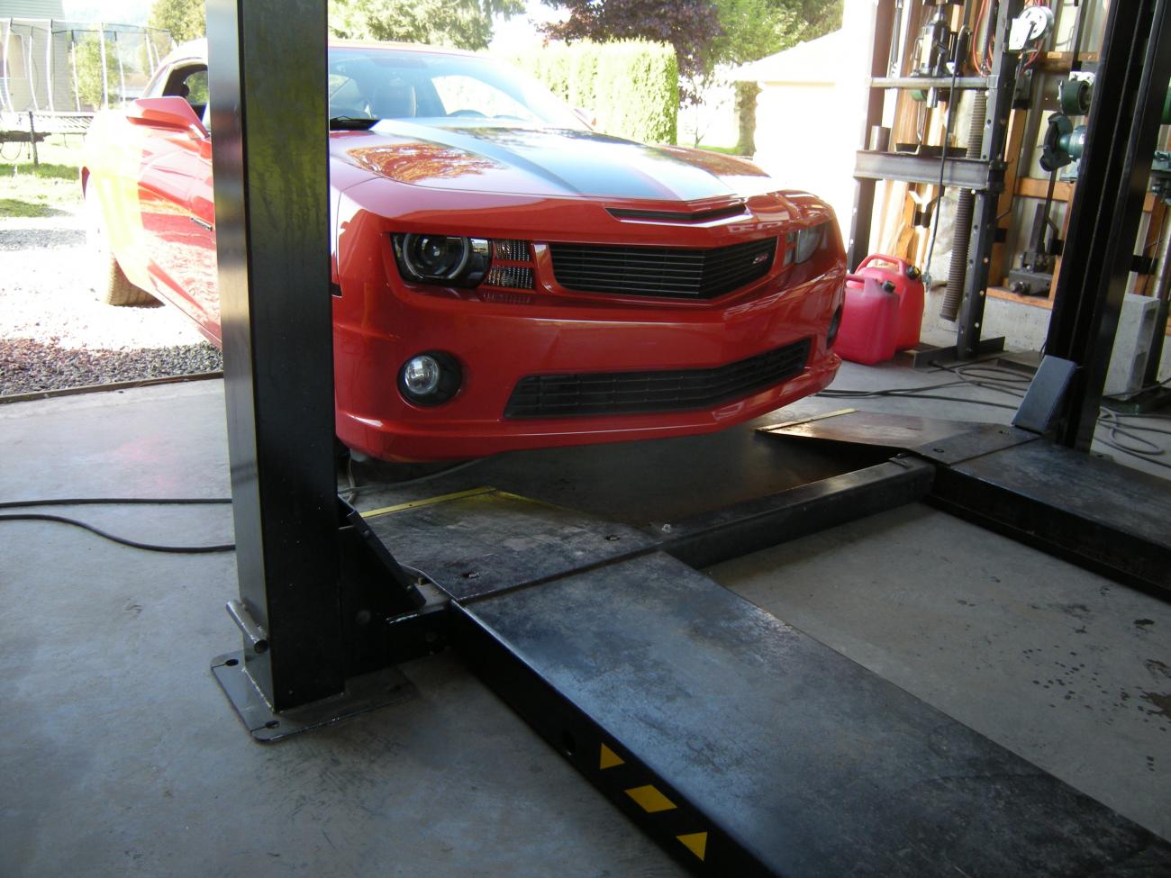

The Jannetty posi mod is very tight. Feels like I have a spool at low speed. :( We started out by just using the Red Line 75/90 with built in friction modifier, no where near enough friction modifier. Have to put Pumpkin back on the hoist to night and add a bottle of friction modifier to the diff to loosen the posi up a bit.

Back on the hoist last night for a few minutes to replace some gear oil with friction modifier, followed by a few glasses of Green Stone Brewing Cream Ale.

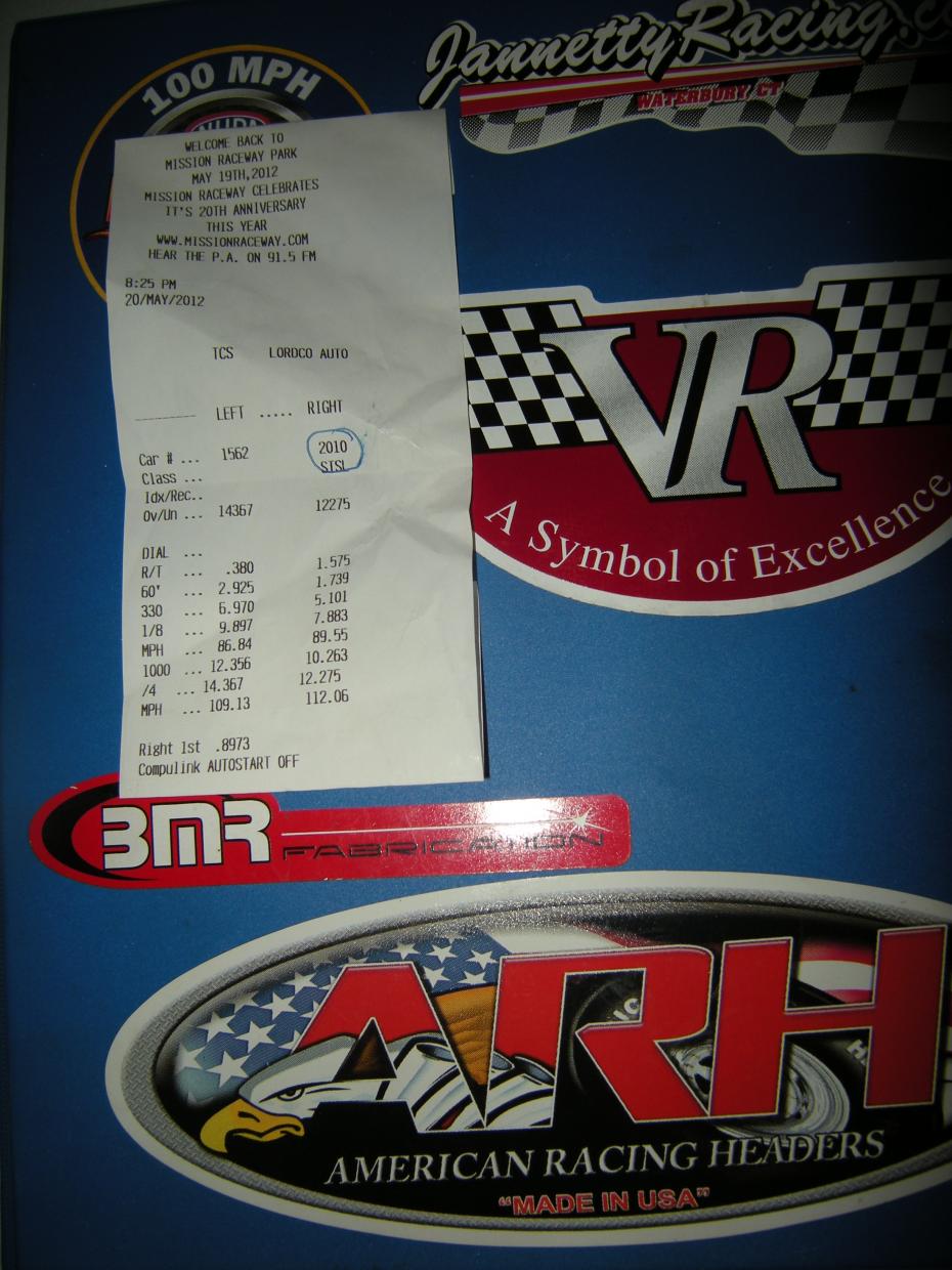

Posts: 11,310
Pumpkin runs fast at Street Legals to night. Fastest 60', 1/8 and 1/4 mile. Now I'm going enjoy a few Green Stone Brewing craft beers on a Victoria Day holiday weekend.
Thanks Speedster I love the new diff and gears.
