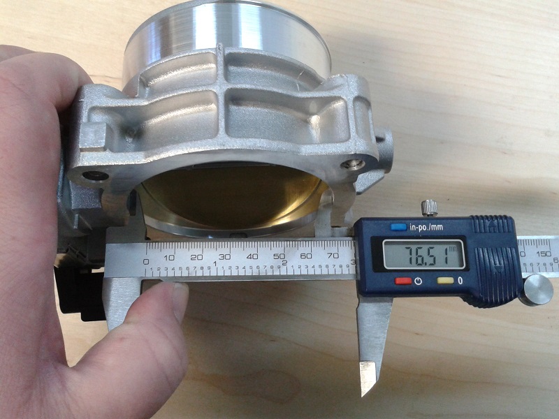

Hi guys! Found your discussion, hope you don't mind my joining in.
The LFX throttle body and the 80mm kit that I've developed won't backfit to the older computers and vice versa. As you can tell the wiring connectors are different, and after a lot of back and forth and testing while developing the LFX kit, there was just no way for the LFX computer to operate most older throttle bodies and it should be the same vice versa there'd be no way for the older computer to operate the LFX style throttle body.
Here's the 76mm throttle body I have for the LLT (76.5mm to be exact). It's not off of the G8 V6 but I use it to upgrade both the LLT and LY7. A few minor modifications are required on my end. It has the same lips in the bore that the LLT unit has that can be ported out, I don't offer that service yet but have done it in the past, requires breaking through the casting just a little and refilling the cavities you see with some epoxy or weld to get the best results, but its still a nice upgrade on its own.

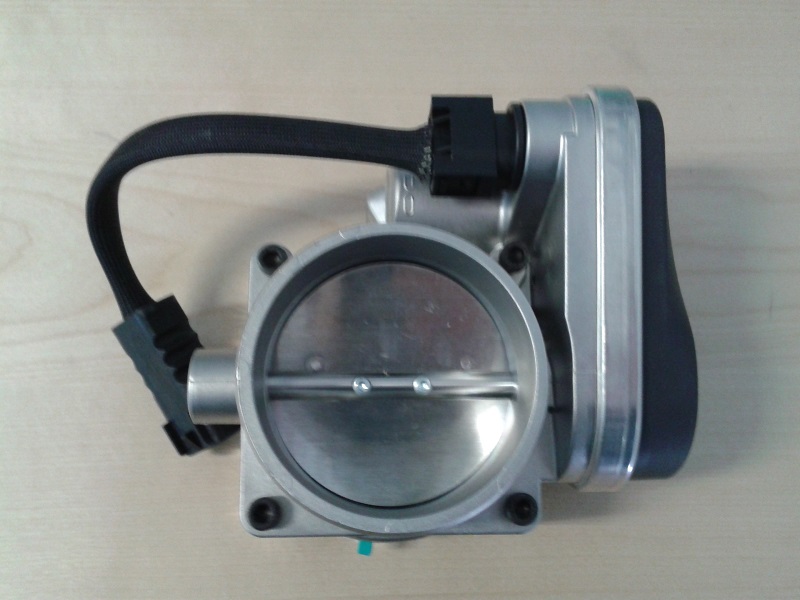

Here's another example of a throttle body that I worked on this past summer. This unit is 81mm IIRC. It wasn't going to play nice with the LFX computer, unfortunately. I also tried quickly on the LY7 and didn't seem like it will work there either, threw a P2173.
I haven't ruled it out completely, needs further testing. It's a VDO brand unit rather than the Hitachi and the electronics are different, the signals may be too different to resolve, but I do have adapter plates and wiring harnesses all engineered to work on the LLT/LY7 that will otherwise go to waste.

Thanks for all the info. What kind of testing would be required for the 81mm unit?

Bolt it on, plug it in, see if it throws a P2173 code on you or not. Everything's all set up mechanically, its just a matter of whether the computer will operate the TAC module properly
