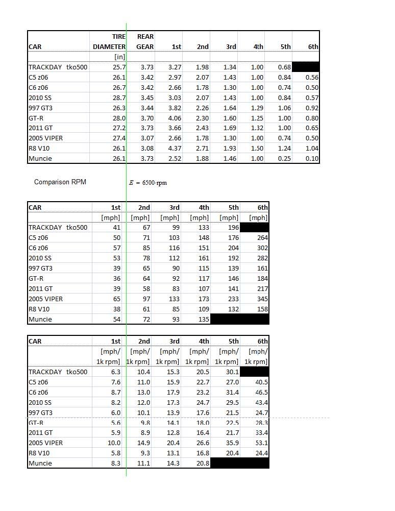

Old 01-26-2010, 12:36 PM   #123
sik68
sik68's Avatar
Drives: 1968 Camaro, 2002 Subaru WRX
Location: Sacramento, CA
Posts: 86
This one? I posted this in one of the camaro vs. mustangs thread "Prove moderators wrong". The 2010 SS numbers are mildly different from what ART-2008 posted....probably due to a small difference in tire diameter that I have on record.

Old 01-26-2010, 01:02 PM   #124
daphatgrant

daphatgrant's Avatar
Drives: '10 2SS/RS RJT
