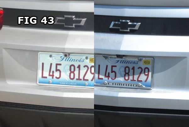

I installed the new camera today. Couple of things:
Fig 38; mounting it from inside the bumper, I needed to trim down the flanges on this camera. The area between the plate lights is recessed up there. So this needs to fit down in. I took about 1/4" off each side.
Fig39; I removed the plate lights, then cut a hole as shown using a dremel with a cut-off wheel. I don't have very steady hands, obviously.
Fig 40; Using 3M auto trim tape on the flanges, just fed the camera up through the plate opening, and was able to press it down firmly through the light openings. Yes, it's a little off-center. No, I don't care. I might go back and put a bead of silicone around the opening.
Fig 41; I also might go back and shorten this harness, or splice the pigtail directly to the other wiring harness (getting rid of the RCA and power connectors) I just didn't feel like splicing wires today. And there is plenty of space there to stuff the wires into anyway.
Fig 42, 43; This camera is much bigger than the other one. I was afraid it would stick out even more. This is why I mounted it from above. It is actually less noticeable this way.
