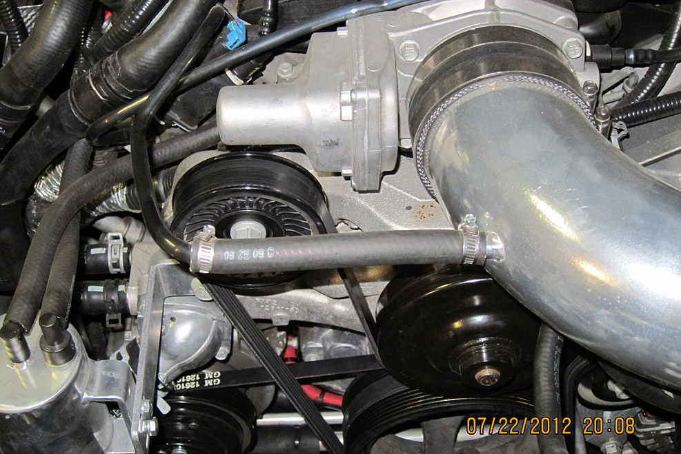

Originally Posted by 20camaro12 View Post
I have the CAI inc intake and VMAX TB.
I checked everything twice, with ears and hands to make sure nothing was loose. Everything feels and sounds great. No sounds of air leaks, or exhaust leaks. The only thing I was not able to check was if it is running rich like it was last time. Had excess residue on the tailpipe. I washed it then had to come back overseas.
I really appreciate you guys helping me out, but I am certainly NOT trying the thread jack at all.
Those are what I have on mine and they work fine. Only things I can think of is to make sure the throttle body is tight and sealed; make sure the connecting clamps on both ends of the intake are clamped tight, and check the line coming into the CAI as indicated in the pic below.
I decided not to go the shrink tube route on the ends; I got proper hose clamps and clamped both ends to make sure there weren't any leaks. I know it comes with the shrink wrap but I didn't want to take any chances of a leak so I went with clamps.
Make sure the MAF is properly seated, sealed and secured.
If all those things are good then I'd recommend having your tuner look into the idle maps in the ECU.
Attachment 401344
I actually went with the shrink wrap. Everything felt really tight, but I know that these engines will suck a lot of air in when pushed. Ill add the extra measures of clamps and see what happens. Like you have mentioned having the tuner take a look at the idle maps and then take a look at which sensor is reading different than stock to try and find where this leak might be. Thanks!

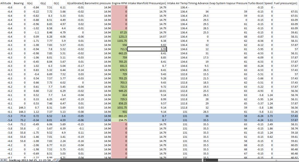

So I logged the car starting up and then going to back up and it died.
I went to go to lunch and when I backed up the car died. So I pulled back in the parking spot and started logging. (LOVE this app, started a log by grabbing my phone and hitting 3 buttons. )
So while I logged I started the car, went to back up and gave it a tad bit of gas and sure enough, it died.
However, I apparently am not logging the correct PIDs to get an idea of why.
As you can see in the blue, there were no abnormal readings when it died. So I need to log the right stuff.
The phone always keeps my latest datalogged PIDs as the default. So which PIDs should I keep on ready?
Name:  New Picture (4).jpg

Sorry. The first collums are default ones.
Here's the ones I logged. Easier to read.
