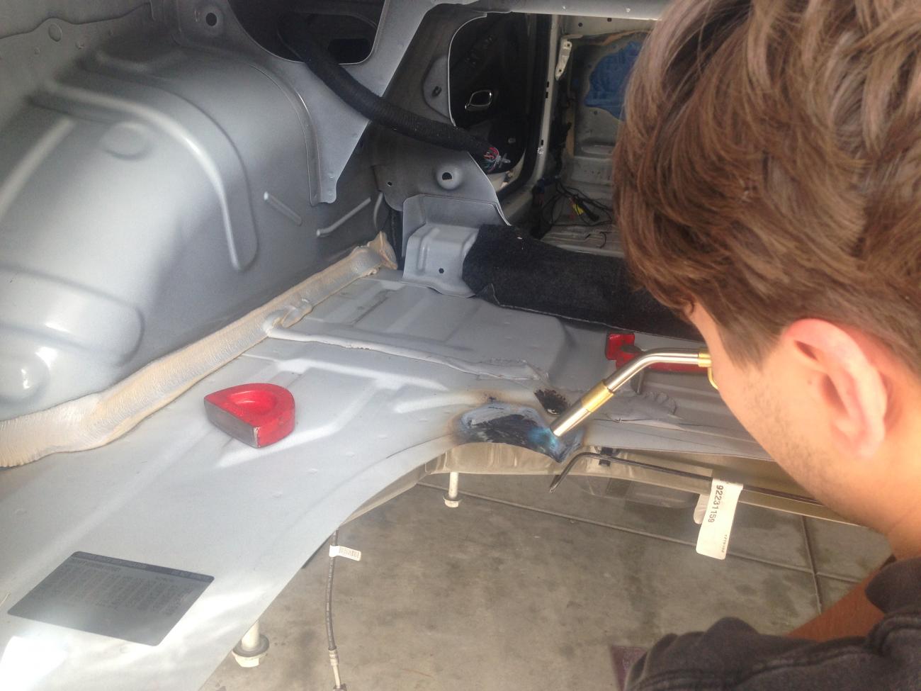

Trunk Redo 4
The work continues on the trunk. I did some hammer/dollying and shrinking of the channel were the battery cable ran, creating a flange so that we can rivet the filler panel and make it look more finished.
Started by heating the metal
than gradually working it
and finally cooling to shrink it. This work had a very therapeutic effect! Sorry forgot to take pictures of the finished product but came out really nice.
