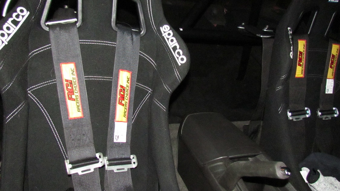

honestly ill need to track it to give a real opinion. they have a big roll of padding for that area under your knees. i just wont be able to give a real review til i see what i run into. so far they seem great but this is the first road track car ive ever owned/built so id be guessing or talking over my head if i pretended to know. the seat model is the Sprint V.
after spending more time on the seat brackets than the cage install, the seat positions are good and i finished the welding and painting of the seat brackets today. 24 days til road atlanta. ill have under four weeks between rd atl and sebring to fix anything that doesnt work right. its just so good to be down to the small stuff.

slapped some wal mart carpet over the metal in the back seat area. it made it unbelievably quiet for about 2 pounds of carpet. i havent even glued it down yet. that center piece is a piece of carpeted cardboard that is screwed over the trunk hole. if you leave the trunk hole open, the car gets a low pressure surge pulse at about 125 that will drive you crazy.
it is a frickin blast to drive it around. i love love love this setup. i feal like i could wheel it without getting tired like i always do. you can just hover your feet over the pedals. you dont have to have the heels of you feet touching the floorboard to keep you balanced in the seat. your IN the seat and can use a delicate touch on the pedals. man i hope i can just be easy and learn to drive this thing. i think i can have some real fun in this. different vehicle.

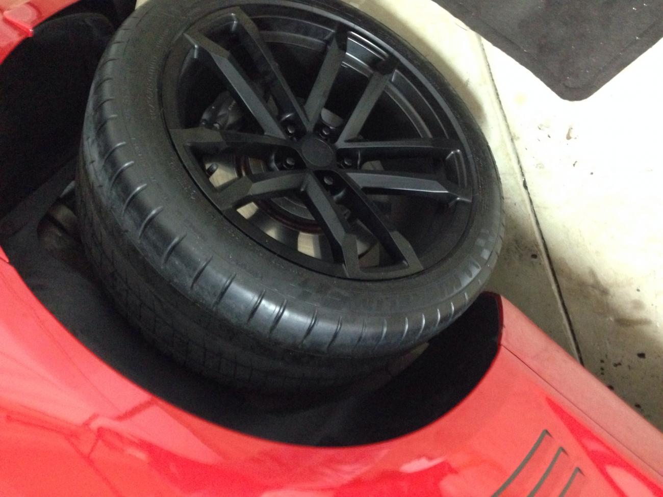

So... who all had to cut the f $ cking wheel well out? Apparently when you do it correctly the bolt heads and plate push on the inner wheel well plastic...
This is true to an extent. I trimmed my wheel well to follow the inside curve The bolts will push the wheel well out and possibly rub on the tire if you don't do this.
You have to look close in this pic. But you can see how I trimmed the wheel well. It only had to be done on the side of the wheel where the the backing plate was. You can't see it with the wheel on and the car on the ground.

Old 02-22-2014, 07:23 PM   #122
Jpb972
Jpb972's Avatar
Drives: 2011 2SS/RS
Join Date: Oct 2013
Location: South jersey
Posts: 584
The cut was something like this.
