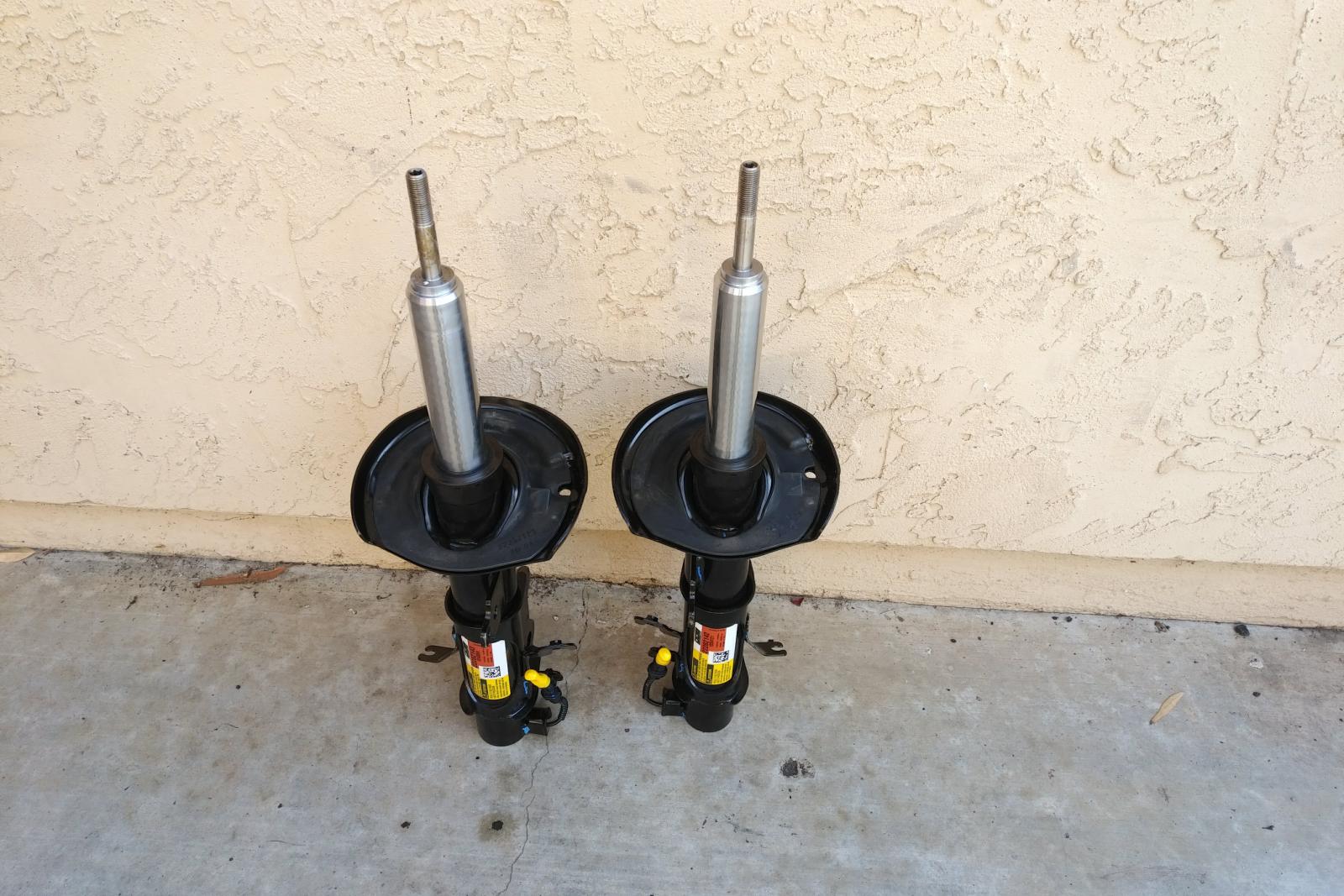

Got mine off Amazon, paid $1600 for both. I’m still not understanding if I should use them or not. I’ve heard of a redesign but is the redesign the reason for the 1-1/2” longer piston shaft? That’s the answer I can’t find. I did see a picture of some take offs from a 2014 and they are exactly the same BWI struts I bought. But it seems my 2013 take offs are a different number and shorter. What to do????

Whisper1 and VChula, what were the numbers on your struts? Were they BWI.
The ones that are longer that I bought are
22282142 and 143. I’d feel a lot better if those are the ones you put on your ZL1s

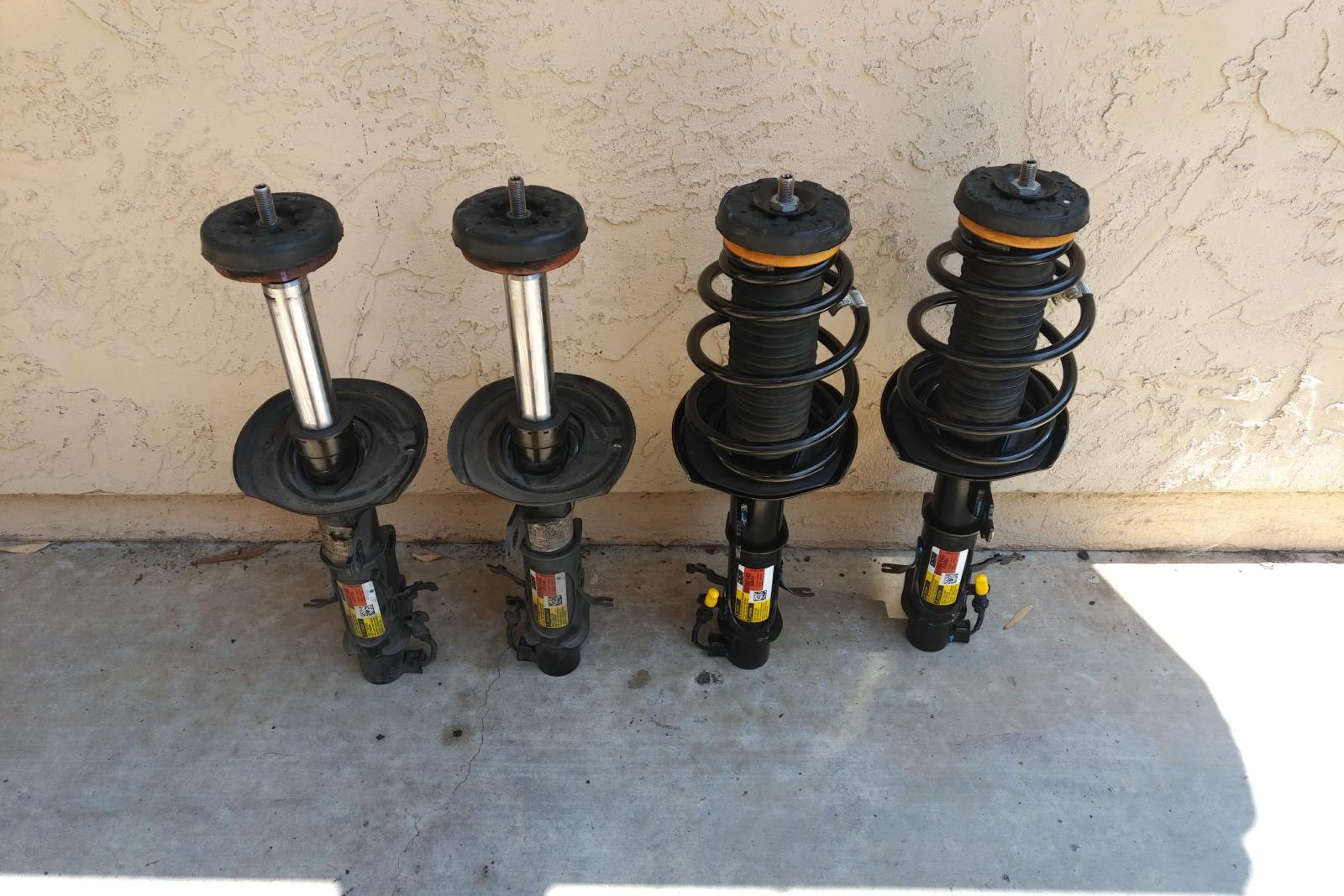

22282142 and 22282143 are what I actually removed from my car in 2020.
They were replaced by those exact same part numbers- but another difference is in the numbers that are indicated directly below the BWI numbers.
Original BWI 22282142 and 22282143 also had "14111141" underneath (possibly a date or a batch code)
Replacement BWI 22282142 has "18304121" underneath, and 22282143 has "19168091" underneath.
If you have higher numbers than "14xxxxxx" or "15xxxxxx" on yours, it is a good bet that you have the updated shocks.
Also, you can see in the first picture that the newer strut set is taller than the original strut set.
