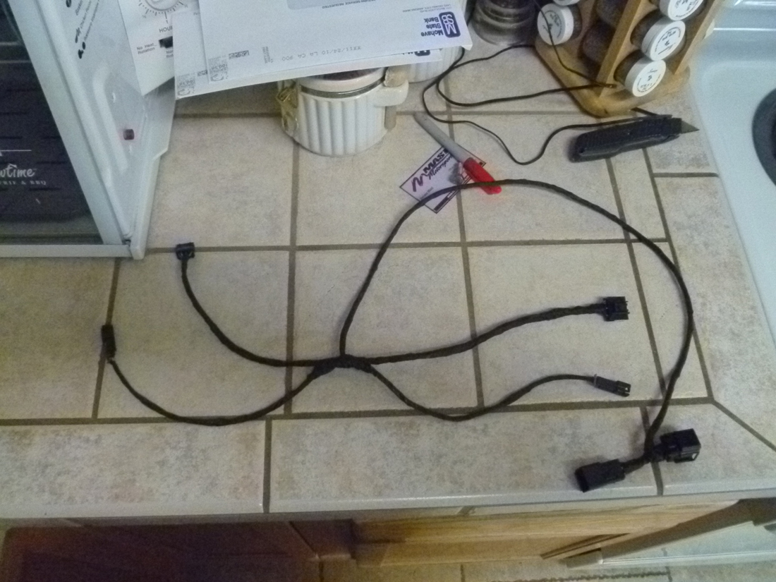

For the ppl that want to see the harness here is a pic with the ABL.
And to all a happy new year.
