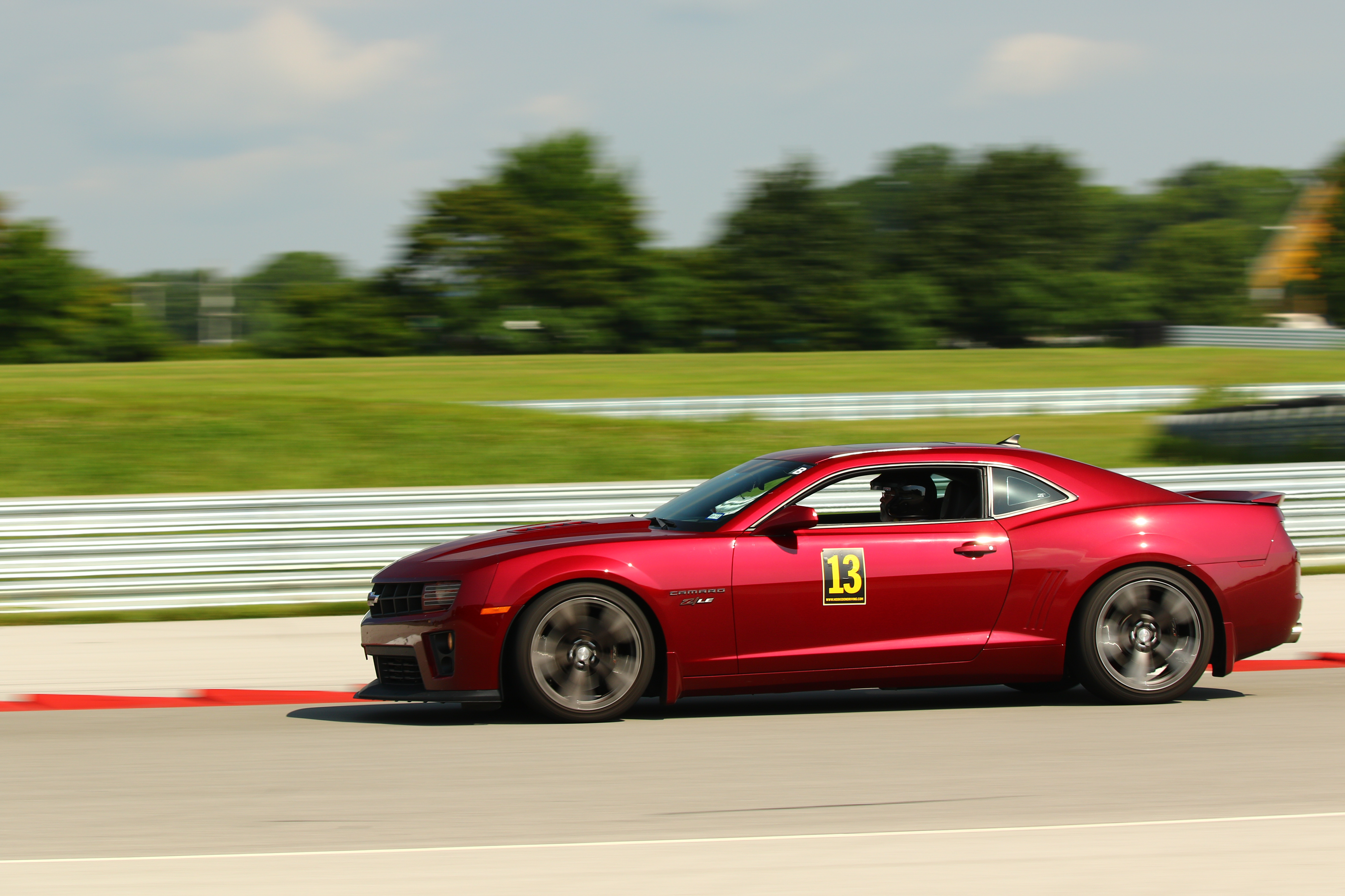

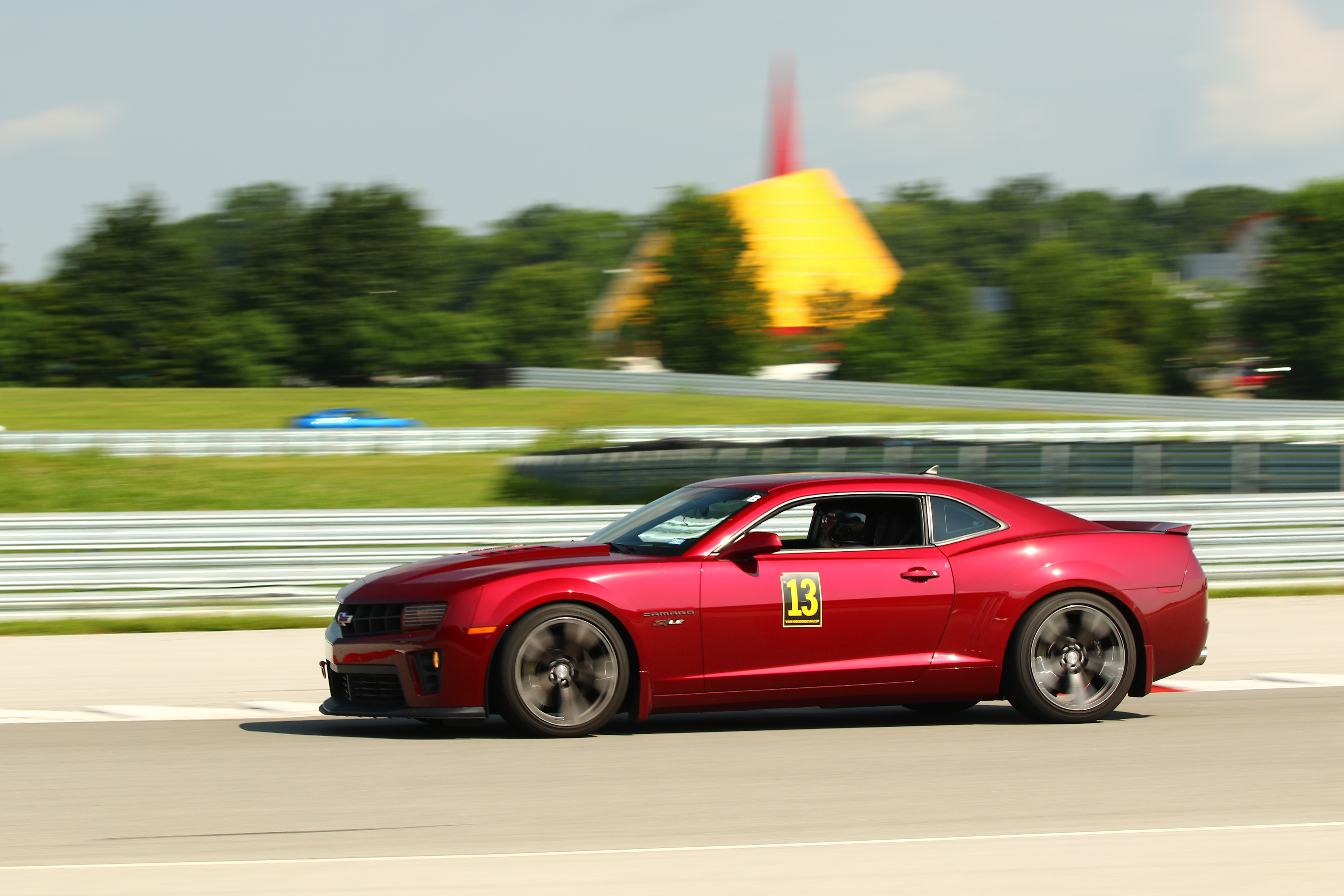

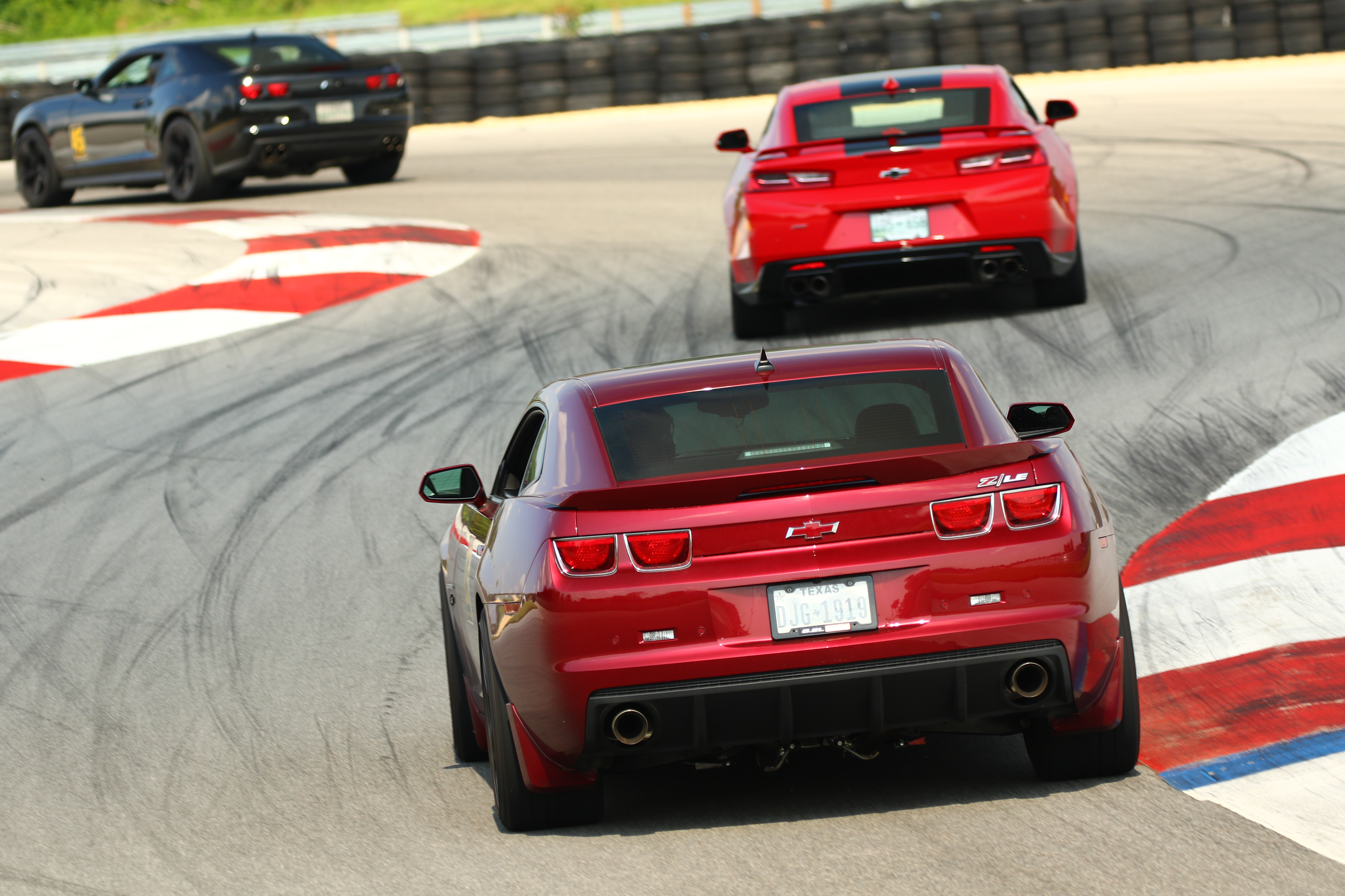

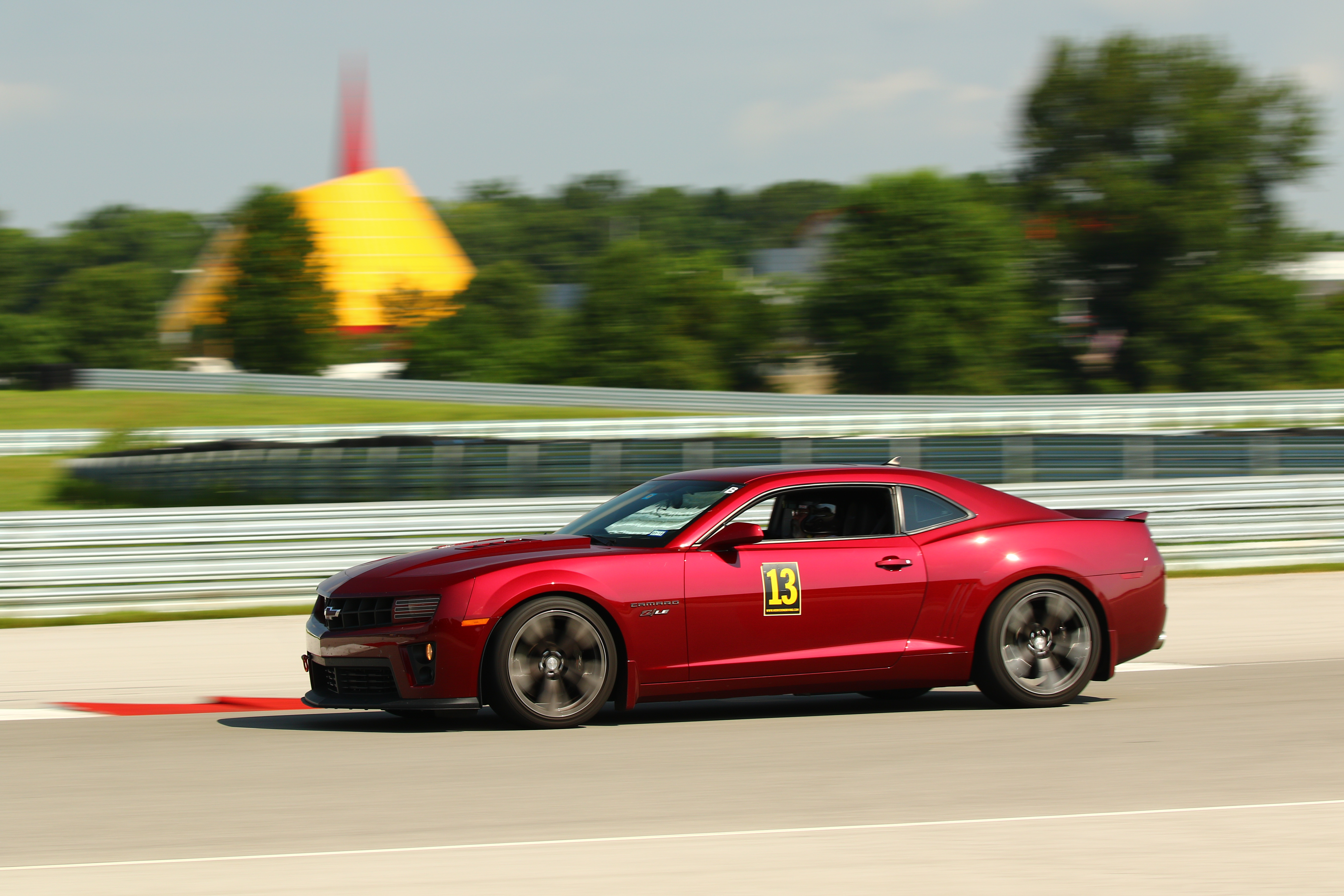

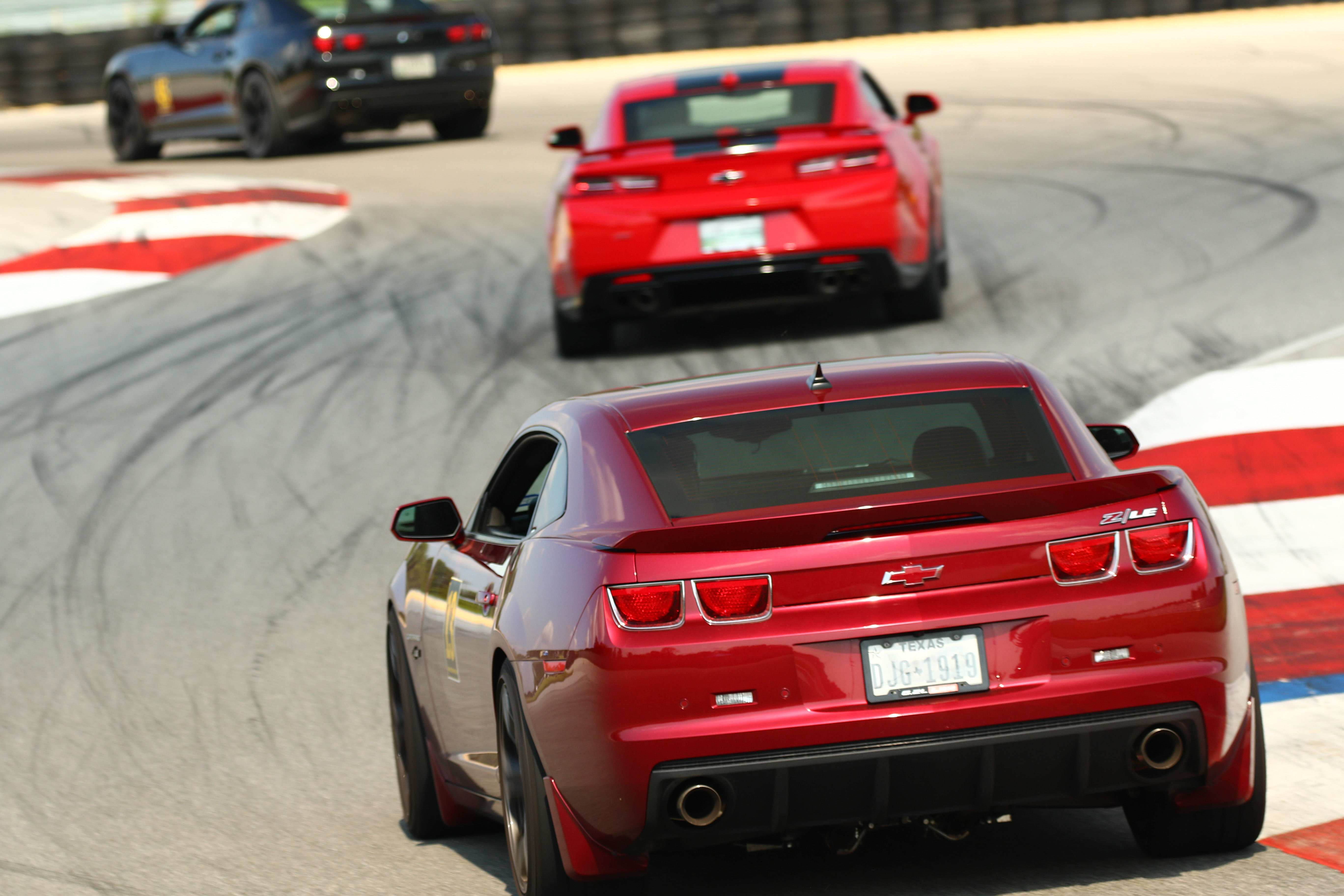

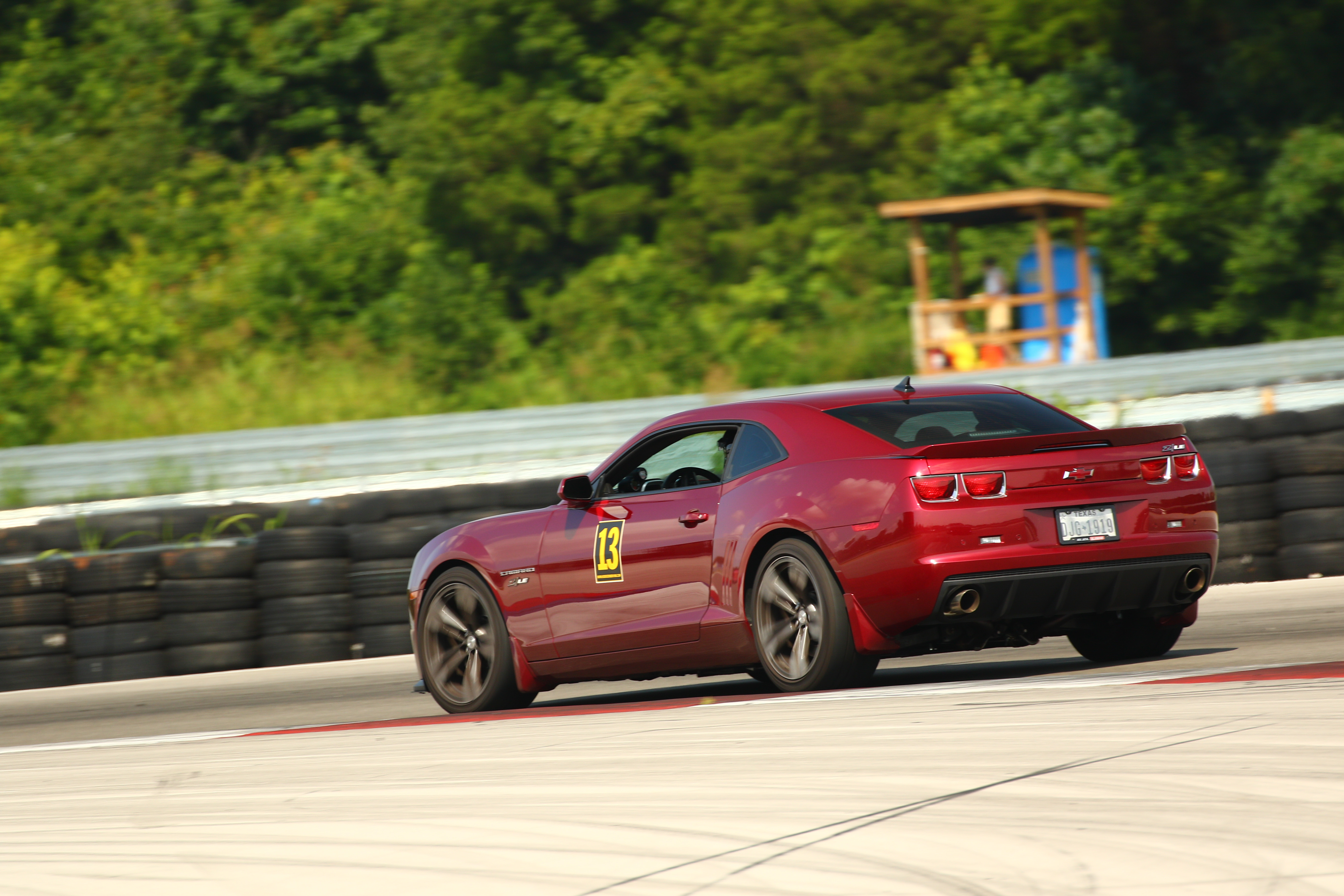

CamaroFest VII NCM Day!
Well, finally got some of my photos from ABIPhoto (Zachary) from my day @ NCM:
Yes, #13 (7/13 day of NCM CFest VII track day, and my birth day is 4/13 -- so its my lucky number)...
Check them out here (all from cfest vii):
http://www.abi-photo.com/camarofest
They did a fantastic job.
-Don

Originally Posted by ABADZL1 View Post
Nice pics Don!
Action pics! Glad I have some. The updated sway bars and Eaton really helped, car looks like the body roll was in check!
