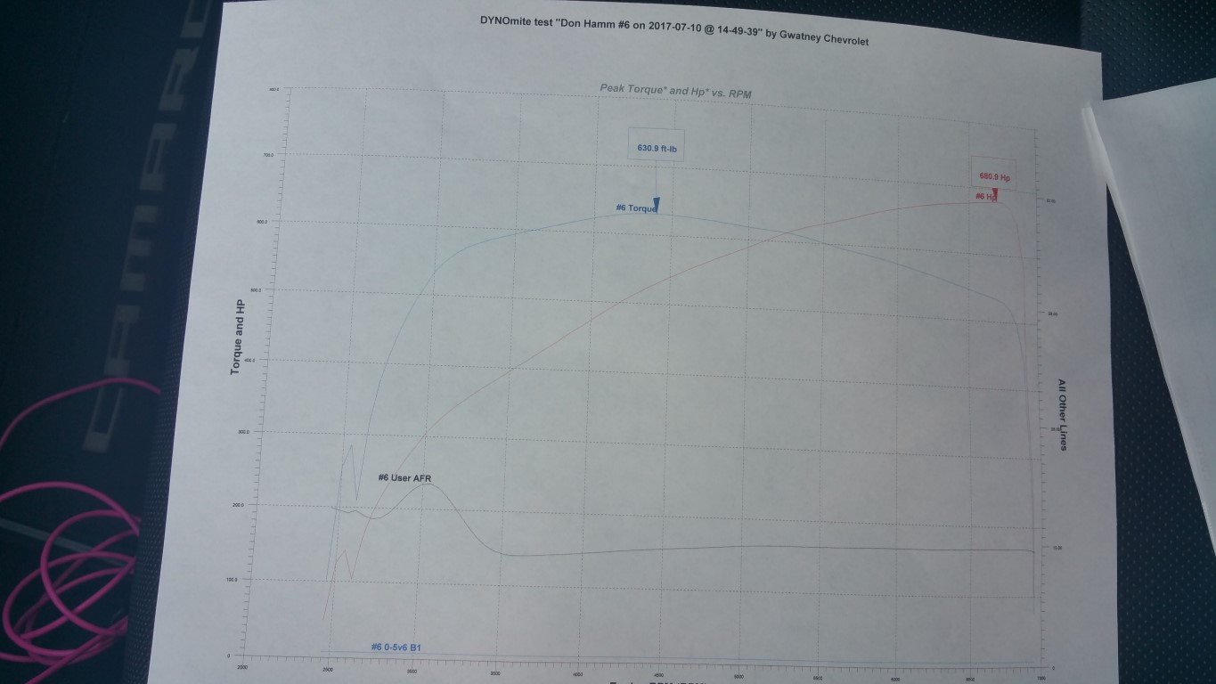

Ryan gave it a great run, and after all the heat soaking, here is the dyno (on 58-59% when we did this run -- imagine if it was 75%!):
Notice the #6? That was on pull 6 of the day and right after I fixed the spark plug wire!

747 RWHP 794 RWTQ

Very strong numbers, sorry you had a sensor go bad! That is frustrating for sure.

Spark Plug Wire
-Don
Just curious, what was wrong with the wire and what kind of problems did it cause while on the dyno? (Low hp or misfire etc.)Did it take several dyno runs to realize there was problem somewhere that made you look at the wires?

No, we were trying different things. On the 5th pull Ryan noticed a miss and power fell off. The last thing I did on the e85 update was pull that coil off to install the wire harness as it taps into the coil pack. That is where I looked first after it cooled down.
All the runs were adjusting for corn mix at wot. Once the wire was reinstalled, #6 run did it. -- really was heat soaked!
The whole point of all the pulls was to get a heat soak so we knew where fueling was -- remember, I was going to road race it and this was a safety factor..
