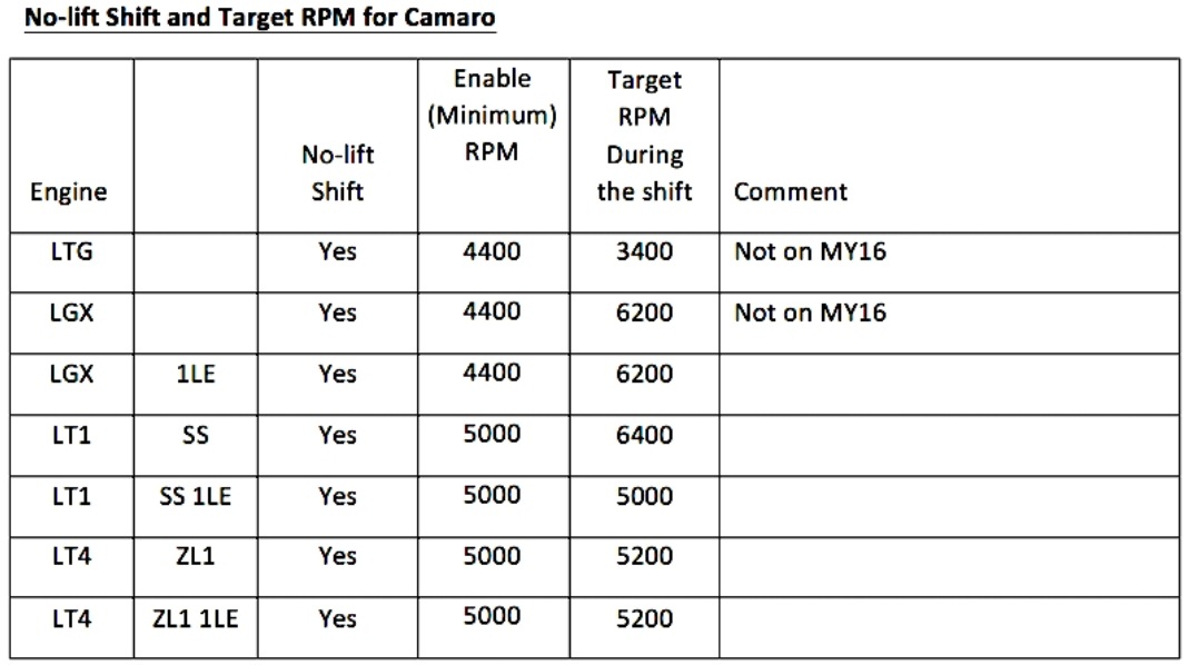

Originally Posted by Hostile_1LE View Post
I've tried using NLS recently on my '20 SS 1LE, and it seems it either doesn't work, or it goes to 6400 rpm instead of 5000. It feels like I'm doing a regular power shift with no rpm drop until I dump the clutch. Any ideas as to why it is like this?
If it goes to 6400 it's user error, NLS was not active. If you come off the gas just a little it won't work.

Hostile_1LE
Hostile_1LE's Avatar
Drives: 2020 Camaro SS 1LE | Satin Steel
Join Date: Jan 2022
Location: Lubbock, Tx
Posts: 359
I'm gonna try it again soon and I'll update on results, but just to be sure, I keep throttle matted with foot 100% off clutch, then stab the clutch and shift while keeping throttle planted?
Yes. The key is to not twitch that right foot. Any amount of throttle lift will defeat NLS and you can then bounce off the rev limiter (don't ask me how I know - ).

Originally Posted by DeuceCam View Post
Has anyone with a 2022+ model year LT1 trim confirmed that NLS is equipped? I tried it once on a 2-3 shift above 5k rpm but it didn't work and I hit the rev limiter (maybe I slightly lifted throttle?). I've been too timid to try it since
Guarantee you slightly lifted... that's all it takes.
Stand on it next time you can't hurt it.
