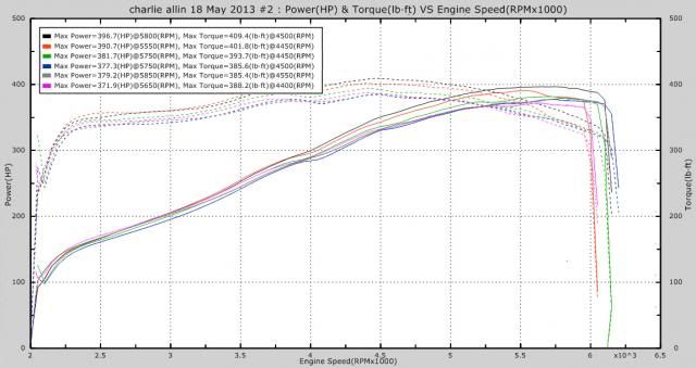

Dyno testing went well I suppose... The Cold Rush intake is showing appx. the same gains as it has in the past on a different dyno, so that's a plus. The "cold runs vs hot runs" really showed some surprising results. The "competitor's" intake managed to stay within 3 hp of it's hot and cold runs while the stock intake lost 7hp from the repeatable cold numbers to repeatable hot numbers, and the JF Cold Rush lost 9hp from the repeatable cold to hot runs...
Defining cold/hot: A new intake was put on cold. The car was started, and with the radiator fans hot wired on via the fan trick, the CLT was allowed to stabilize at it's lowest point with the hood open. Typically the CLT would get down to 199 before the runs were started with the exception of the last run which was the JF intake was started at 203 because it wasn't getting any colder, at the time the CLT was deemed at it's lowest point, the fans were turned off and the hood closed for the runs... For the "hot" runs, the hood was left closed after 3-5 "cold" runs (after a repeatable number was run), and the car idled for appx 5 minutes, when the "hot runs" were started the CLT was always about 216 +- 1-2 deg, then the car was run again until a repeatable "hot" number was run...
Unfortunately, I don't have the dyno sheets as the printer was not working as per my usual luck when I go to dyno something :( I'm currently waiting for the run files to be emailed to me, but im sure it won't be until Monday at the earliest now as I haven't received them yet. I do have all of the run numbers written down, just no curves.
Keep in mind, not only am I on a different dyno, but I've also added high flow cats, and a ported TB since my last time on the dyno, so the numbers won't really coincide with older numbers exactly since they are higher.
Stock intake runs
"Cold": 388 HP 395.3 TQ
"Hot": 381 HP 397.1 TQ
Brand X intake runs
"Cold": 392 HP 403.6 TQ
"Hot": 388 HP 399.8 TQ
JF Cold Rush Runs
"Cold": 409.0 HP 407.1 TQ
"Hot": 400.3 HP 413.4 TQ
Needless to say, it was interesting. I expected more of Brand X, but I find it hard to believe that the dyno, or the testing was being run improperly as I've tested my intake 3 times now, on 2 different dynos, with 3 different operators, and my outcome over stock has been about the same each time. This was the first and only time I have, or plan to run Brand X on the Dyno.
A note on these numbers, posted... Typically I will junk the high and low numbers, although in this instance the Cold Rush instance was a repeatable number so I kept it, the Brand X cold run "repeatable" number is less than shown, but I'm giving it the benefit of the doubt with it's highest run as I thought it would be more... "Hot" run numbers shows the highest run from two runs that were within 0.8hp of each other.
I will edit this once I have dyno charts to post.

So back to the most recent test... The numbers the dyno operator wrote down on paper were all mixed up, some were standard correction numbers, some were SAE, and some HP numbers were even transposed from the TQ numbers... I finally received the dyno run files and was able to look at them myself and make sure everything was right. Please disregard the previous numbers, and for those just catching up, I have already gone back and erased the previously posted numbers. All numbers shown in the following dyno graph are SAE corrected.
Runs #1 and #2 are the JF Cold Rush "Cold runs" then "Hot Runs", runs #3 and #4 are Brand X "Cold" then "Hot", and runs #5 and #6 are the stock airbox with stock filter "Cold" then "Hot"... 22 dyno pulls were made total, and these numbers shown were repeatable within 1hp or less both hot and cold.
So getting back to 60 mph winds vs a Box fan at the front of the car... I've done this 3 times, 2 different dynos, 3 different operators, I'm seeing appx. the same gains when comparing the JF Cold Rush vs Stock, untuned, regardless of which design revision I have tried... With a box fan. This test was run on 92 Oct E10 fuel out of the pump. The JF Cold Rush box tested this time was tested with Reflectix insulation available at Lowe's as the new mold for the silicone insulation was not finished yet for the larger airbox, which may have something to do with the heat soak difference, however, it's the first time I've tested "cold" vs "hot", and as I've always said, you can't escape the heat. So the results may be the same even with silicone box insulation... When the intake tubes were removed, the Cold Rush silicone intake tube was just warm to the touch both inside and out, where was Brand X was burning hot as has been previously mentioned by several people in the past during daily driving.
I guess the next step is to get the "production" Cold Rush intake to the Name That Intake! contest winner so it can be tested against Brand T(uned) vs Cold Rush tuned (if that's still a go)... Current time frame, is unknown but getting closer; the new box insulation mold for the larger air box is still being worked on, as is the "No-Tune" maf piece. The "Tune" maf piece mold has not even been started on and I'm still waiting for the prototype to be finished.
Thoughts?
