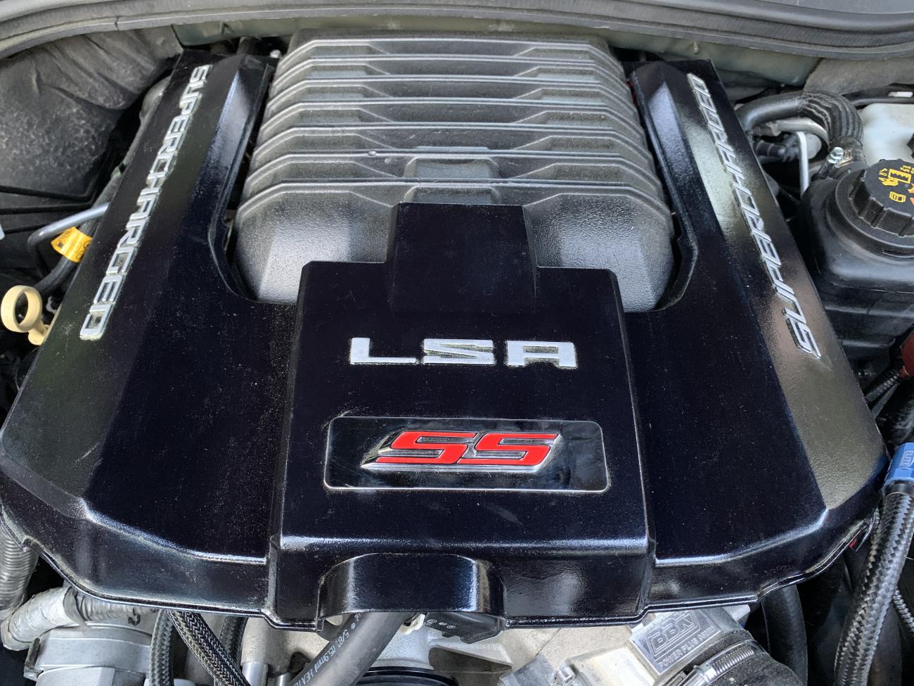

Hood insert arrived and installed. They didn’t make the bolts long enough on the drip tray. Not crazy about that, but otherwise it fit in like a glove and looks kick ass. Finally can fit my custom beauty cover. Gauge pod came to, but going to save wrestling with that for Saturday.

Forgot to post the pics
