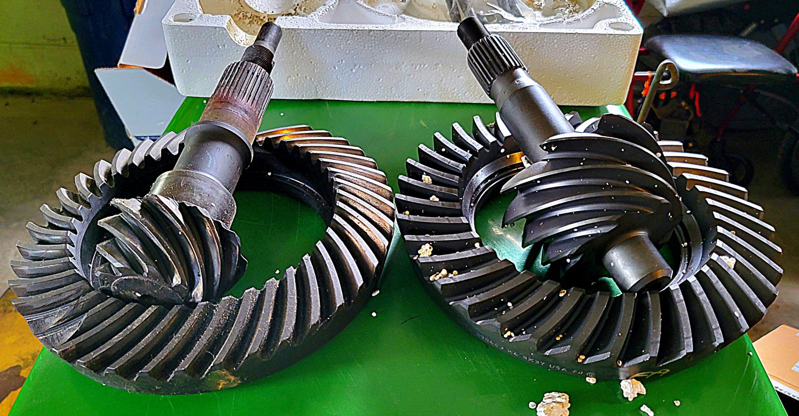

Great photos and comparison. It reminded me of a couple pictures this conversation may find interesting. On the left is the OEM differential, and 4.10 gears, and on the right is the G-Force 9" with 4.63 gears. The size difference of both the gears themselves and the assembly is pretty incredible. The weight too - the 9" added about 40lbs. The aluminum center would be lighter, but at this point we're going for ALL the bulletproof!

wow neat looking 4:63 gear
Yea, 9" gears are wild looking. They use that super low pinion position, which creates that high hypoid offset and really makes the pinion teeth long and twisted. Awesome for strength, undesirable for efficiency.
