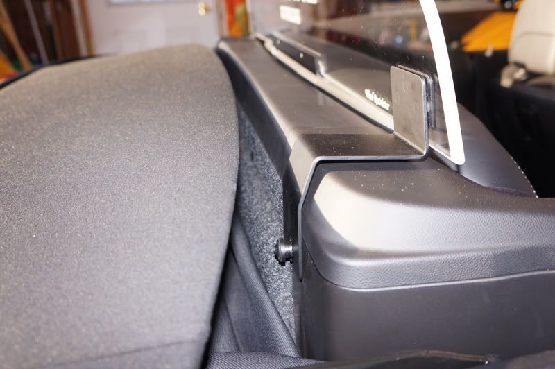

Ordered it from Apex on tax day and my shipping/receiving dept dropped it off at my desk an hour ago. So, like any self-respecting dude with the mentality of a 10-year-old, I immediately went out to my car to install it.
I use the word "install" loosely though. I got the non-illuminated one so it takes 5 minutes to do if you're being ultra careful. It includes a pair of white cotton gloves if you're paranoid about putting fingerprints on it. Not to worry though, they even thought to give you a spray bottle of cleaner with a microfiber cloth if you skip the gloves.
The only thing that bugged me putting it on is that when I tried to tighten the rear boot cover lugs back down, they kept spinning and spinning as if there was a nut behind it that wasn't biting down. I'll fiddle with it a little more when I get home. Speaking of which, I'm looking forward to the drive back to see how this performs moving. At least it looks cool stationary.
Some phone pics since I don't have my real camera with me:
More observations to come later tonight.... or over the weekend if the GF decides she wants to go out as soon as I get home.

"The only thing that bugged me putting it on is that when I tried to tighten the rear boot cover lugs back down, they kept spinning and spinning as if there was a nut behind it that wasn't biting down. I'll fiddle with it a little more when I get home. Speaking of which, I'm looking forward to the drive back to see how this performs moving. At least it looks cool stationary."
Its a bit of a pain in the ass but if you put a tiny open end wrench on the inner nut you will be able to tighten it down. Sorry it's been a few weeks since my install so I dont remember what size

I had that problem also when I loosened up the nut enough to slide the wind restrictor bracket down. The nut wouldn't tighten. It would just spin. You need to take a flathead screwdriver and wedge it between the bracket and the plastic molding behind it to pull the nut tight as you tighten the screw. That friction will keep the nut from spinning. Pull the screwdriver out when you feel it really grabs. Mine are really tight.

Thanks for the tips guys! I'll tighten it up tomorrow (spending the day w/ the GF). My observations of it so far...
It looks way cool. Because of commute traffic, I was only able to get up to around 50mph and I'll say that the difference isn't night & day but it's definitely noticeable. I have no doubt that on a 2-seater, it would be a night & day difference. Since it sits vertical and is glossy, you'll get a good amount of reflective glare depending on how the light hits it. Looking through the SS logo is bada$$, in your rearview mirror, it looks correct. There's a lot of wobble/play going over bumps, though that might diminish after I tighten down the bolts. I did notice that my top (I never use the rear boot cover) didn't flap around as much, so that's a nice bonus.
Overall, I'd say that if you're planning to buy this as a purely functional piece and thinking about the non-etched version, save your money. It doesn't make enough of a difference to justify the price. BUT, if you want it for a little bit of function AND want some cosmetic improvement, it's kinda worth it. Bumpers, grills, diffusers... they all cost a pretty penny, but this is one of those things that even non-car-buffs will notice. In the end, I'm quite satisfied with this addition.
