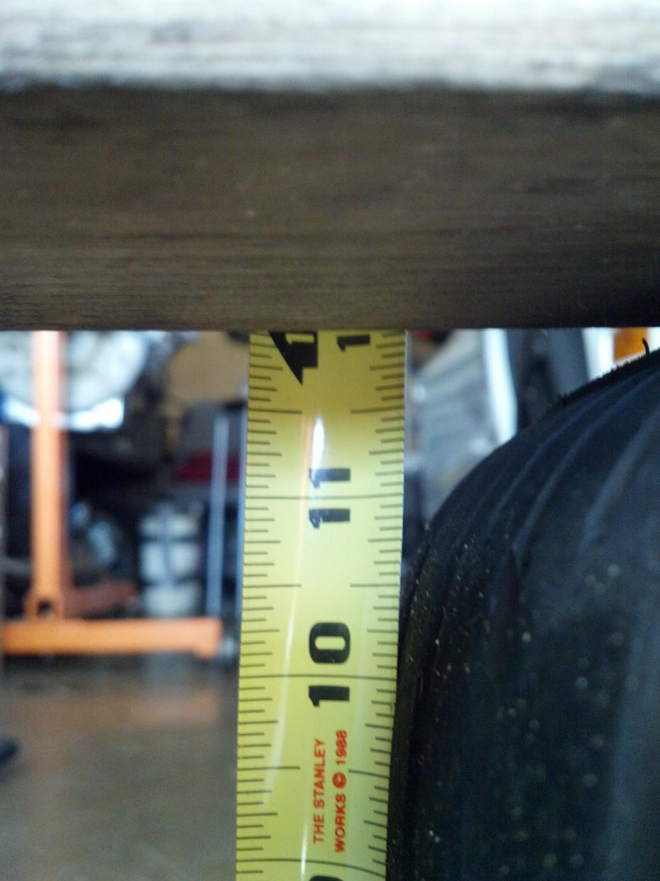

Here is the total width of the 285/40 18 on 18x10. It's just a hair under 12"

Originally Posted by grocerygetter View Post
Nice dude. Those tires are fat for 285s.
Yeah but what sux is that only 10" of the almost 12" of width is tread. There is 2" of sidewall bulge, 1" on each side.
The REALLY wide Michelin Super Sport 295s are just as wide but they are all tread and have flat sidewalls.
