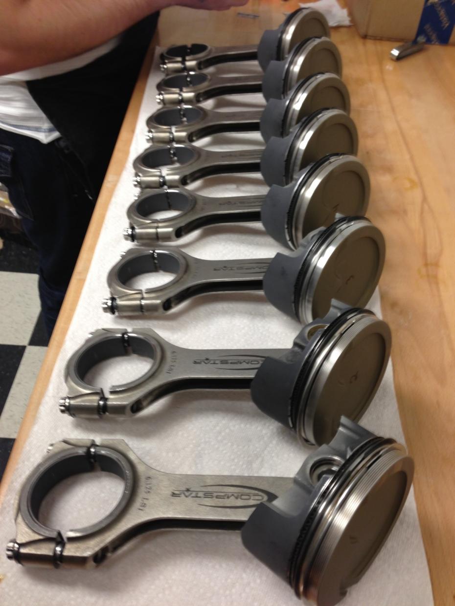

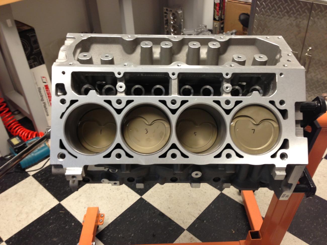

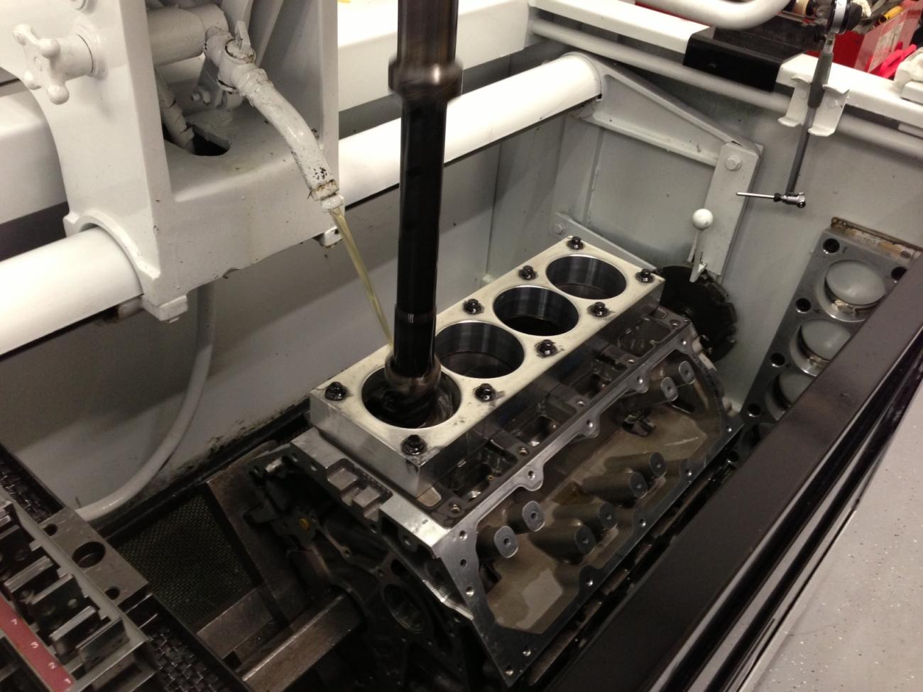

Round 8 - 416 the mistake I can't wait for...Mar 2013
I chose to take my engine to H-Squared Racing engines to have it rebuild as a 416 with:
  • Wiesco 15cc dished pistons
  • h-beam Compstar Rods
  • Callie's compstar 4.0" crank
  • Bore Engine and install internals - H Squared
    • ARP Head/Main Studs
    • LS9 gasket
    • Coat bearings, rod, main
    • Piston skirts coated
    • LS 7 lifters
    • billet double roller timing set
    • New higher volume LS4 Oil Pump
    • Brian Tooley Blower Cam
    • Iconel racing exhaust valves - higher heat
    • 3/8" push rod
    • Custom coolant bridge
  • Ported LS3 heads w/50 degree valve - flowing 345
  • Pfadt engine mounts
  • Fastlane custom rollbar w/removable harness bar
  • Tank Plates
  • 6 point schotch harness
  • McLeod RTX clutch
  • Pedders ZL1 front and rear sway bars
  • 10-rib pulley conversion - pricey!
Hoping to get motor back tomorrow!

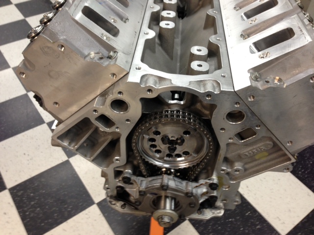

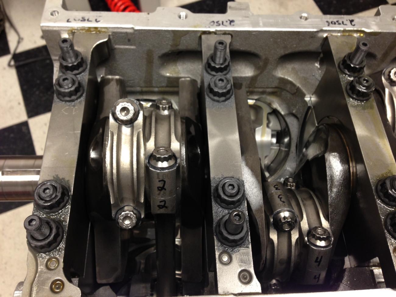

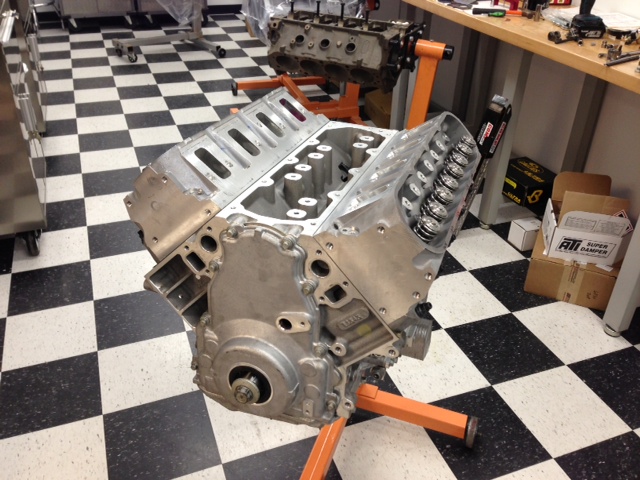

Took my engine home today!

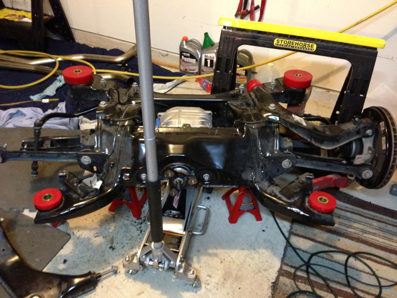

Was at H-Squared bright and early this morning to watch them put the final touches on my rebuild. Got the engine home around noon. Here a a few pictures at the shop:
Showing off the double roller timing chain, and new LS4 (high volume) oil pump. Also shows some of the mods on the front cover to fit all the new stuff in. The new 10-rib ATI balancer was installed at the shop to center up the front cover, but for some reason never snapped a pic.
PMJ is offline   Reply With Quote
Old 03-24-2013, 11:52 PM   #12
PMJ
Seeking 9s on M6...
PMJ's Avatar
Drives: 2012 2SS/RS LS3 aka "BlackWidow"
Location: Houston, TX

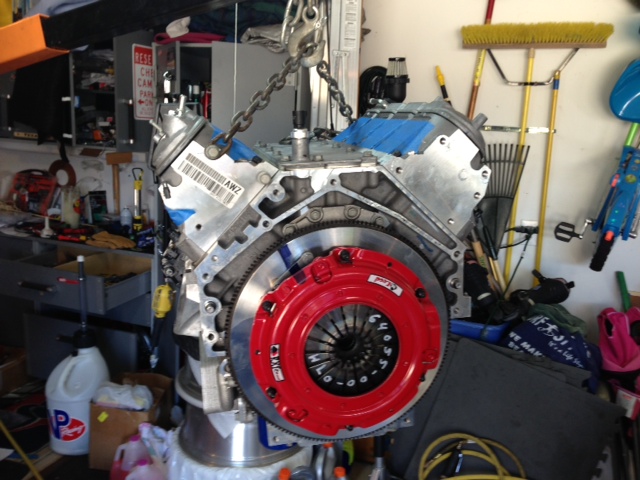

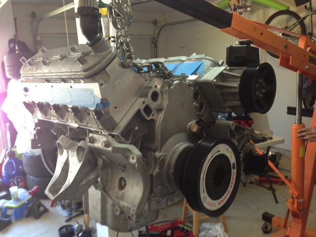

Posts: 397

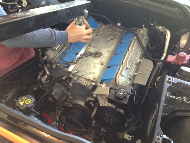

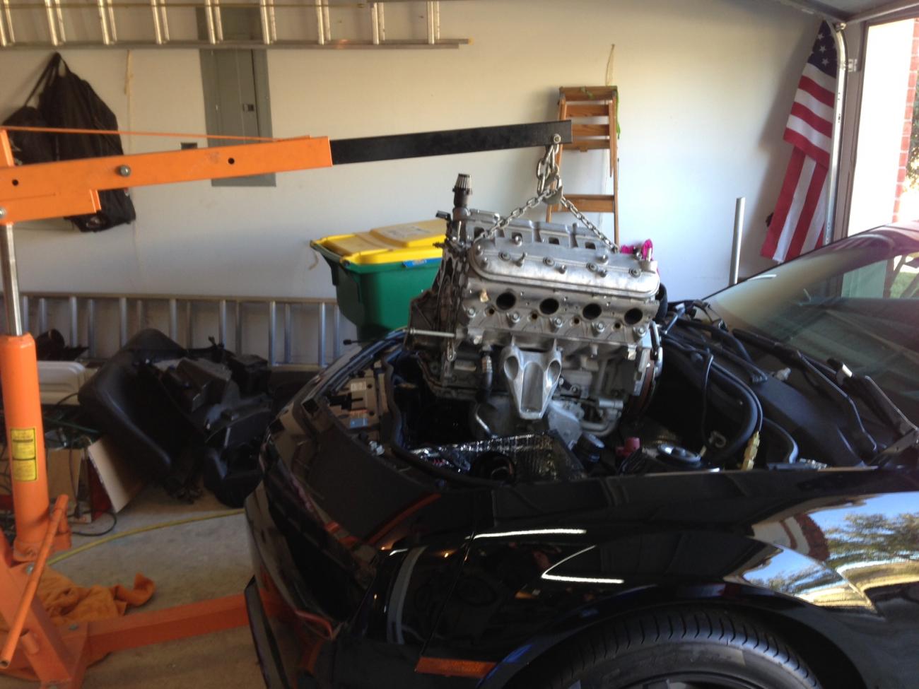

Install begins
Had my friend meet me when I got home and we got to work. About 7 hours later, we were done underneith the car (I hope). We installed the new RXT clutch, dropped the engine in, installed a tick remote clutch speed bleed line, reinstalled tranny, drive shaft, headers and exhaust! Attached most of the bolt-ons up top as well (besides the whipple and coil packs due to waiting on parts).
I'm currently waiting on push rods (custom size), and Kurt Urban LS Water Vapor System to bridge from all 4 corners of the heads vs. front 2 only. (will add pics when installed).
I had some issues w/the 10-rib pully kit...will follow up on that tomorrow. Removing the pulley from the water pump is a b!%^&. Still haven't gotten it off.
