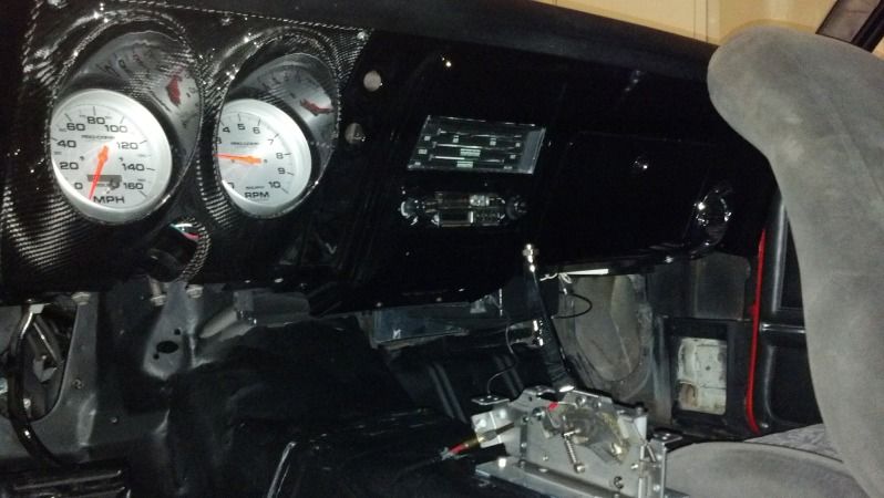

Here are a few quick pics of my 68' Camaro that I am just finishing up with a LS/T56 swap and had the interior redone (traded out work)
I used the factory 68 Camaro center dash panel with a aftermarket Metra single DIN mount molded it in and had a Local company here (Sin City Hydrographics) dip it in black carbon fiber, then used both 220grit sandpaper and scotchbrite pad to give the perimeter the "brushed" aluminum look to match the Twist Machine shifter handle for the T56
The center console is from a 2013 Camaro, but I took my old Autometer 4 gauge pod from the stock 68-9 center console and fab'd & molded it into the Gen 5 Camaro 6spd shifter bezel (had a tray with no gauges) filled in where the factory traction control switch went and drilled two holes for my heated seat switches
Then had the crew @ Sin City hydrodip them
The seats were recovered in black leather and suede by Jose @ ABC Discount Upholstery here in Vegas, he also did the console "pouche" where the factory e-brake would be

Looks great. How difficult was it to retrofit the 5th gen console in the first gen?
It wasn't too difficult at all
I did trim the front sides to "fit" the 68' dash better
just made a center and rear mounting bracket, once I located it where I wanted it to be

Posts: 288
Originally Posted by cruiser View Post
What is the brand of the seats in the 68?
They started life as new Hunsaker seats that I got fro a guy who was selling off his project car and parts
traded some work to a guy that owns a upholstery shop and had them recovered in black leather and suede
