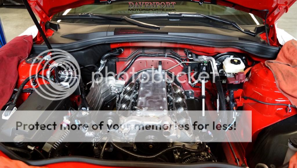

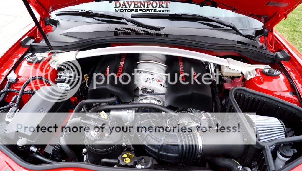

Modified our Z/28.
Drove it back from the dealer on May 22nd.
Dyno video.
Started modifying right away.

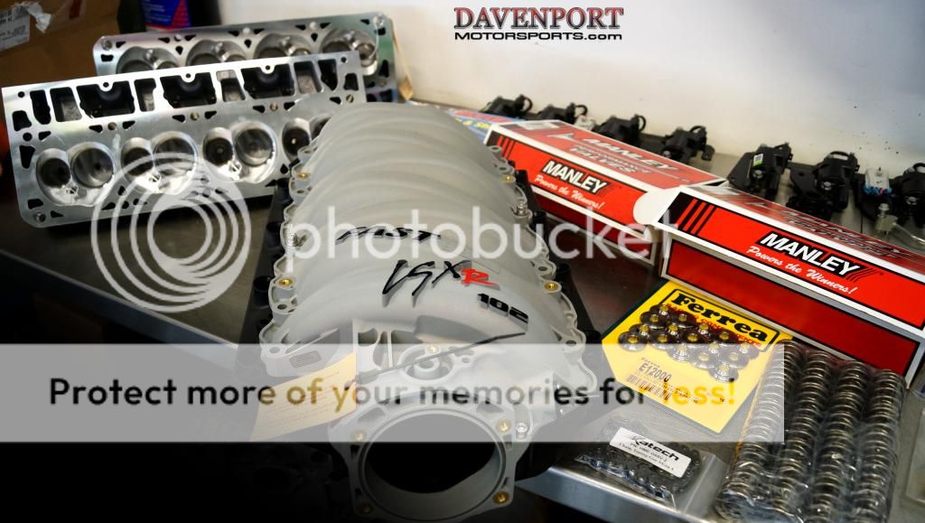

We installed BRAND NEW LS7 cylinder heads, CNC'd by our partners at LPE, then we are installing Titanium Manley severe duty Intake valves with Inconel exhaust valves. Stock head gaskets with ARP head bolts.
LPE GT19 camshaft, again all proven performance components that we have installed on Corvettes with the same engine.
And a C5-R timing chain again for added durability.
Along with a fast 102 intake, that will finish our initial package and will go on the dyno for tuning and calibration.
We also installed American Racing Long tube headers.
All dyno runs and numbers are with Shell 91 Octane fuel.
Cool project. Did you retain the stock catalytic convertors on this build?
2014 Z/28, White
"I wasn't asked to make it cheap...I was asked to make it FAST!" Mark Stielow, the new Z/28.
Zfatuated is offline   Reply With Quote

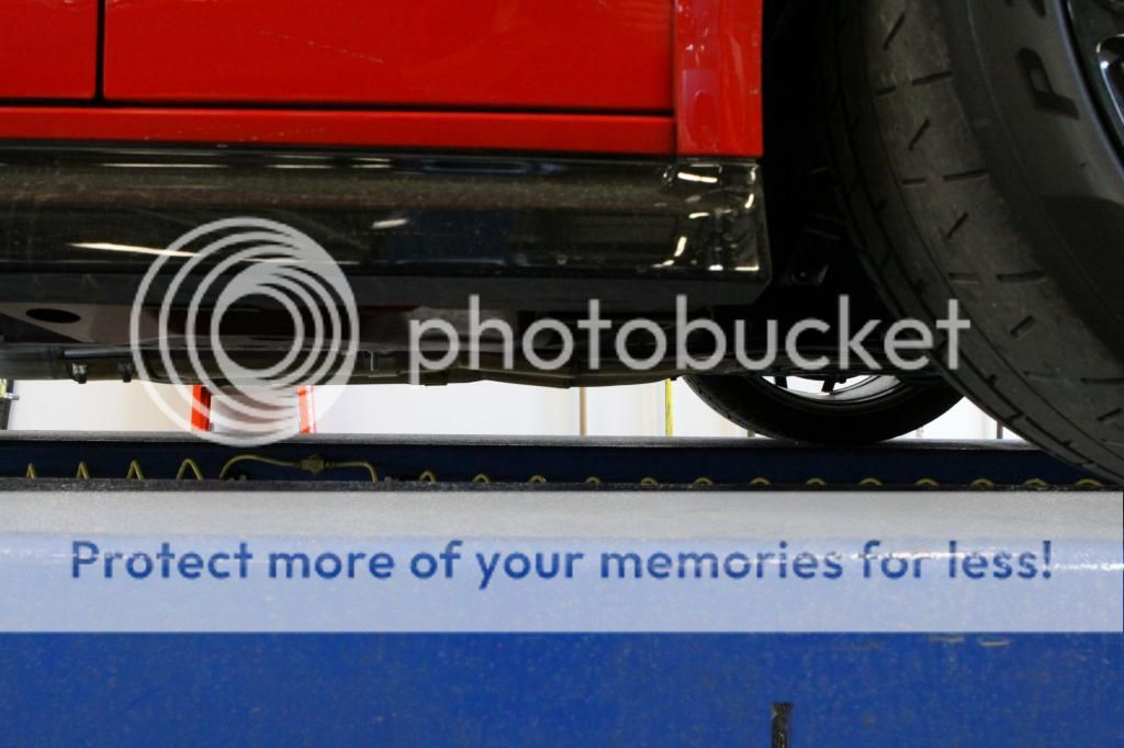

Nice work guys. Are you going to be driving her hard on the road course?
any chance you can measure the ground clearance from the ARH headers?
Moreno1 is offline   Reply With Quote
We had a customer come in, see it and say "I'll take it!" We said "It's not for sale" He said yes it is!
He's a great long time customer so we sold it to him.
We've got a black one on order but it won't be here till later this month or early next.
I'll try to measure ground clearance but It's barely noticeable from stock.
We put it on the drive on and I took a few pics for you.
Hope these work for you.
That's the front tire in the pic.
As you can see they barely hang below the front subframe rails.
Hope that helps.
Namala
