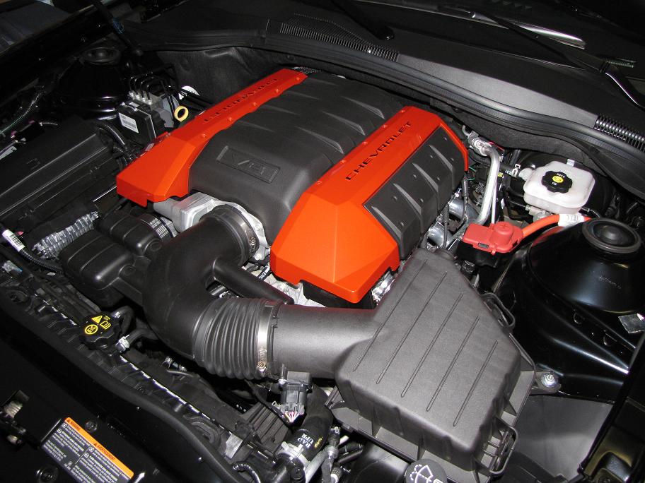

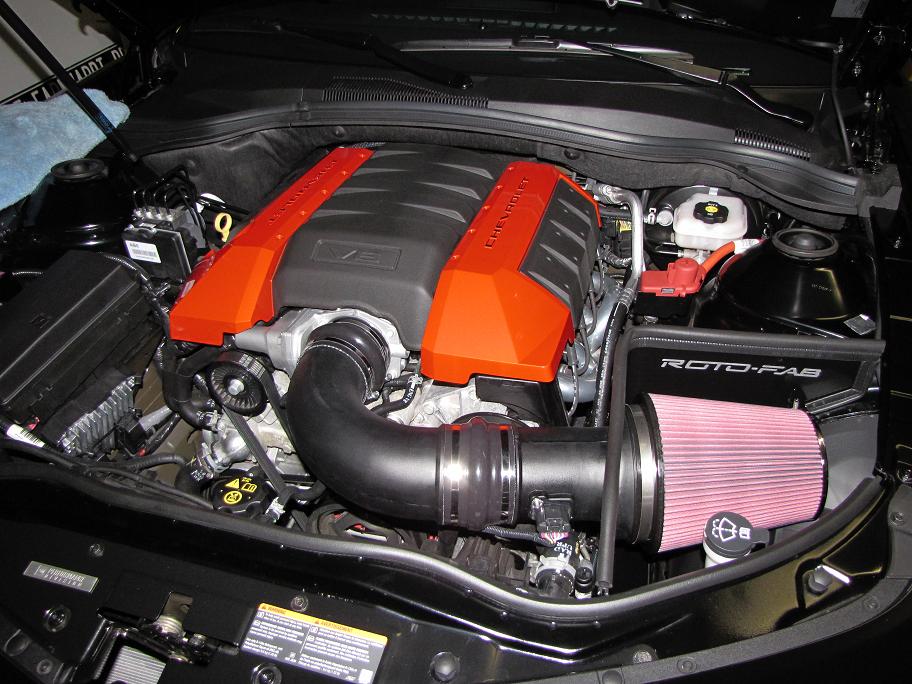

Now, I'm not gonna walk through the steps of the install, but Mike's directions are extremely clear and the install is almost intuitive if you just take your time and look at each step before you start throwing it on the car.

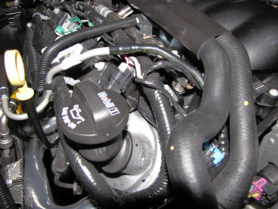

The only snag that I had was in getting the breather tube to release from the barbed fitting at the passenger valve cover. This is where Mike helped me out. On my particular car, I had to rotate the tube counter-clockwise 180 degrees to be able to see the small tab that has to be pushed to get the assembly to release from the barb. I took a close-up that you'll see when you scroll down. After talking to Mike, we think that they must not all be installed in the same position at the manufacturer. They only anticipate them having to be pushed on one time. Removal is someone else's problem.
As you can see, I opted for the black Air Box. I think this kit looks like it could have been a factory install.
