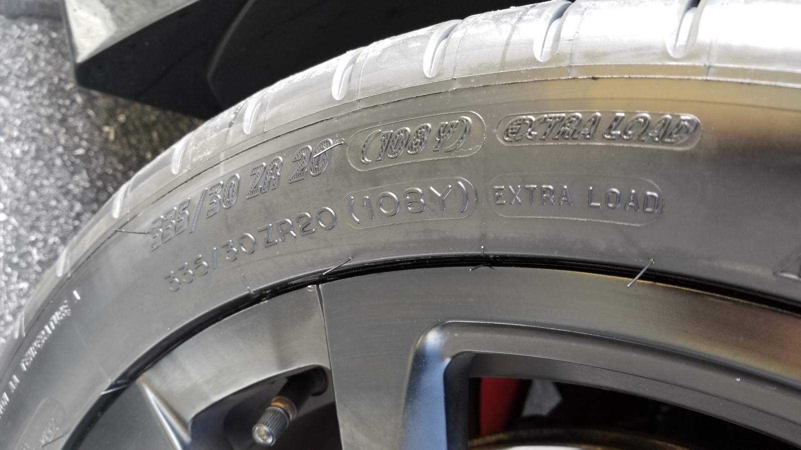

Just confirming what guinness2 posted years ago.....
Michelin 335 30 ZR20 Pilot Super Sports WILL FIT WITHOUT ISSUE on a 5th GEN with factory ZL1/1LE rear wheels
No rubbing. No nothing. No issues

Originally Posted by PK Auto Design View Post
Very nice, looks like a small bit of poke but thats a lot of meat on the back.
Yeah thank you. You're right. You know what i did notice though? The OEM 305 35 20 GY Eagle F1s had like a small lip around the outside circumference of the wheel that would stick out almost a 1/2 of an inch passed the width of the wheel and then tuck/taper back in. The MPSS's when we measured them had just about that same lip sticking out past the wheel width but instead of tapering back in, it was square flat till the tread itself
Its very minimal so i know maybe some will mind that and i respect that but it didnt bother me at all so i posted it just in case anyone was wondering..... 335 30 20 MPSS do fit on factory 11" rear wheels. Confirmed. No rubbing. No nothing. I havent had the chance to push the car hard yet except for a few spirited accelerations without T/C off a dead stop that felt pretty confident

Originally Posted by gm2376 View Post
question for you....been gone for a while, but I was looking at adding the zl1 10 spokes with the 305/35 and 285/35's. I do have pfadt springs, which lower it about 1.25 inches. Do you think there will be any significant rubbing?
You'll be fine. I run 285/35/20's at all 4 corners and I'm lowered ~1.25-1.5" on Hotchkis springs. They've never rubbed.

Originally Posted by its Sparkyyy View Post
What size are you running in the front?
285 35 20 in the front
they're the exact overall diameter as the 335 30 20 in the rear
