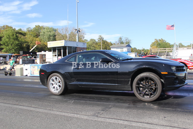

Hey Guys, this is my first post here so go easy on me haha. Just purchased my 2010 Camaro SS manual last week. The car is all stock and I'm still getting acquainted with it. I plan to do headers, cam and clutch this winter so I wanted to race it for a baseline before mods. I wanted to use the launch control in comp mode but with clutch to the floor, there is no rev limiter. It tachs out and doesn't go to 4200 like it should, am I missing something? So I turned traction control off, I started off with soft launches and would get some bogging when I let out the clutch too early. I aired the tires down to 26psi and practiced launching at 2000-2500, I had one good launch and then I kept blowing the tires off. I cant hear the car with stock exhaust so I was spinning and then by the time I realized it and let off it was too late. My best time was awful, 13.56 at 107 with a best 60' of 2.2. Clearly I need to work on my launches and possibly replace the original tires. Anyone have any other tips for me besides seat time and any ideas as to why my launch control doesn't appear to be working? Thanks in advance and props to the guys running 13's and below on these stock, not as easy as it looks!

gotta get DR's...seat time...is car tuned? not sure about the lc prob..tried mine once...now its all nannies off...good luck!
