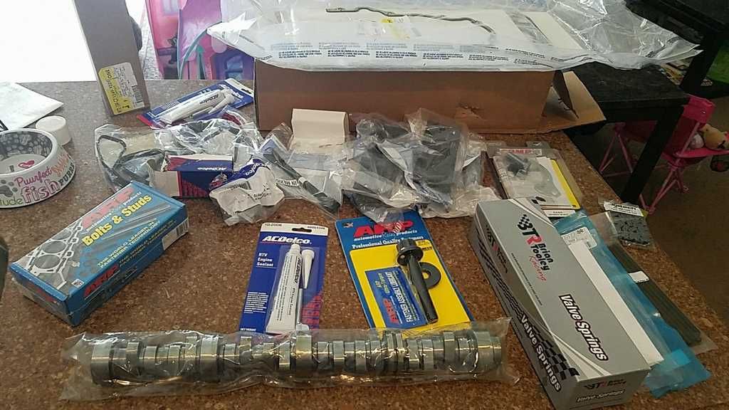

A few pics I took along the way...

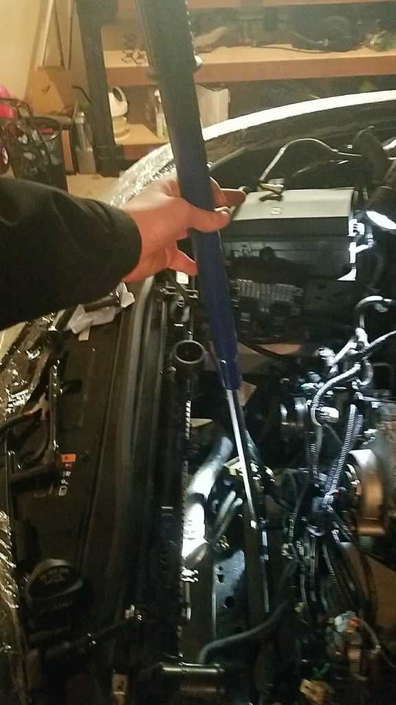

My wife was very "surprised" to come home and see our kitchen counter cluttered with car parts haha
[IMG][/IMG]

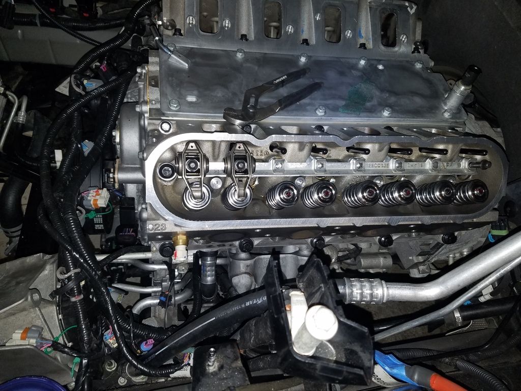

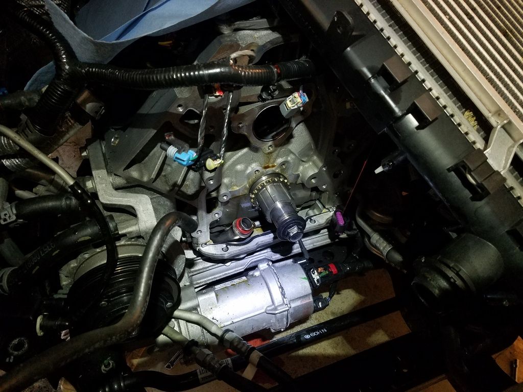

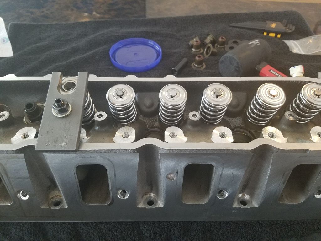

Had to pull the heads to swap out lifters since I have a L99.
[IMG][/IMG]

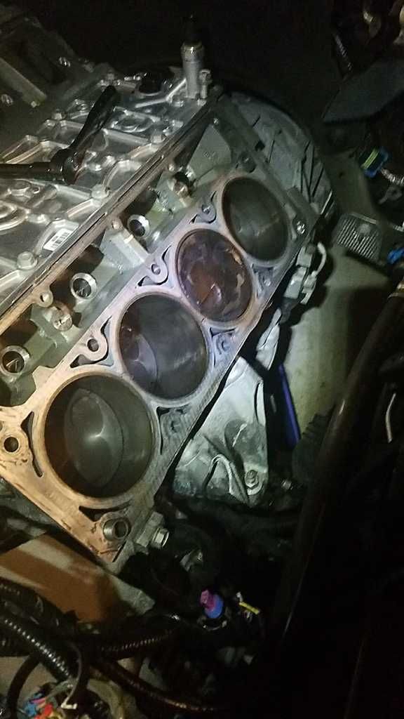

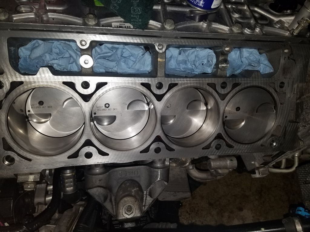

Figured I'd clean the pistons since heads were off.
[IMG][/IMG]
Pulling and reinstalling the balancer sucked...
[IMG][/IMG]

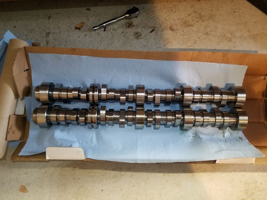

Out with the old in with the new!
[IMG][/IMG]
[IMG][/IMG]

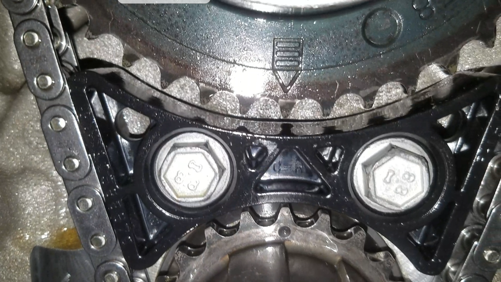

New K5 chain and dampener. Timing realigned
[IMG][/IMG]

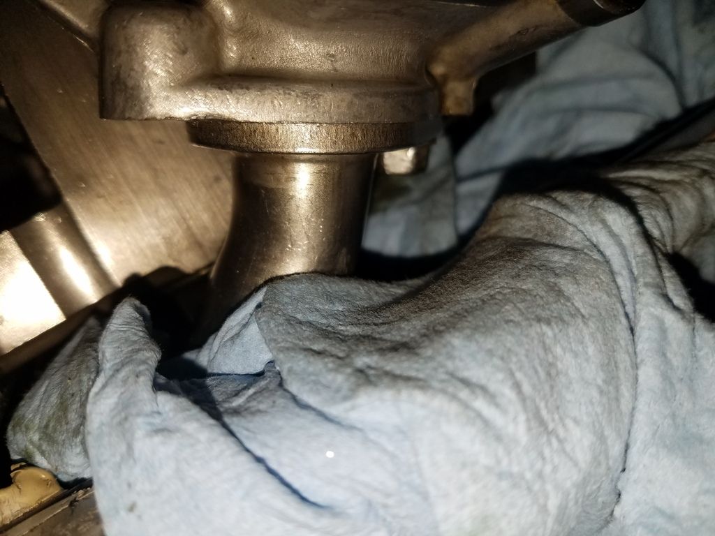

Ughh...my oil tube/pump gave me so much trouble..

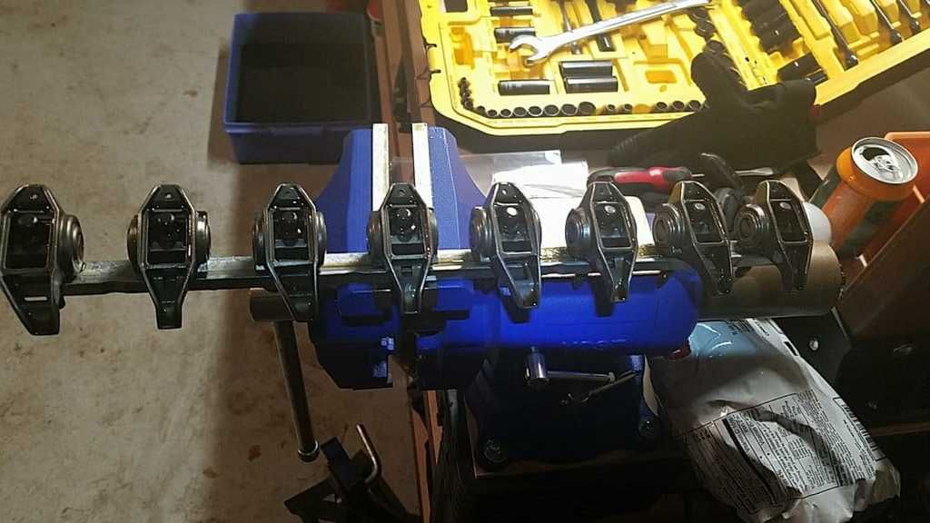

CHE trunnions going in!
[IMG][/IMG]
Installing new BTR 660 springs
[IMG][/IMG]

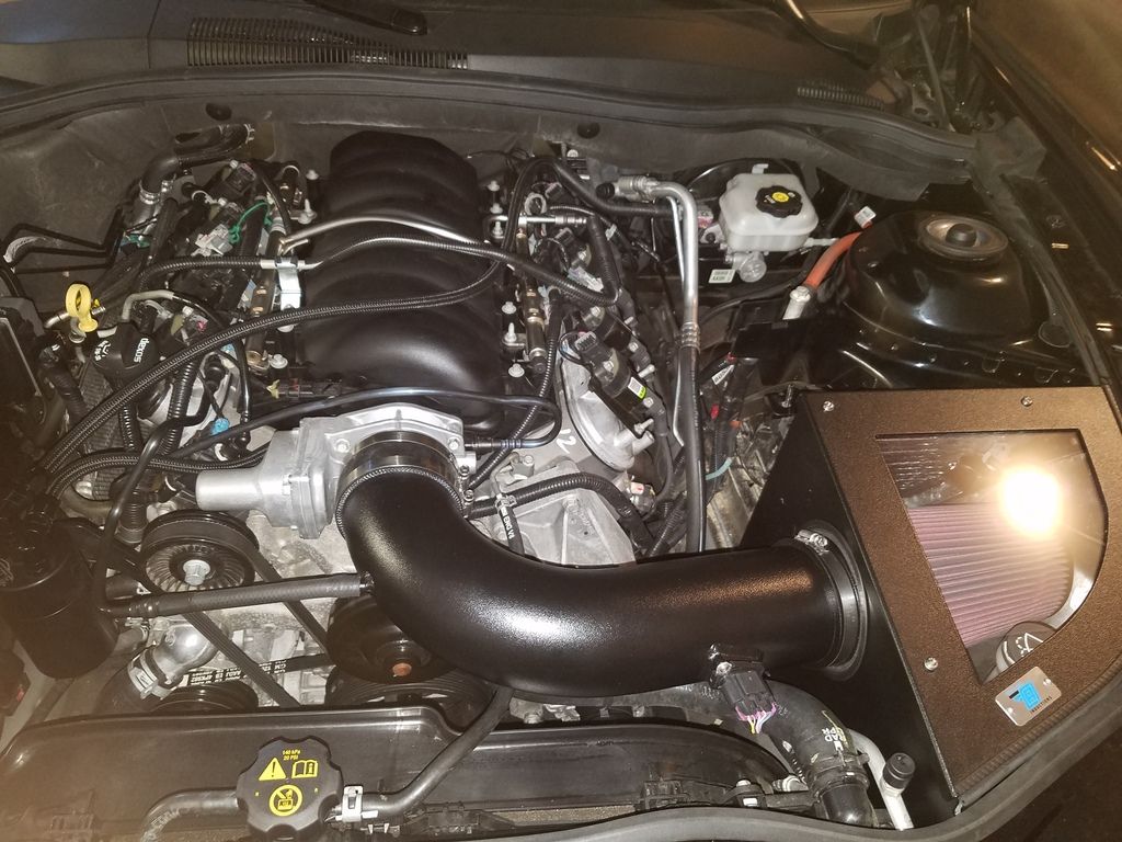

Everything re-installed and squared away!
