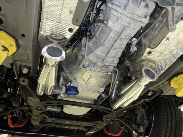

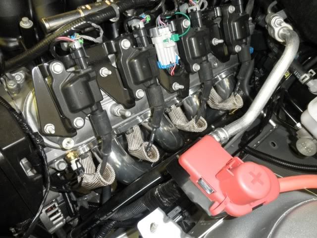

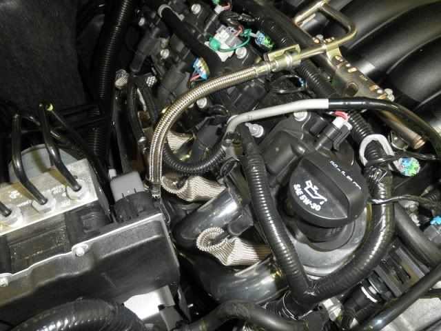

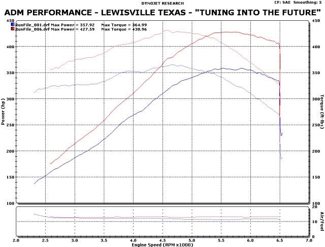

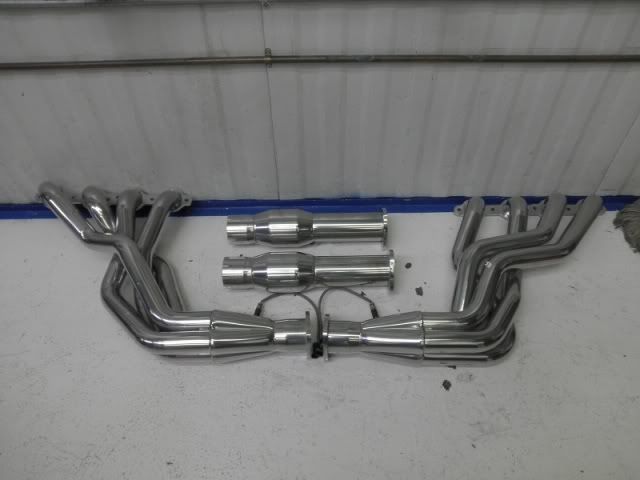

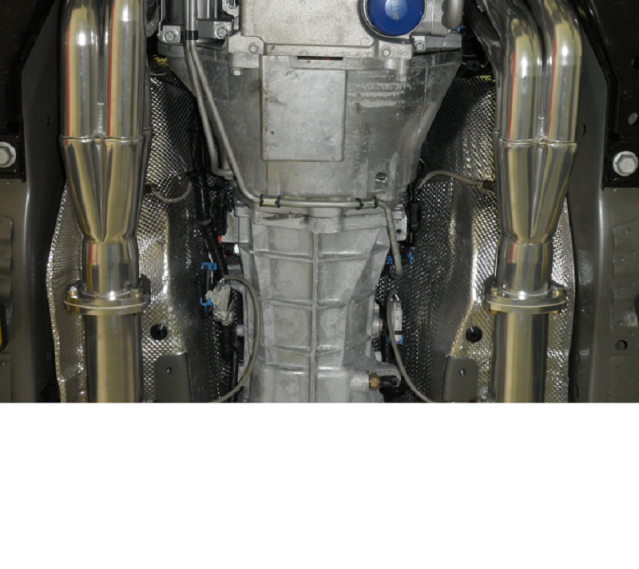

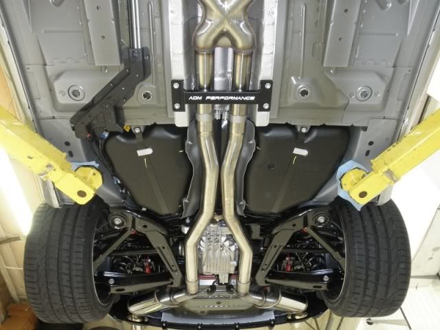

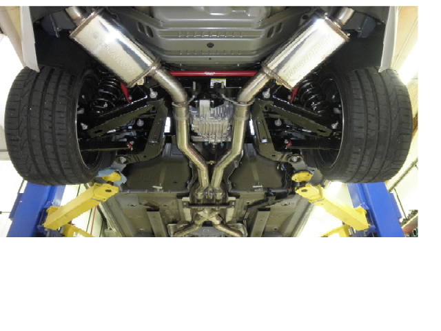

Equals unreal Horsepower and Torque gains! Unreal what I saw today from a 2010 Camaro LS3... the car came in stock, had the 2" ARH headers installed, along with the ADM Performance Tune and the ADM Performance Highflow Race Cold Air Intake and MagnaFlow 3" (part no 16483) exhaust system. Also, the customer opted for Ceramic coating, ADM laser cut flanges to be tig welded for optimum sealing and fit.
Baseline: 357.92rwhp and 364.99 lbs-ft of torque.
Final Dyno: 427.59rwhp and 430.96 lbs-ft of torque.
What a difference a day makes!!

OK guys, it was my car today at ADM. Andy spent all day working on the installs. What a surprise to me to go from 358 base pull back in August to what happened today. 69 rwhp gain and 65 tq. The first pull with no tuning and after install got to 416 rwhp which surprised me. I was going to be happy to be close to 405 rwhp. Also, Andy did a fuel-rail mod along with rerouting my heater hoses out from over the intake manifold and removing unwanted heat and really cleaned up the clutter over the motor. Another customer was there and did a video of the dyno pass and said he would post it later today when he had time at home. Would I do this again? Yes, in a heartbeat. The best money I could have spent on gaining power. I am a happy guy.

Torque looks pretty good. Does this bust the myth that larger primaries on the headers reduce torque? Awesome work Andy!

If I'm reading this correctly, these numbers are with stock heads and cam...
The LS3 is really a monster!!! Great gains!!!

Nothing on the engine openned, YET.
