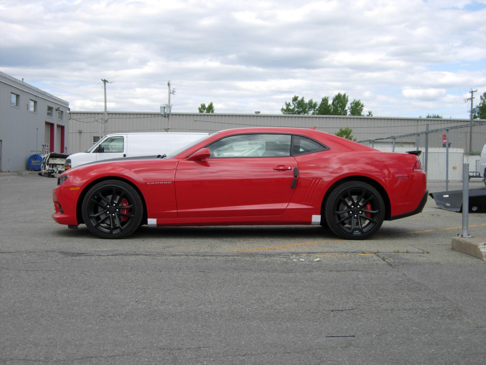

I have searched through the 1LE section looking for an answer to my question but have not had much luck
I want to lower my car a little and have 305/35/20 on the back and 295/35/20 on the front. Has anyone else with this tire combo lowered their car and if so were there any rubbing issues. The pics are how the car sits right now, I know in the pics the gap does not look that bad but it could stand to come down a little when you see it in person
Maybe an inch of actual drop would be perfect
Thanks

I lowered my 1LE with BMR 1.25” springs and I have 295/35/20 nitto invos
Love it !! So I’m sure you can do 305/35/20 on back ..

I have the Gen6 1LE wheels on my car. Same offsets (ET43, ET23 front). I have 305/30/20s on the rear. Fit fine with -1 camber, but tight, about 1/2" clears with top of tire and wheel well. 1" drop springs.

i installed , bmr 1''drop coils.
if you compare pics when new @ dealer & after.. it shows. and i love the stance it's just enough for me.
rear is 305's -35.-no rubbing -
if you go 1.25'' it will look even better. just a tiny bit i would of take it.
