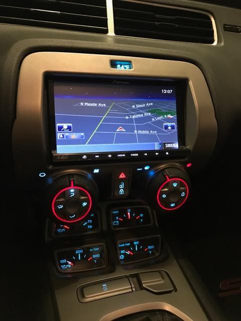

Side note looking at the Sony XAV-9000ES - I can see that the screen somewhat comes out or pops out, which is pretty cool because if you look back at the PAC kit, the screen is recessed inside of the kit itself. Take, for instance, this review - taken from Amazon.
This person is using the Pioneer AVIC-Z140BH although it had a 7in screen it did not fit. So that is also my worry as well.

I have had the exact system you’re considering for several years now - PAC with the Pioneer DMH-W4660NEX - and it’s been great. The only problem is that it started a spiral of other purchases - rear camera, new front speakers, new amp, and the best of all, a power sub. I haven’t touched the rear speakers because I like a front stage plus they’re supposedly a pain to replace. Each item I added made a nice noticeable upgrade in sound and the wireless CarPlay is awesome. I went with PAC because it comes closest to stock look, especially when I did it a few years ago.

Yeah it’s so weird, like I want it to look stock still, but upgraded. And I feel like adding just a double DIN in there with a radio doesn’t do it justice, I went with both those suggestions because I personally feel aesthetically it looks pleasing and techwise it’s wonderful
