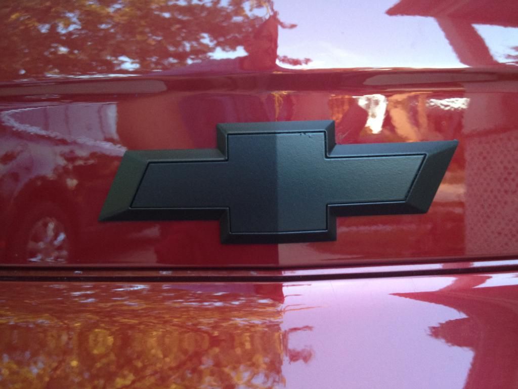

I wanted to blacken my bowtie and see how it looks. Did not want to paint it, as I wanted to be able to come back if I didn't like it and didn't want to order things online or use vinyl which can peal off fairly easy. So I Used Plastidip.
For those who do not know what this is, it's as easy to apply as your can paint, has a great Matt finish to it, if you do not want it in future, you simply peel it off!
Parts/Tools Needed:
Plastidip Can ($15...only need 1/10th of can)
Painters Tape ($1)
Newspaper or garbage bag ($0)
Blade/Knife
STEP 1:
Cover everything except the emblem. Use the painters tape and your newspaper/garbage bag. You do not need to cover the entire car, however, take precautions similar to you would with a paint.
STEP 2:
Paint. I did 4 coats, each coat with an interval of 5 minutes (the can said 30 minutes, but 5 worked just fine with me, I don't have that much patience). End result was perfect.
STEP 3:
Peel off the plastidip from the area you do not wish to have it on. In my case, I wanted to keep the chrome portion. I used a knife/blade, to make a cut around the border of the bowtie and simply peeled the rest off.
STEP 4:
Admire your final product. Repeat the same process for back Bowtie as well.

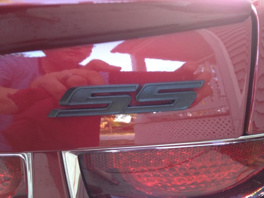

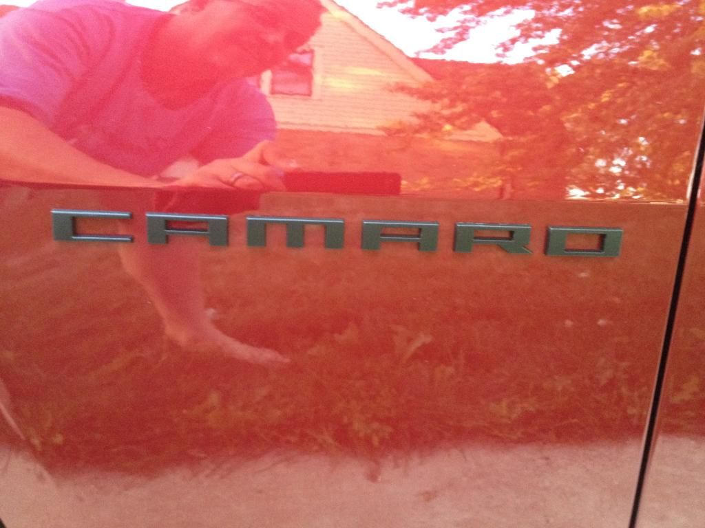

Well, after reading tons of threads and watching videos on Plastidip, I jumped on the bandwagon. Here are my first attempts. Plan on doing the wheels this weekend!
I have to say, the first time you pull the trigger with the can pointed at you car is a little nerve racking. Now though, I want to dip everything! Its addictive

Nicely Done!
I did that to my car the first week I had it. I also plastidipped the emblems on the side. I have pics up just dont know how to post them here if anyones interested to see how it looks. Also you can get plastidip at home depot for 5.99 a can. I am planning on plastidipping my whole care once i get the money saved up. Have fun but be careful its extremely addictive. I have plastidipped almost all of my friends emblems/logos on there car.

Using PlastiDip, you actually intentionally overspray about an inch around the lettering and tape off outside of that area. Once dry, you simply peel away the overspray and it etches itself around the letting leaving only the letters coated. Amazing stuff!!
