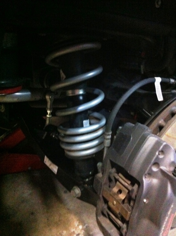

actually the confusion is from us wanting to skip the step of setting the ride height if we don't have to.
So he made the decision to install them the way they are since he really want' his car low.
if it's too low he'll remove em and set the ride height a little higher.

Its easier to LOWER the car once they are on, VS trying to raise it.
Damn dont have any of my install specs when I did my XA's...All at home somewhere...But, looking at the picture above, there should be about the same about of space between the height adjustment ring and the lower lock ring for a 1-1.5 inch drop. Ball park...
I'll look for my specs when I get home.

Hey I didn't tell him how to fix it.... In fact I told him the tire and the fender are supposed to touch .... it helps prevent body roll...
Didn't work smarty.
Originally Posted by Dr Jkel View Post
Less air = Less bounce as well
So drain the air from tires.
Originally Posted by 600hp-lpe View Post
Maybe... but once you put the preload in, there will be room, as the bottom spring perch moves up.
He still hasn't set the ride height either, which may give more clearance between the rings.
My confusion was that the spring, even with the bottom perch rings all the way down against the ride height ring, gave the spring tension. Right now, as we speak, I hammered the lock washer to the bottom perch and left very little space. I basically had to end up with more that what would be 3 to 5mm worth of compression. So I could have some space at the bottom. It worked out.
What spurred the confusion was I was supposed to screw the retainer nut down finger tight and I was getting compression in the spring doing it finger tight. Wasn't sure at that point if I was supposed to bottom the nut out (which you do) or just finger it till you get spring compression.
Once I knew wht the deal was, I just took the chance on the ride height and measured both spring perch gaps for each side and made sure they were equal. Did the same for the rear.

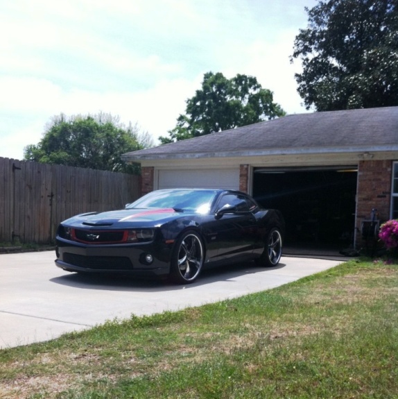

Actually maybe only half inch back quarter inch front.
Here are some I took earlier today.
STIFF STIFF STIFF.............. I love the ride.

And here's one just for you Chris......... I did it......
