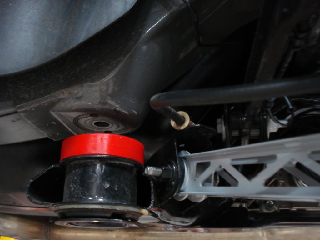

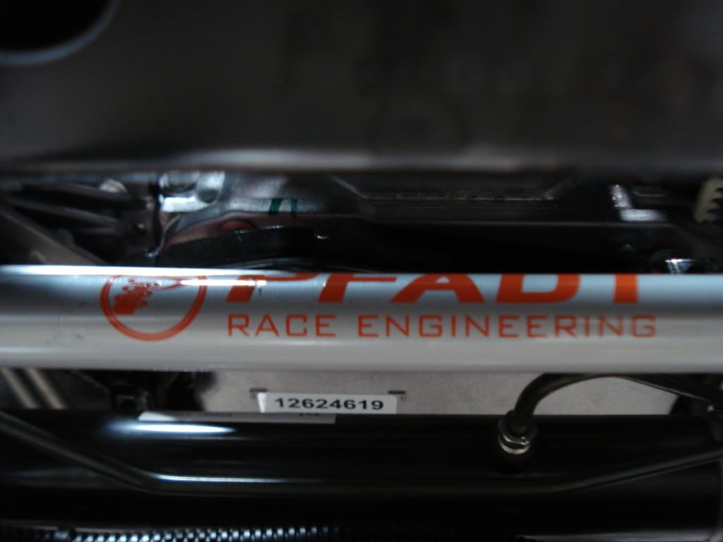

  • Pfadt racing sway bars, trailing arms, and Jet Hot coated strut tower brace

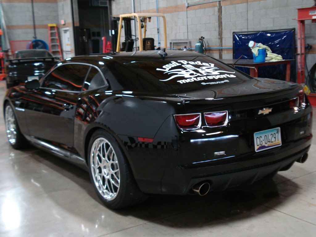

Here she is fresh off the showroom floor

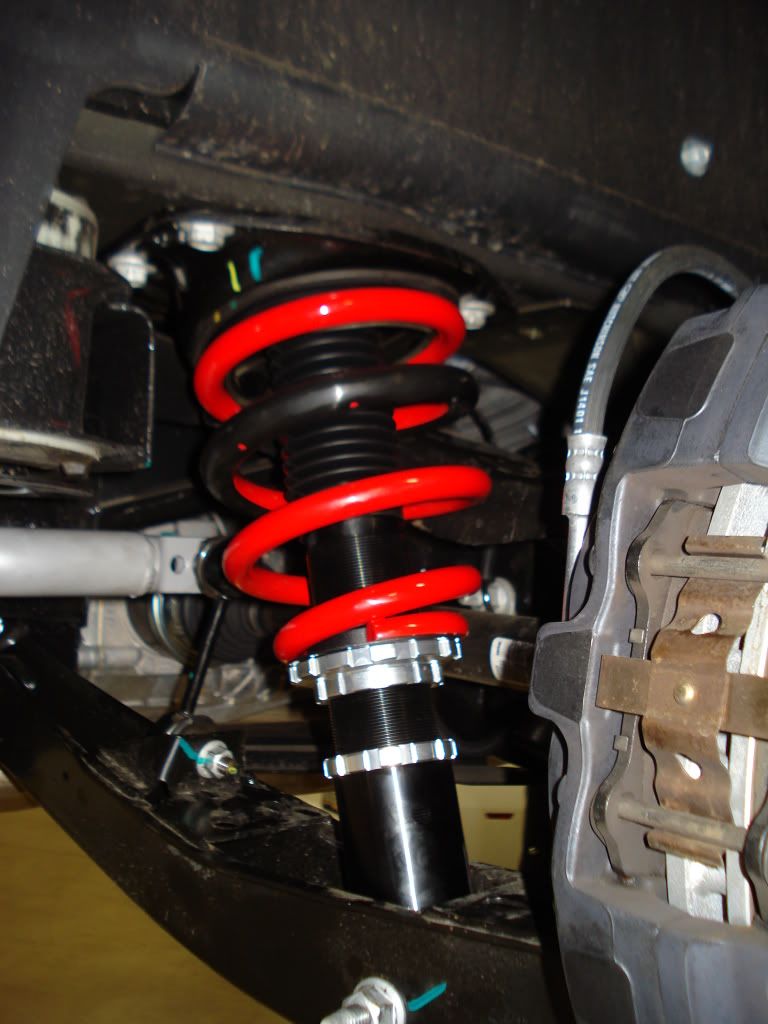

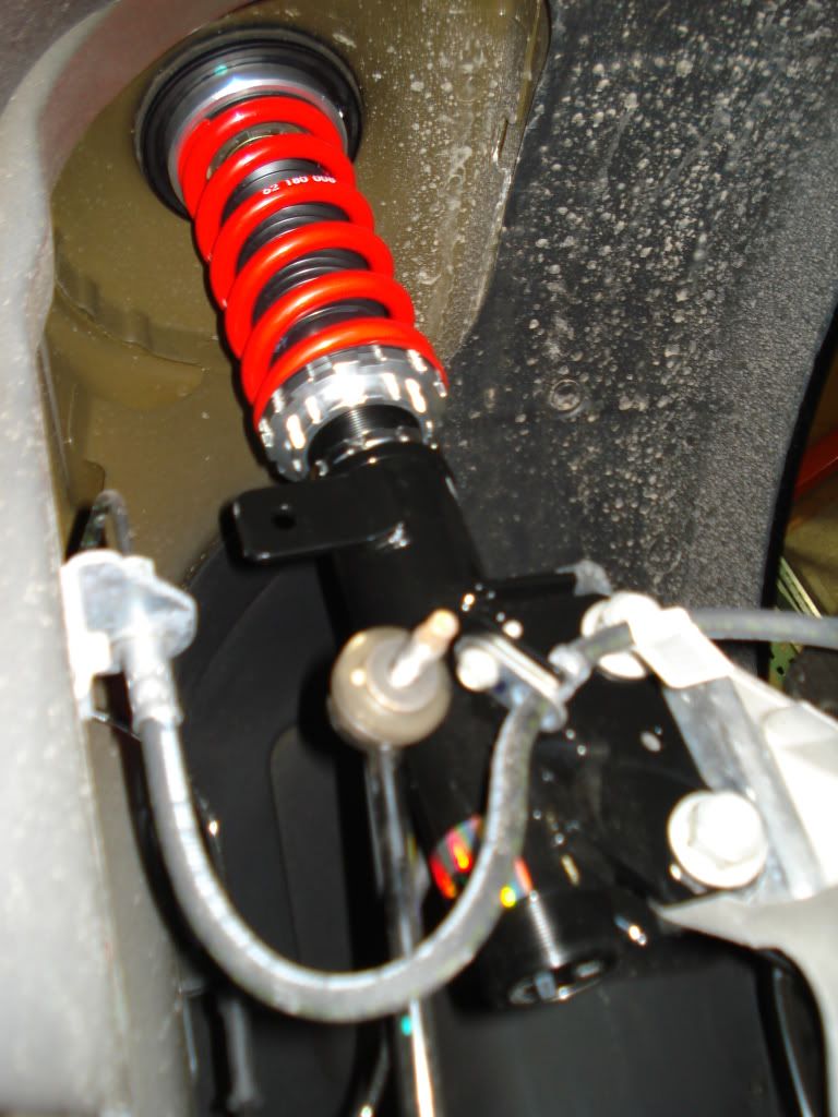

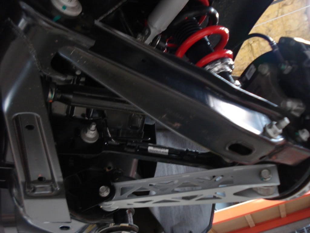

First things first... let's stiffen up that suspension, hang her down a little lower, and get the wheel hop, flex, and body roll under control. ( yeah, I know. I should have cleaned the wheel well before the pics )
Get her back on the ground and put on her new shoes.
Oooooh mama that looks sweet! Time to move on to the fun stuff...

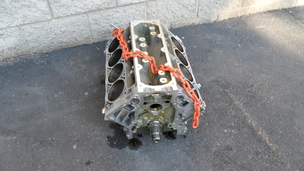

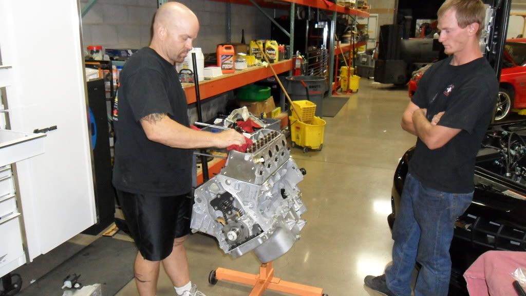

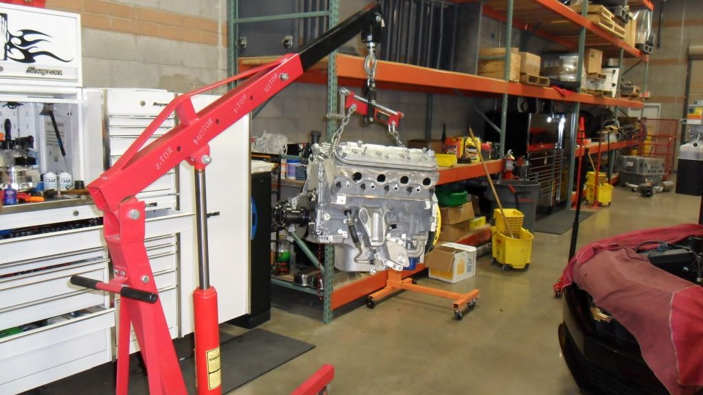

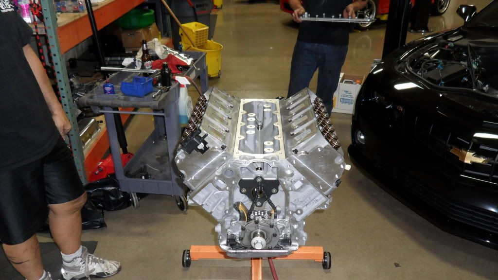

Yank the motor
And off to the machine shop just to make sure everthing is dead on. No sense in taking chances to save a few bucks.
Fast forward 3 weeks...
The stroke on this crank required some clearancing of the oil pan baffle. Time to make some sparks!!
Ah. Much better.

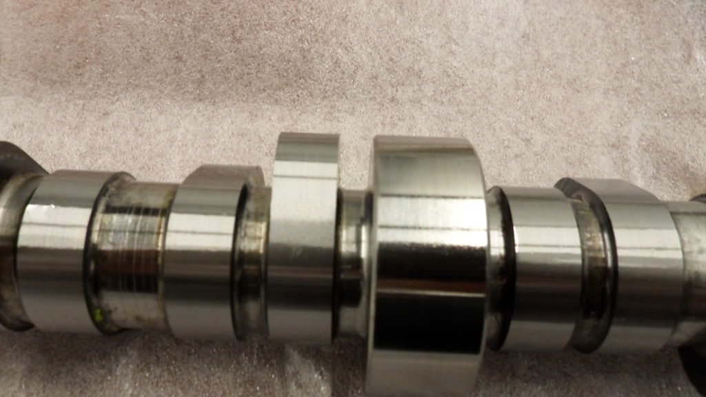

Let's slip the cam into this baby. Despite the fact that the lobes are darn near as big as the journals, she went in without putting up a fight.
Drop in the lifters

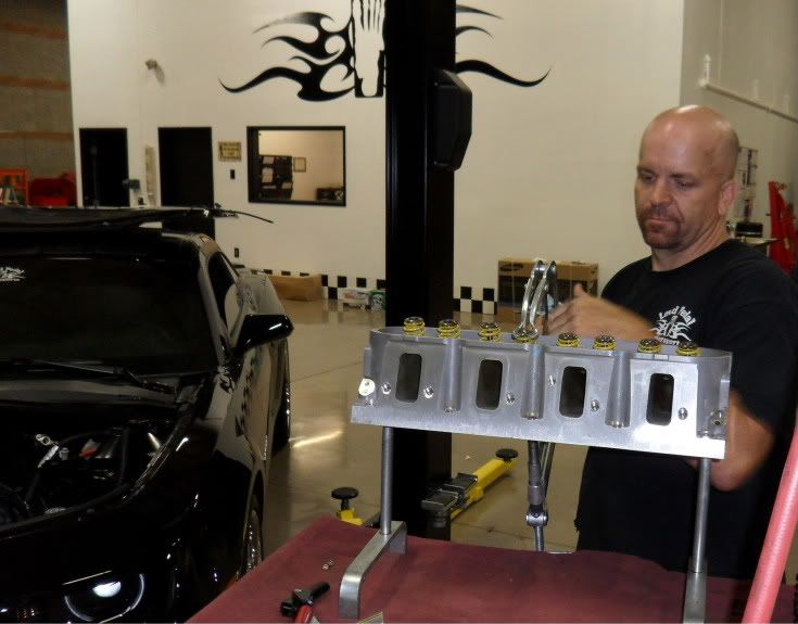

Now let's get working on the heads. With a cam this big you need some serious valve hardware. We went with triple walled chrome molley push rods and some seriously overkill valve springs. Check them out compared to the stockers.
Having the right tools makes all the difference on this job.
Wow, what a difference.

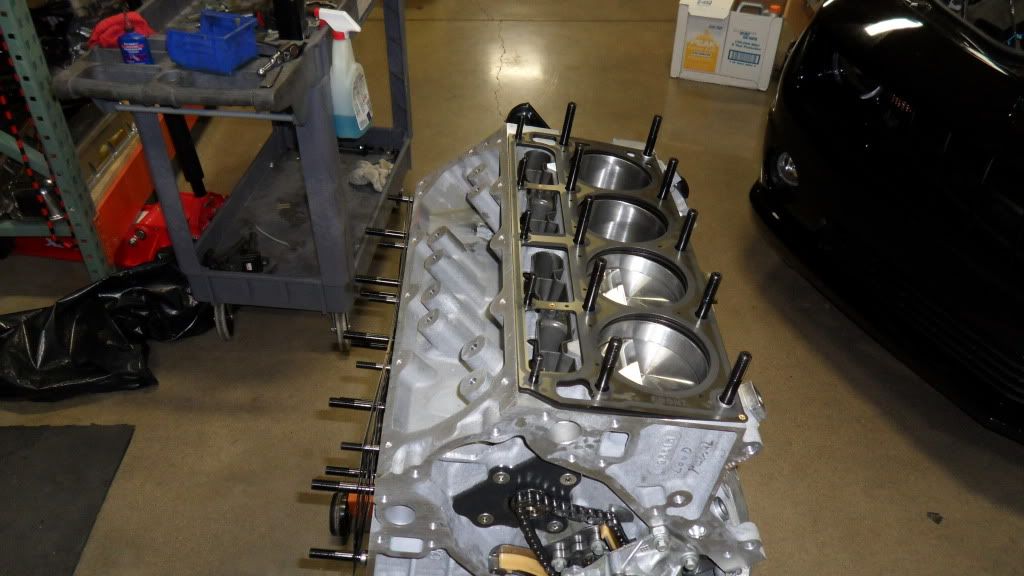

Running 14 lbs of boost demands quality studs. They look damn cool.

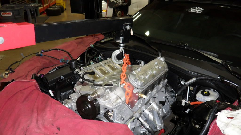

Pop the heads on and toque 'em down.
And we have our long block.

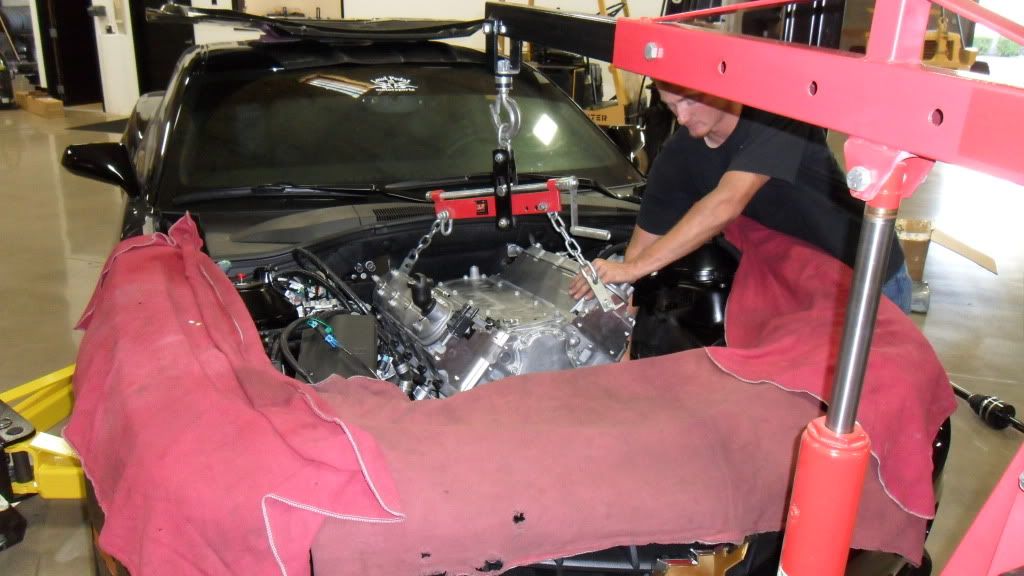

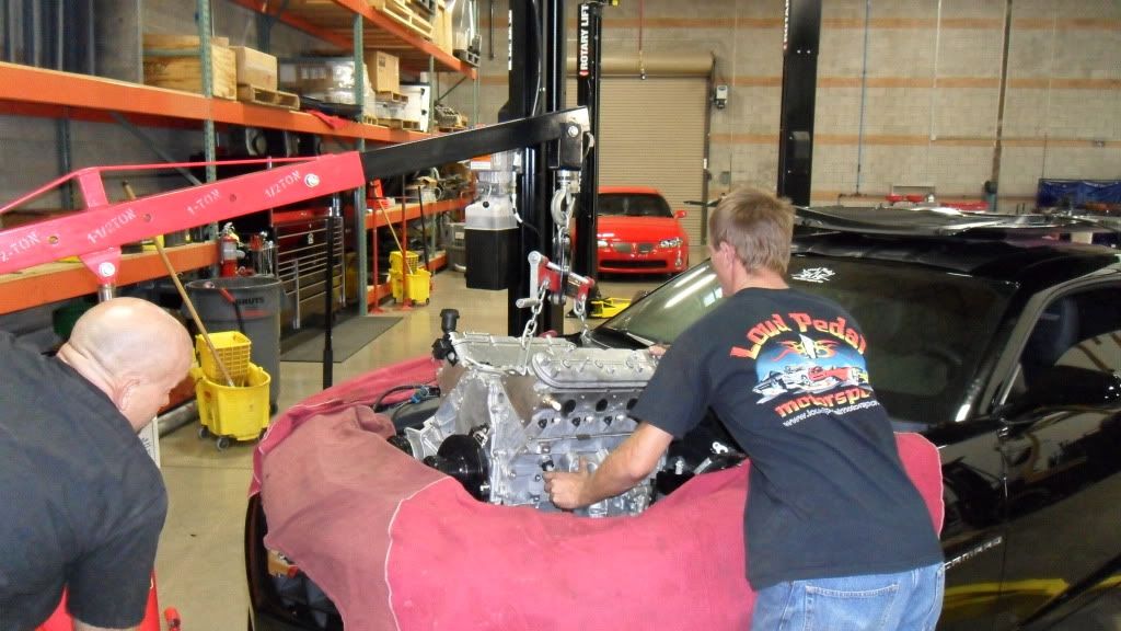

Install cam sprocket and put the lids on it.
Bolt on the Z-Grip clutch
Then its up...
in...
... and away.

The F1D is a more linear blower in comparison the the F1A. This car is going to spend a lot of time in the street, so low end torque was important to us and this baby delivers. Car runs amazing and is remarkably well behaved for running a cam that big.
How big is the cam? I know cubes will tame a big cam a bit, but those "looked" like some pretty serious lobes.
