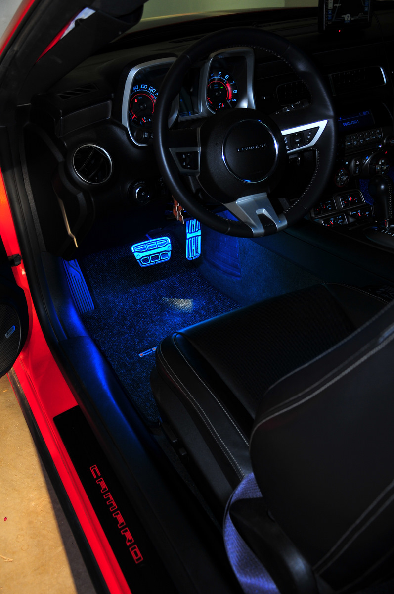

First up, I added Lloyd tru –berber mats on the floor and trunk, aqua footwell, dome, and trunk LED lighting and Drake Muscle pedals. Next, I added projector halos with HID and HID fogs off Ebay. I removed all badging, going back with the modern black GM “SS”s on both sides, on my new Heritage grille and on the trunk. Simple, but sweet!

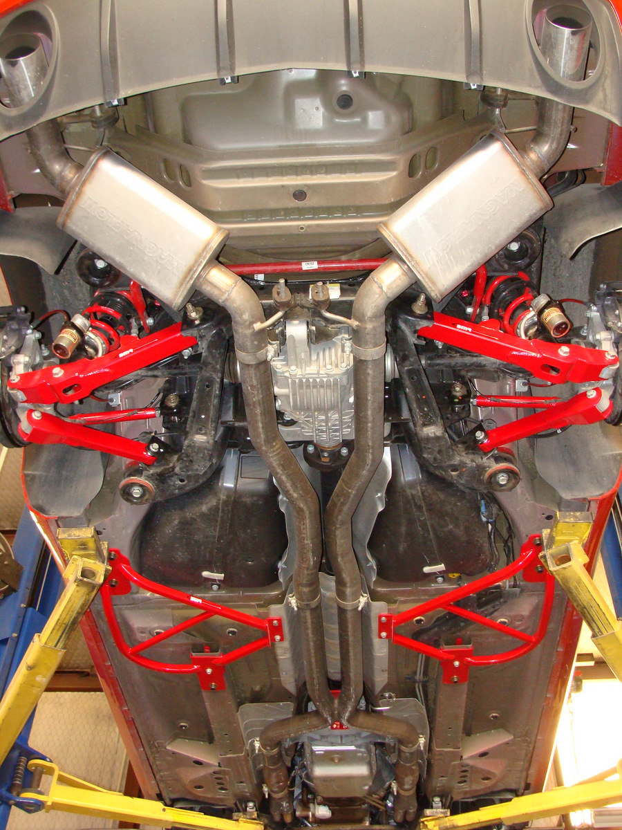

Performance enhancements were next and I decided to start with ride comfort and stability. I liked the lowered look, but not the less-than-stock ride of the Pfadts. Humberto Ortiz with Vulcan Specialties installed Pedders bushings and Supercar Coilovers to replace the Pfadt springs. We set the car about 1.25” lower than stock…very cool! The ride was awesome, but the dampening introduced some lean and body roll. Pedders sway bars and endlinks fixed that. Wow, that allowed me to smooth out my ride and the bars kept the car on the ground!
Next, Humberto installed a complete BMR package for strength and rigidity. Big change in the ride – no chassis flex and no wheel hop. I changed out the rotors with EBC slotted and drilled rotors and Hawk PC pads. They stopped nicely, dusted very little, but sqeaked like a little girl…gonna have to come back to brakes later.

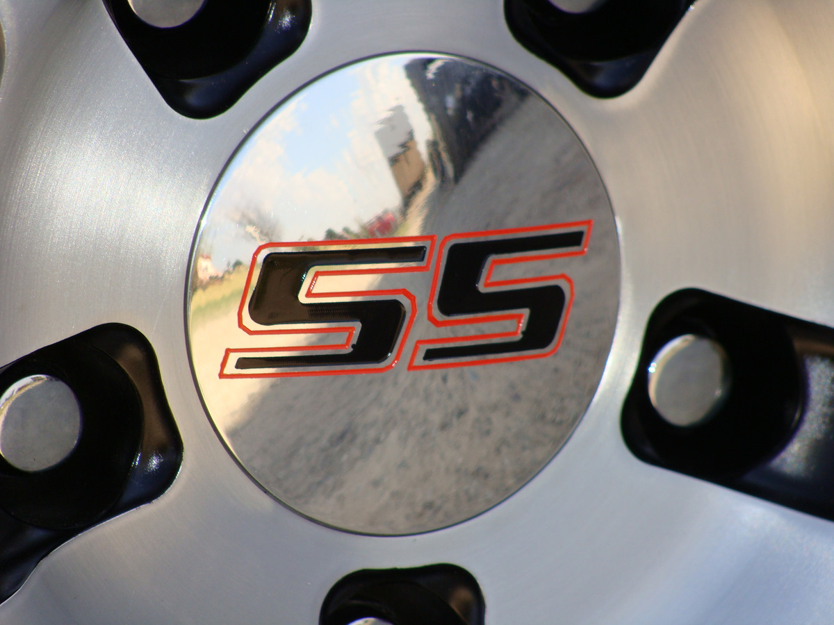

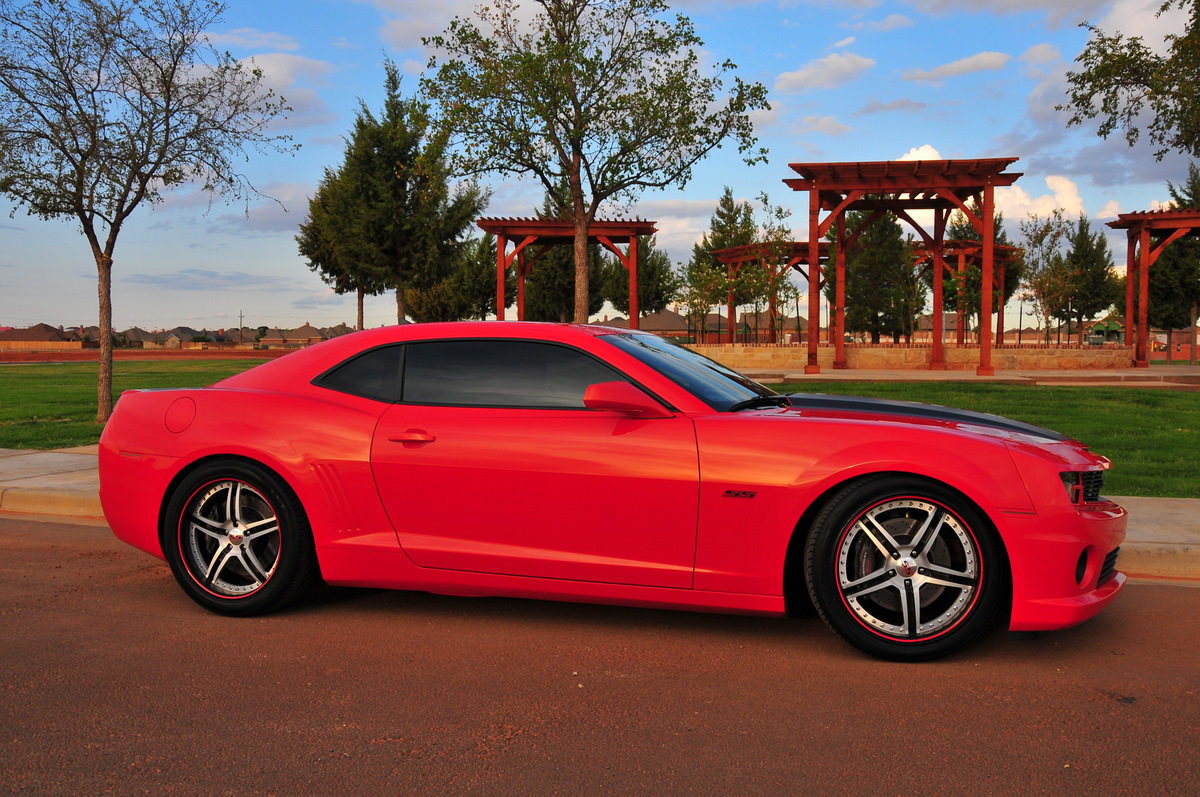

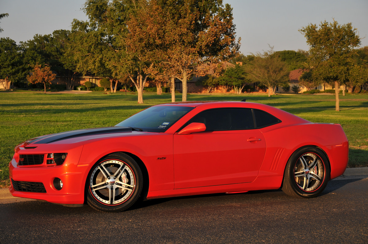

It was time for new wheels and tires! I chose Boze to build my custom three piece alloys. I went with Lateral Gs…a classic 5 spoke design…the only way to go on an American muscle car! Zak with Boze started with brushed center spokes, painted the lip black with an orange pinstripe, and finished with my custom “SS” center caps…they are truly one of a kind! We wrapped them around Vredstein Ultrac Sessantas – 275s up front and big, fat 315s on the back!

With that much horsepower, my buddies thought the half shafts were the weak spot, so I added Lingenfelter 1,400hp chromoly shafts and while it was in the shop, Humberto installed my new Brembo Gran Turismo big brakes front and back. Smooth, even, QUIET braking…amazing!

Modifications
Suspension
Pedders dual reservoir Supercar Coilovers
Pedders sub-frame and radius bushing poly inserts
Pedders eccentrics alignment bolts
Pedders 27mm adjustable sway bars
Pedders end links and rods
BMR red trailing arms
BMR red adjustable toe rods
BMR red chassis sub-connector
BMR red driveshaft safety loop
BMR red lower control arms
Lingenfelter 1,400 hp chromoly shafts
Hotchkis black strut tower brace
Cabin
Lloyd TruBerber Orange Camaro SS mats
Aqua footwell , dome and trunk lighting
Black billet orange “CAMARO” door sills
Drake Muscle billet pedals

Correct me if im wrong, I think your tires on facing the wrong way, those are directionals, and they are facing the rear, u may need to swap sides so the arrows face forward... If im wrong my bad, judging by the picture thats the way it looks, Beautiful car and wheels either way =) fix the direction it will handle better =)

I appreciate you noticing, but these tires are actually asymetrical, not directional. They are marked on the inside. Continuous groove goes to the inside...
