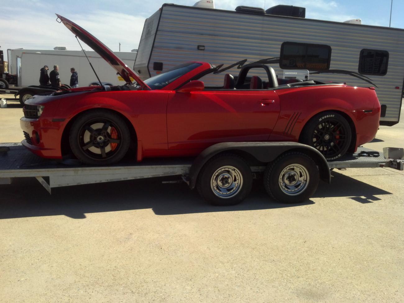

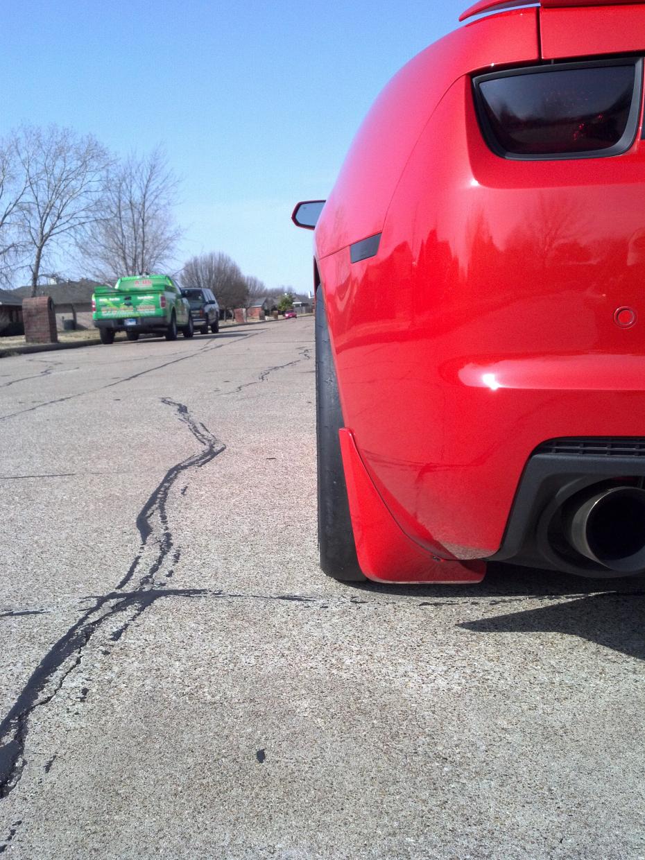

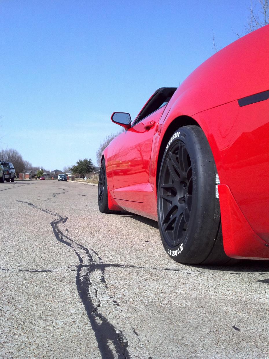

Swaped from 28" 315/40 18 Nitto NT05R to 25.5" 315/30 18 Hoosiers
1/25/12
Swapped my 315/40 18 Nitto NT05R drag radials for some 315/30 18 Hoosier drag radials. I'm of the opposite opinion of most of the people on this site when it comes to sticky tires. Most want to run a 305/45 18 tire that is almost 29" tall. I think our cars are too heavy and don't have enough gear to lug such a tall tire out of the hole and down the track. Even on my 28" NT05Rs, I felt, were too tall. I got a smoking deal on 25.4" Hoosier drag radials so i swapped out.
To put it in perspective going from a 305/45 18 to a 315/30 18 is the equivalent of going from stock 3.45 gears to 3.90 gears. Plus all the rotational mass you are getting rid of doesn't hurt.
1/4 mile tracks are closed right now but I will post results as soon as they open. This is the ONLY change I have done since my last trip to the track which resulted in 12.35 @ 112.9 w/ 1.89 60' (12.16 @ 114.7 corrected for +1,429 DA).

That's a good lookin tire. I love the look of the white lettering. Is that a DOT approved DR? What are you running up front?

If you get the tire to hook well, it should shave some time due to the increased gearing.
And you are correct about the wheel/tire setup being easier to spin down the track. The only issue might be traction with the lower profile tires (but those super sticky tires -basically slicks should get the job done).
Traditionally, you want more side wall (tire flex) when it comes to drag racing.
Ever since getting my converter (3200), my 20" drag radials 305/35/20 just don't cut it. My car makes too much torque leaving the line and just wants to light up the tires. I definitely need a tire with more sidewall. I'm thinking of dropping down to 305/45/18s to get more grip.
I should be pulling 1.6x sec 60' with my setup, but my tires just won't hold the track.
But I think your reason is valid. Your car should definitely run faster if you get a good hook. If you were running different tires (with less grip), you'd be in trouble.

Are you on NT555R or Mickey Thompsons? If you are on the Nittos that might be part of the problem. The NT555R are probably the only drag radial that has decent enough wear to daily drive but on the flip side it's also at the bottom of the list, performance wise, of all the drag radials.
Yes, I had considered getting some of the very expensive 305/35/20 MT but they don't work for daily driving.
If I was going to run MT, I would get a set of 18" wheels just for drag racing and swap wheels when I go to the track. But I'm very lazy and don't want to change wheels before and after going to the track.
Padre was also pulling 1.6x with his 305/45/18 NT555Rs (bolt ons). The 18" tires with the increased sidewall just have more grip vs 20" in the same tires.
I'm most likely going to drop down to 18" Nurburgrings to match my 20" and run the 305/35/18 NT555Rs out back.
I feel pretty confident I can get down in the 1.6x range with that setup. I think that will be about as good as it gets (60' time wise) for a full weight bolt ons L99 A6.
It would most likely take skinnies and 17" wheels to beat 1.6x sec 60' in an bolt ons L99.
But like I said, that's way too much work for me. I'm into driving to the track and then drivng home.

They hooked up a little too well!
http://www.camaro5.com/forums/showthread.php?t=205498
