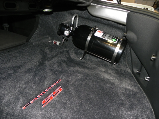

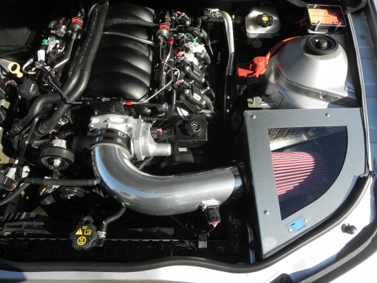

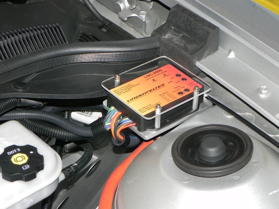

Got all the loose ends tied up last night and got to spray in the gears 1-3. CAI had went on over weekend.
Nitrous Outlet progressive system installed and using an LNC2000 to pull timing. Dave from N.O. was A+++ with providing info over the phone and through pm's.
Spent more time than it may look. I wanted a clean install without drilling any holes. The hose and all the wiring fit through the factory hole on the driver's side above the battery cable. I ran wiring in existing wire looms as much as possibe. Made a false floor in the trunk, securing it with home made toggle bolts.
Name:  Bottle in trunk.JPG
