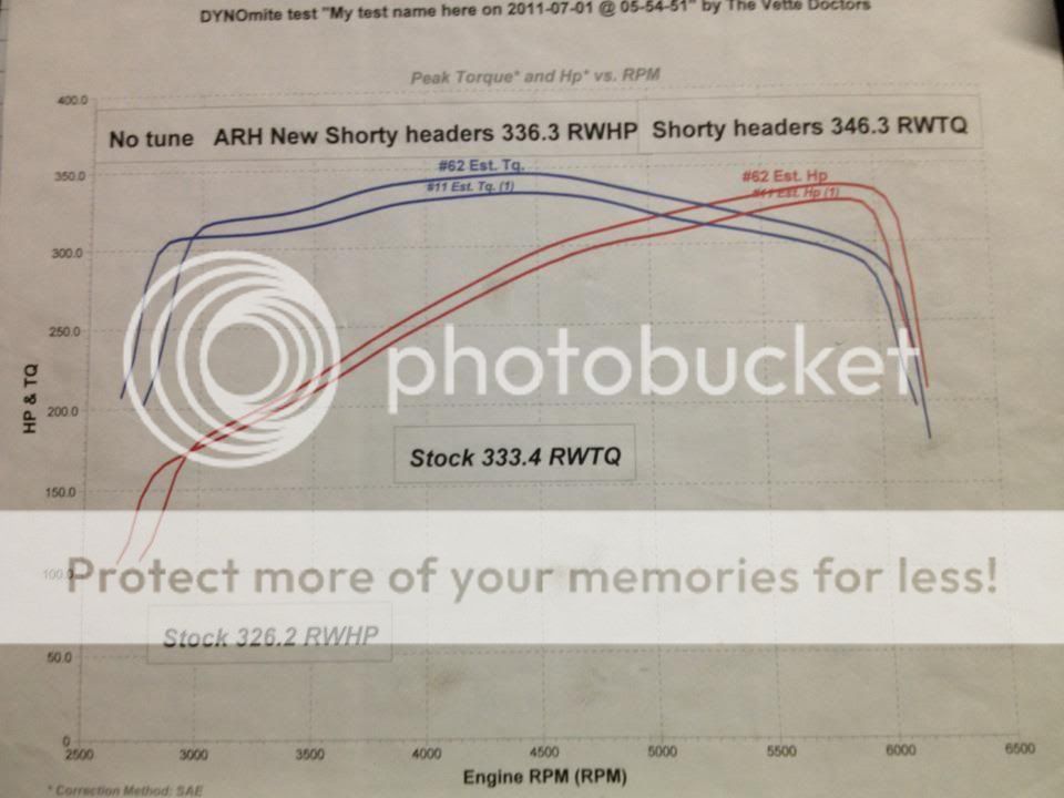

Hey everyone, Let me start out by saying as some of you may remember, I posted previously that I had a ZL1 on order which I had to cancel. Anyway since I canceled the order I got the itch to do some mods to the car I was planning to trade in, my 2012 L99 SS. My first thought was my dealer is really not to keen on mods but will tolerate some as long as it is not too over the top. At this point I only have a cold air intake. I remembered reading that American Racing Headers had developed a shortie header that they claimed to be 50 State Legal and from the looks of it, had some pretty neat features. I did some investigating and found out that they were approved by CARB or ARB. Apparently from what I could decipher the American Racing Headers passed the strict CA emission laws with flying colors.
After talking to Nick, the owner of America Racing Headers, I made an appointment to have the Shorties done. The install was fast and neat. Everything bolted up and cleared nicely. I really liked the ARH wire insulators. They dressed up the engine compartment nicely. As soon as they fired up the car I could tell right away the sound was throatier than the stock exhaust manifolds. The throttle response seemed quicker. At the time I really couldn’t get on the car due to heavy rain. On my drive home, about 35 miles, my highway mileage seemed to be about the same as before, around 25.8 mpg.
As I got closer to home I encountered some dry highway roads where I went WOT and I immediately knew it felt stronger than stock. The real test didn’t come till this morning where for the first time, with traction control off, it lit the tires from a standing start like never before. And it did multiple times. I didn’t dyno the shorties but the gains have to be pretty substantial. Overall I’m impressed with American Racing’s shorty headers. It was a mod worth doing, especially since I don’t want hassles. Next up, I’m saving for the ARH full catback. I can’t wait to get their X-pipe installed and I’ve heard their mufflers on other Gen 5’s. I’ll keep you all updated with sound clips and my experience with the system. Thanks.

Nice write up! ARH is the real deal...if you plan on going with shorties they should be your first choice. Any thoughts of adding some high flow cats? At this point they would be your most restrictive point in your exhaust.
+1 for high flow cats. Forget the expensive catback. If I had it to do all over again I would have left the stock catback on until I had the cam changed. Some new high flow cats are going to sound better than most catbacks anyway. If you want more sound might as well have more power too with the addition of high flow cats.
Really wish AHR did a before and after dyno but I am sure they gained the 10RWHP that is claimed. If I had to get shorties this would be the ONLY one I would get.

Thanks for the write up! I have a set of these same shorties sitting in the box ready to install... I am glad to hear someone felt and heard a difference for the better. There are so many shorty haters and no one seems to want to dyno the results of these popular ARH shorties either!
Done at the Vette Doctors a before and after on a BONE stock L99 car. The shorties proved 10hp and 13ft/trq. There is no tune done in the car either.
Lou, I should have said that I've never seen or heard of more than that particular Dyno chart... but thank you, and mine look awesome.

Vader, I'd bet dollars to donuts our cat back will produce at least 10 additional HP by adding our 3" X-Pipe. Yes high flow cats make a difference but it sort of defeats the purpose of installing the shorties to remain 50 States legal. This is especially true for California Gen 5 owners.
Hehe.... that's not the 15+ that you can get out of the probably cheaper HF cat midpipes though! OP isn't from Cali either... not that I know what the NJ laws are.
I would like to know how a 3" cat back is going to free up 10hp behind these restrictive cats on a basically stock car. Look at these pictures. The inlet is barely 2" and is a serious bottle neck. Add that to the restrictive properties inside the cats and its easy to see why they rob power. I can believe that your cat back would free up 10RWHP on a cammed or supercharged car that already has LT headers with 3" collectors but I dont see how its possible on a basically stock car that has a 2" bottleneck in front of the cat back.

I agree to adding SOLO HF cats before doing a cat-back.
Obviously ARH is going to push for the cat-back because he wants you to buy his product. My guess is he'll tell you no other cat-back will make that kind of power but his will. I also bet if he made some HF cats he would recommend them first for performance.
10 hp from a cat-back??? I highly doubt that. That's my opinion though. I would have to see some independent testing before I would believe that one.
I'm not disagreeing with getting a cat-back but IMO it's going to be all for sound. That is a viable reason to get it alone. However, if you're looking for cost/performance bang for your buck go with the HF cats. It will change the sound of your car as well.
