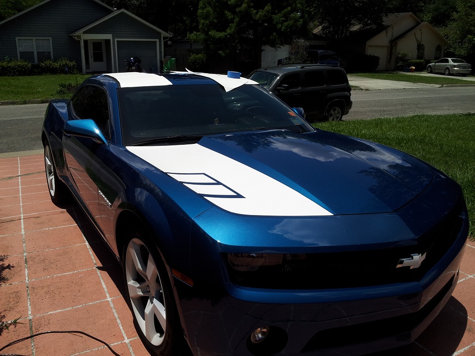

Now we get to the fun stuff. The vinyl is in between the transfer tape (top) and backing (the back). I started off with the hood. Place the hood stripe where you want to position it. I tried to line it up with the cowl.
Three things of note here:
1) MOST IMPORTANT! WHEN YOU GET READY TO TAKE THE TRANSFER TAPE (TOP LAYER) OFF, START ON THE PARTS OF THE VINYL THAT WILL OVERLAP OVER THE HOOD. IF YOU START ON THE SIDE OF THE COWL, YOU WILL DISTORT THE IMAGE OF THE STRIPES!!!! THAT PERFECTLY DESIGNED EDGE WON'T BE PERFECT ANYMORE
2) There should be about a 1/4th inch of vinyl overhanging anywhere the stripe will go under the hood. This means around the windshield, fender, and bumper, but not the middle of the hood where you line it up with the cowl.
3) You can see where the vinyl will lay down through the transfer tape, don't think that the vinyl is as big as the transfer tape, otherwise you will misjudge.

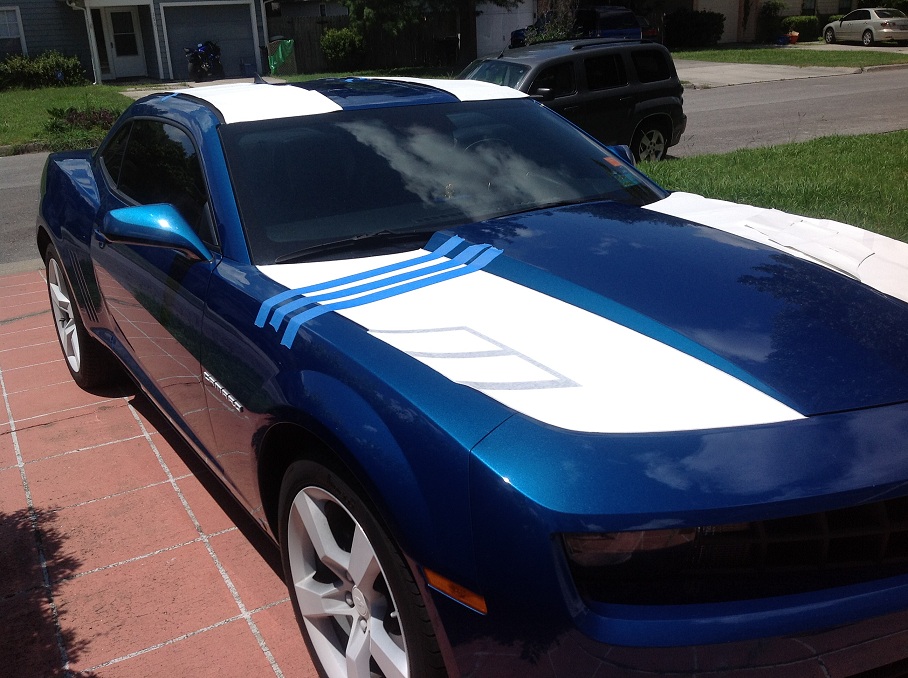

I taped across the middle. After you have lined it up, HOLD it down, and put some tape across it. I used several large pieces of tape.
VERY IMPORTANT: AFTER YOU TAPE, TAKE A LOOK AT THE STRIPE FROM ALL ANGLES. MAKE SURE YOUR STRIPE HAS NOT MOVED WHILE TAPING, THIS HAPPENED TO ME AND SCREWED ME OVER.
Once you have gotten here, it gets a little harder. I did top down, but you can do down to top also, doesn't matter. Let's go with top down. Pull the stripe closer to the windshield up, and peel off the backing to where you taped to. Use scissors or a razor to cut the backing. Backing should still be there on the majority of the stripe.
Use a squeegee (I used a credit card) and start laying the stripe from the middle to the top towards the windshield. The stripe is real sticky, but you can lift it back off the paint if you need to. Try to get any air bubbles out and push moderately hard down while lying the stripe down.
You should reach the edges, and have about a 1/4th of an inch overhanging the hood. We will deal with that later.
Take off your tape, and place it over the part of the vinyl you have already layed down on the paint for extra protection.

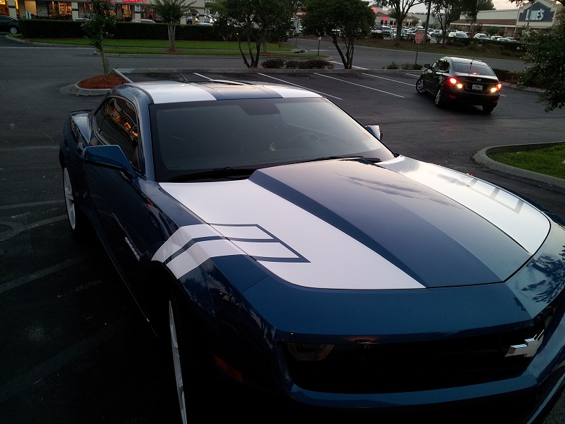

Now you can do the rest of the vinyl stripe in installments (just cut the backing a foot or so at a time) or just take off the entire rest of the backing and lay the whole stripe down. I recommend the former option, just in case any mistakes happen.
Now you have to pull the transfer tape off. The transfer tape will actually pull on the vinyl and many times it will pull it off the paint. If you pull the transfer tape off around where the stripe is lined up with the cowl, that pulling will actually distort the image. So pull the transfer tape off wherever you know that the stripe is going over and under the hood. This will allow you to pull the transfer tape and not have any distortion in the final image. This is how you MUST do it for every piece. If you do not, you will not get those perfect lines.

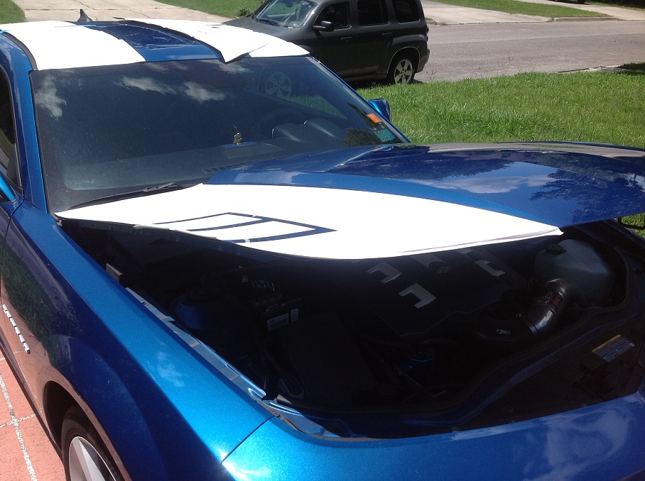

Now we can deal with the overhanging vinyl. Pop your hood.
I used this heat gun http://www.amazon.com/Wagner-Power-P...words=heat+gun.
Heat about 5 to 6 inches at a time on the low setting. 3 to 5 seconds on low is just right to get the vinyl to do what you want.
Start creasing the vinyl over the hood and under. This is the easiest way to deal with the overhanging and still get a perfect look. If you want to trim the vinyl, you can, just do so carefully. I recommend not trimming it.
If you get anywhere where the vinyl is being troublesome (making air bubbles and such) give it a little heat and it will play a lot more nicely.
Go all the way around the hood. When you get to the windshield, go from the edge towards the center when putting the vinyl under. If you go from the center to the edge, you will get a crease at the edge. I got that crease, and I ended up using a razor to cut it so it would sit without the crease.
And voila, you have the first part of the stripe kit down!

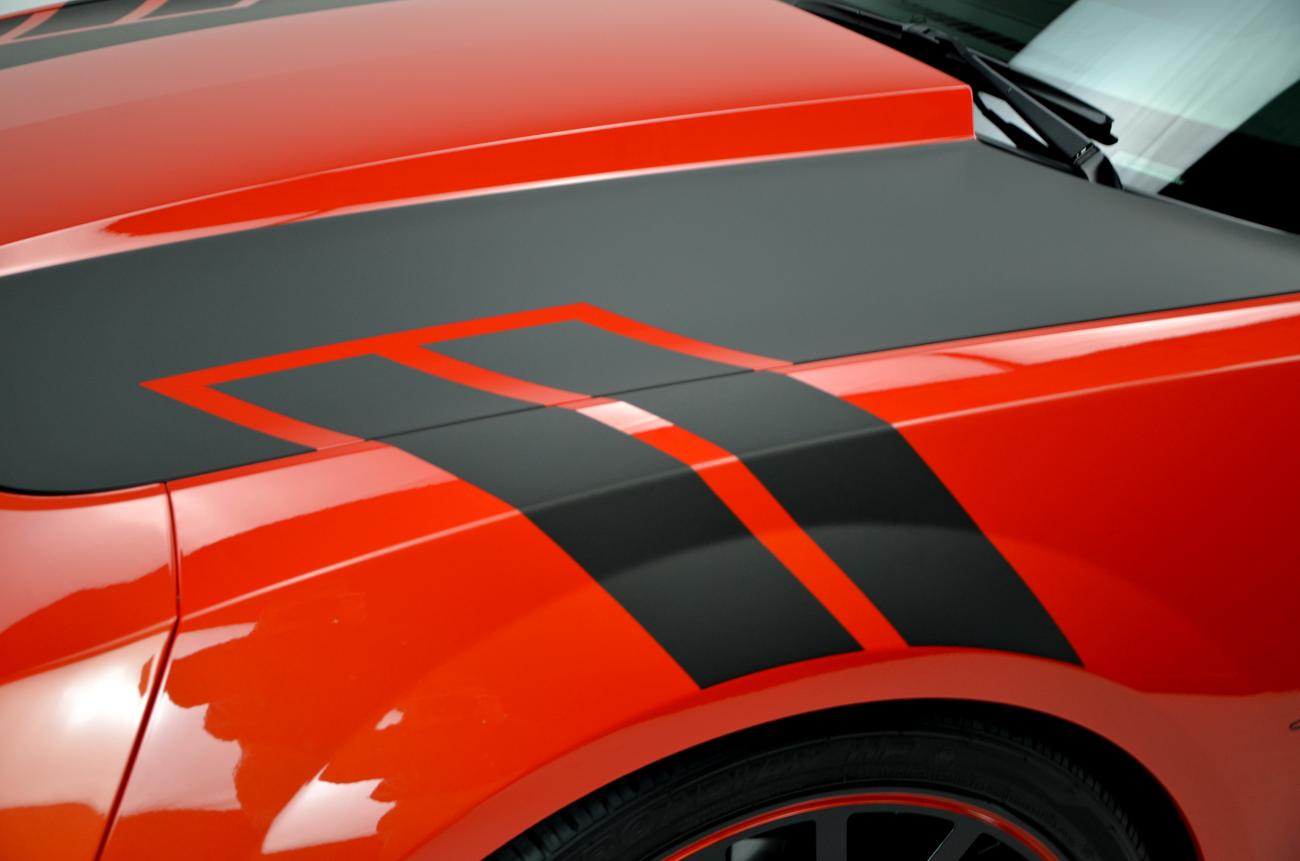

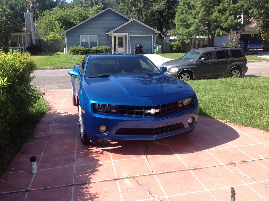

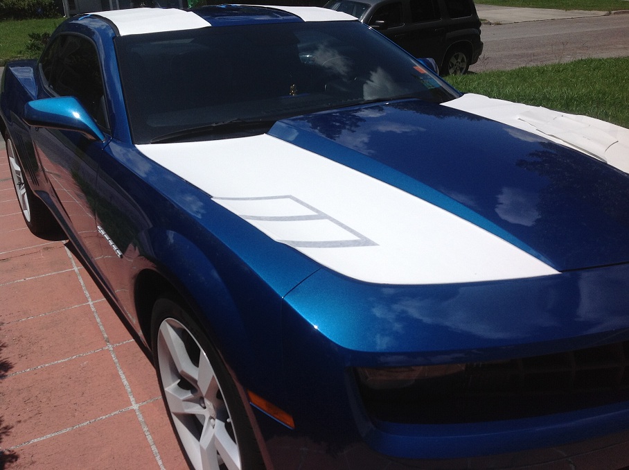

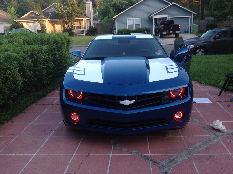

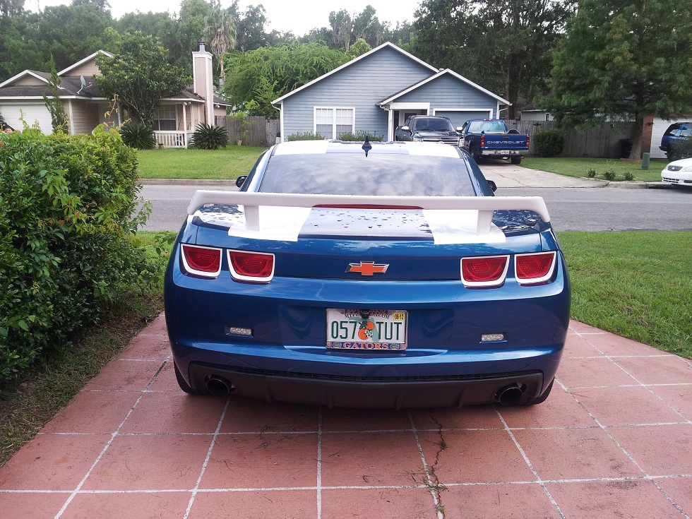

By now you should be done and it's time to post some pictures!!!
Name:  Pic 1 resized.jpg

I think I have managed to pretty much get the hash marks as perfect as I could. Would you like me to take a picture of how they lined up?
At the risk of bragging, I think I did a pretty good job there
It should look like this:
