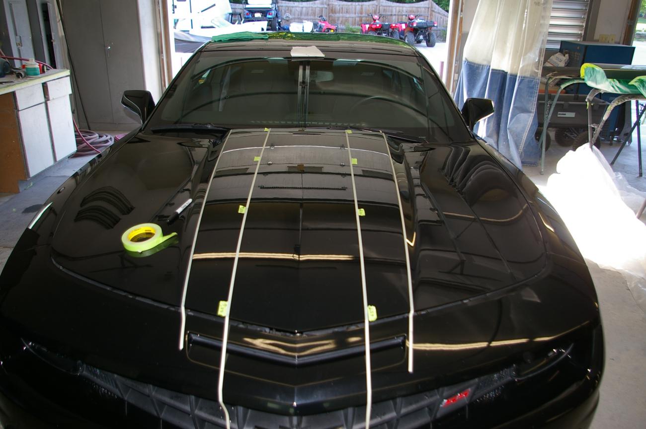

Stripes
Stripes going on today. Crappy paint rendering attached, they will continue on the trunk lid and over the spoiler. Car is black stripes will be flat black.
Hope to pick up by the end of the week!

Stripes Update
Here are the first pics of the stripes going on!

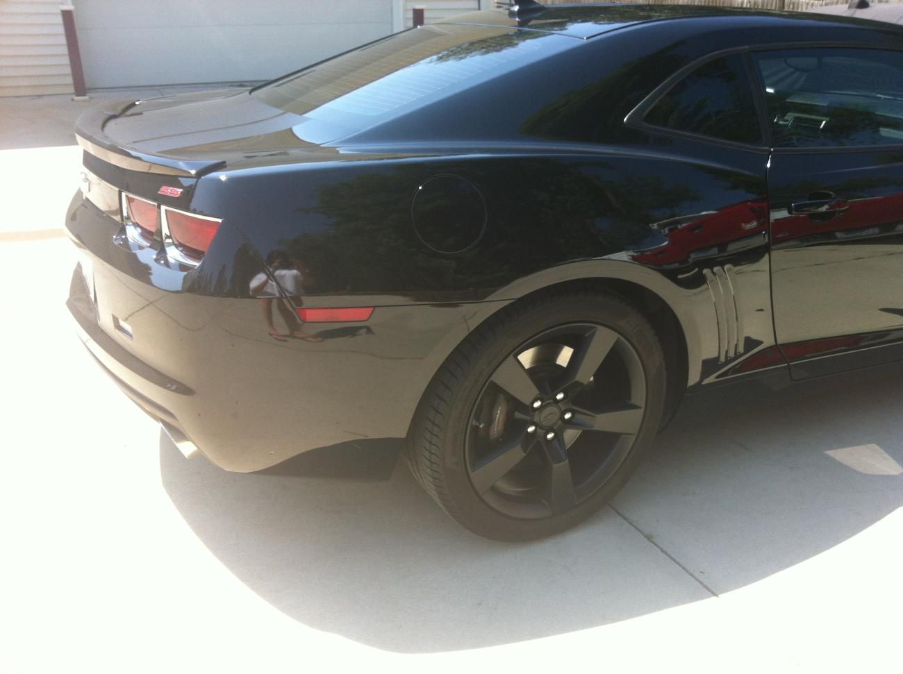

Wheel and back stripe pics:

Finaly got to wash her.
Out of tire black. Pics do not do the stripes and wheels justice.
Should be pushing ~450 to the rear wheels. The new stance, about 1.5 inches lower is very aggressive. Steering seems to also be greatly improved, have not have much time to push it yet! :(
I can't recommend Kyle, NC-V, Jimmy and the entire staff at http://www.streetcustomandpaint.com/ enough. If you are in NC you need to look them up.
