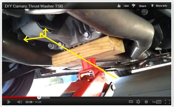

If you don't want to use the diff it's self then you can use the mount.
Attachment 417836
I used to do this, but avoid lifting by the diff completely now. That single rear diff bushing takes a beating on high HP builds. Totally blew out both the Pfadt and HD Pedders bushings, now on Delrin Pedders and that mount bolt has to be kept extremely tight to keep from moving up/down. Even with an oversized 12.9 bolt I thought was tight, I had movement that sounded like CVs going bad, but the washer slide pattern showed it only moved about 1/8th inch. 80 ft lbs tightening, paint marker to verify no movement, and it's all good again for now.
Doesn't it lift on the mount without touching the diff in any way? With a block of wood? I can't remember. I'll certainly make sure to keep an eye on mine.

PQ, I have a manual SS with no sound at the wheels, if I develope this problem I'll know how to repair it...thanks for the video.
